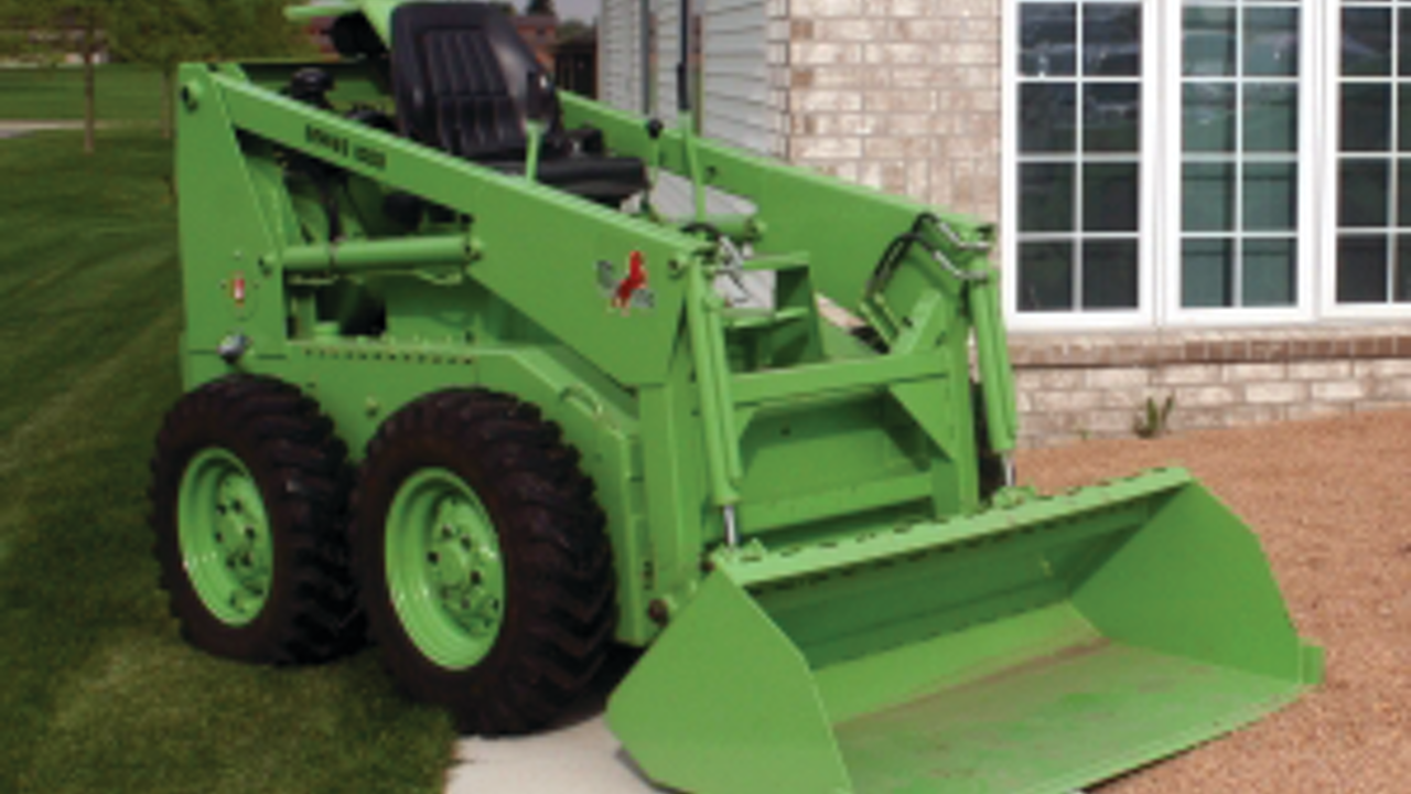

Hello All,
I have one of the original 25 1965 Owatonna Mustang Series 1000 tractors with a Wisconsin engine. The tractor is seldom used but is always stored under cover. Every year when I change the oil it is always milky. I'm assuming it is from condensation inside the engine. Just wondering if others have had the problem and if anyone has a cure.
Thank you,
Bill
