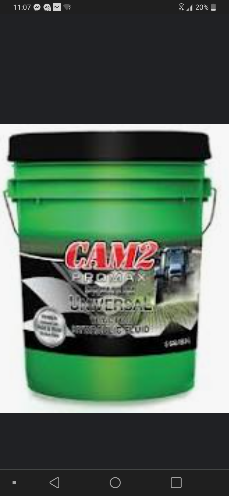

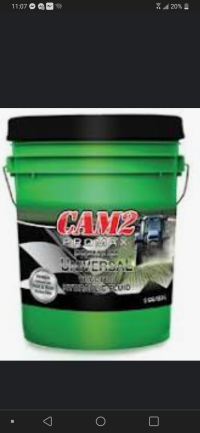

Universal hydraulic oil is 10w-30 and has addditives. Rural King has it for only $50 for 5 gallons.Getting ready to swap out the unknown hydraulic fluid in my 743b for 10w30 oil. Current fluid appears greenish-clear. Questions...Planning to pump out the reservoir, swap the old filter for a new one (prime the new one with fluid first) and then refill the reservoir with 10w30. Is there anything else, or can I safely ignore what old fluid remains?? I am thinking I will use generic NAPA 10w30 oil on this fill, then do an early fluid and filter change, this time perhaps with Rotella T4 10w30. That should workout most of my current mystery hydraulic fluid. Thoughts on this? is there a better strategy? Thanks in advance.
