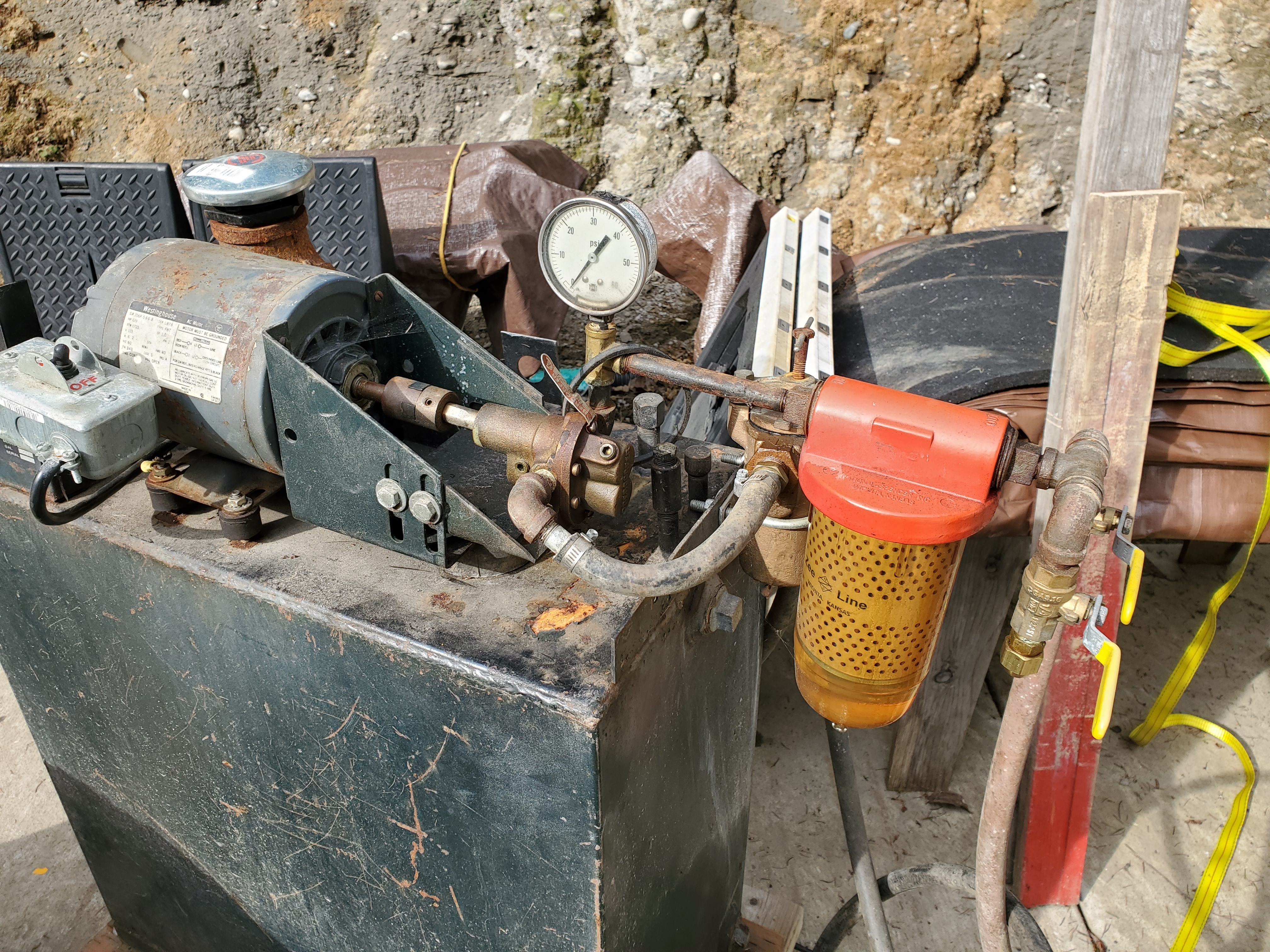

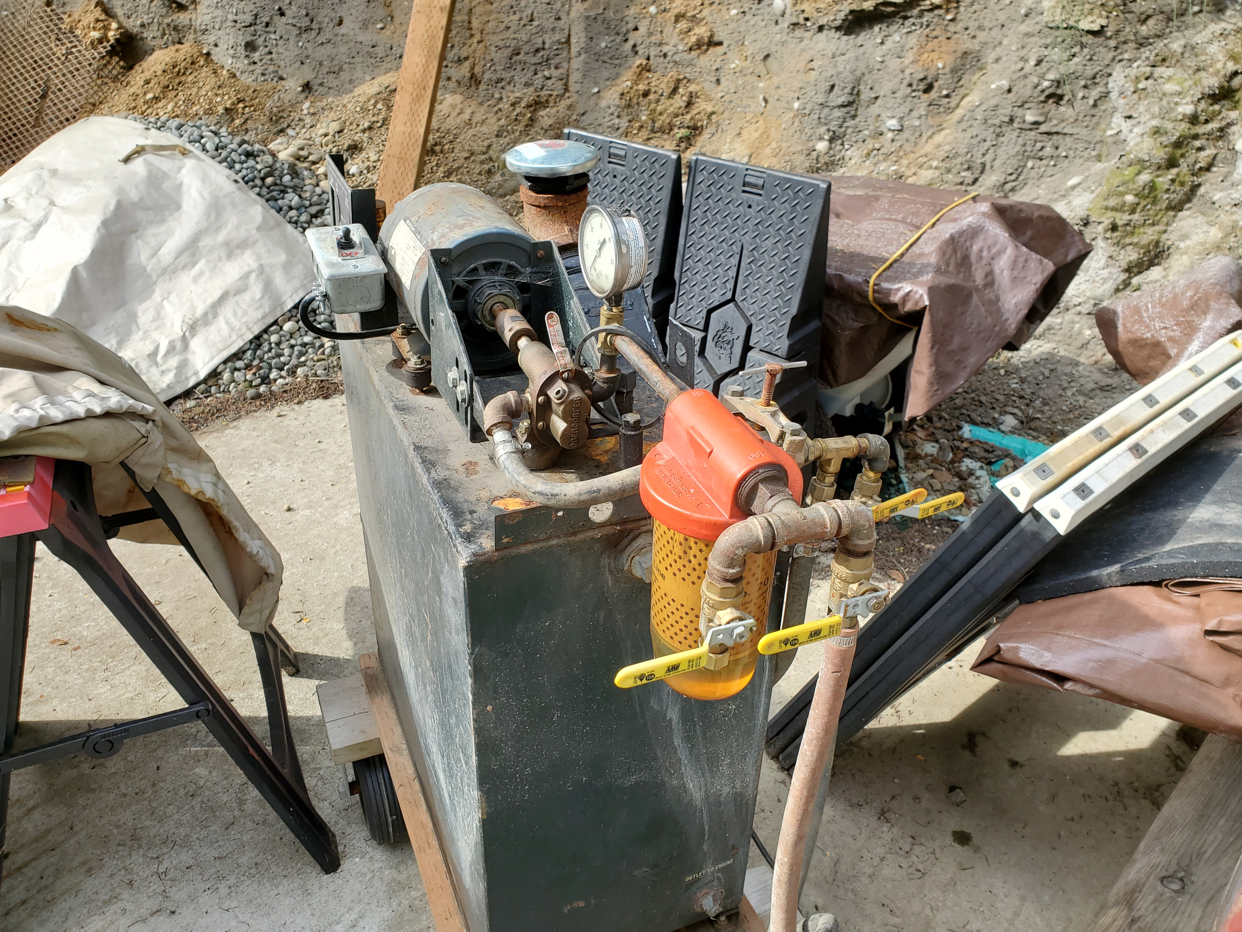

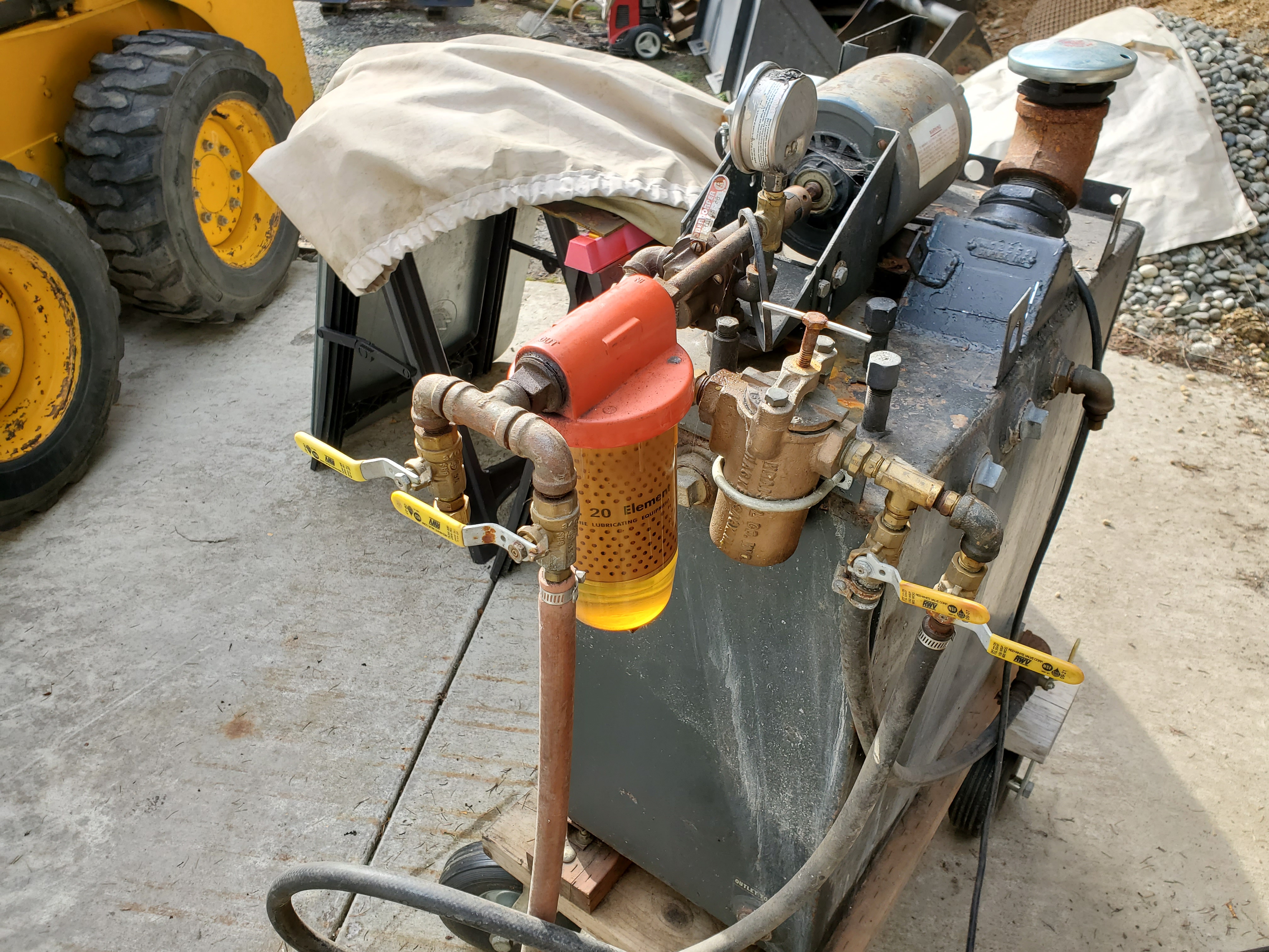

Here's my system. I can suck from anywhere and pump to anywhere. It's currently set up for transferring fuel because I had fuel tank issues.

Thanks for the pictures. That is a nice set up. Do you use the same type of filter for oil? I have those on my fuel barrels. Also what is the brass housing with the clamp lid? Is there another cartridge filter in there?
Yes, I forgot to mention it.
That is a very fine (about 200µ) cleanable bronze strainer. It will trap diesel bug sludge and metal particles before the filter. It isn't a very sophisticated setup like a polisher, but it cleans the hydraulic oil good enough for chain case service, imho.
