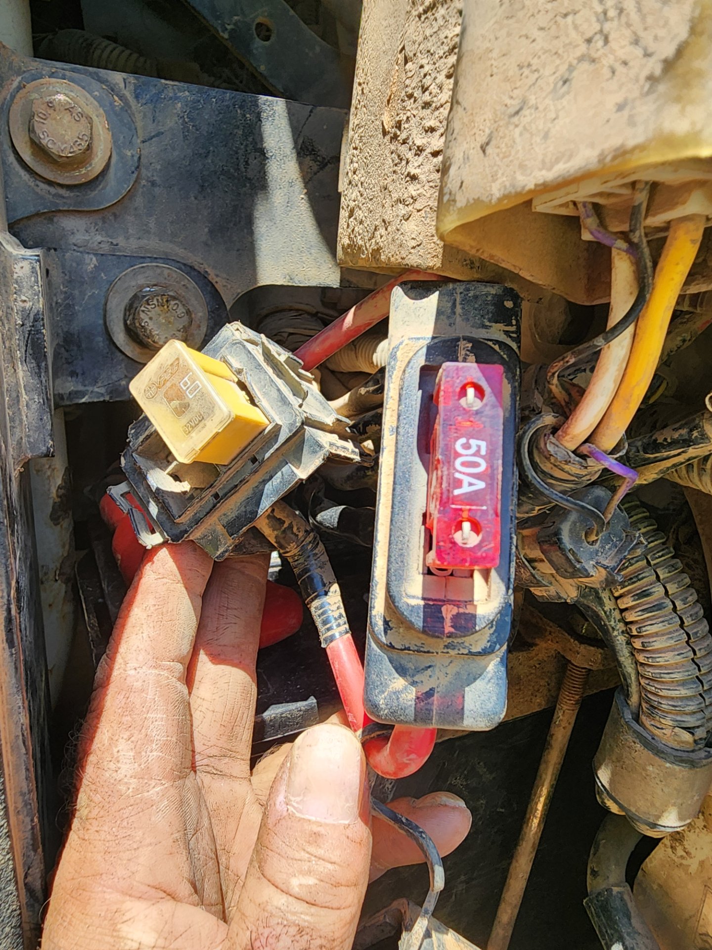

Is this cut off by chance.
    543.3 KB
Is this rhe battery cutoff switch by chance.
    543.3 KB
There is no factory cut off switch unless someone installed one. I would suggest looking at the key switch. Make sure you are getting power out of the switch.
Is that 50amp fuse good? And that yellow thing looks like a push in breaker type of thing does that reset or is that a relay of some type?
