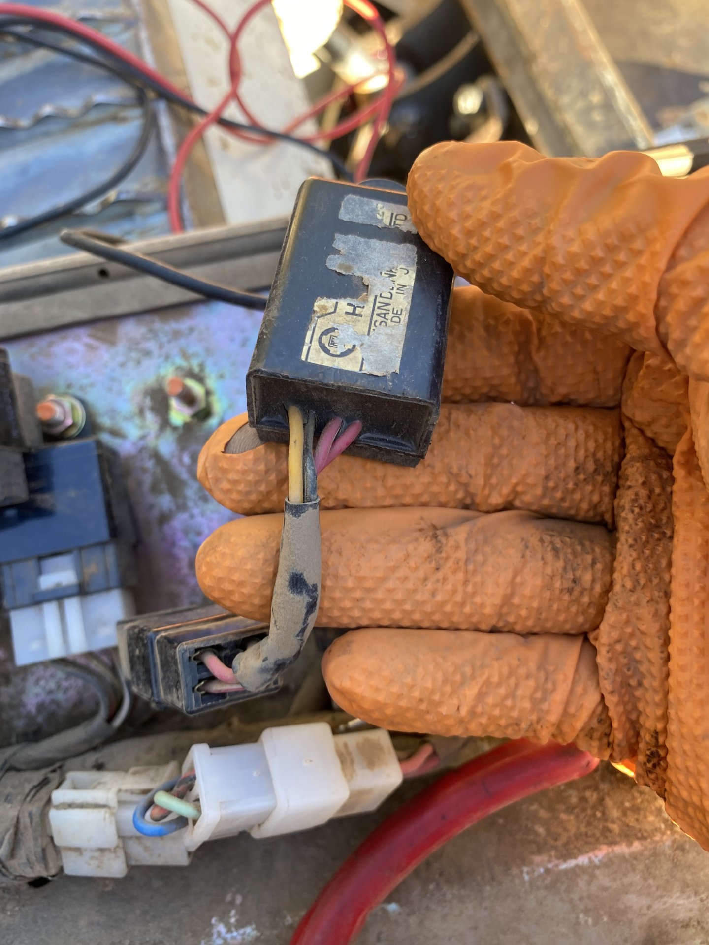

Hey all,
I’ve spent some time combing thru the forums and have found a few similar situations but I may have a weird one-off issue here….
Critters got in the machine over the years and got to some wires. I’ve repaired 5 thus far mostly under the console on right joystick side.
I lost all gauges and the circuit board was shot. So I got a new console and that fixed all the gauges that weren’t working! Score one for the home team.
Before this repair however the battery light would blink AND audibly alarm.
After this repair, the audible alarm is gone but it still blinks….
I’m at my whits end. The relays are good, fuses are good and the alternator shows to be charging appropriately. Machine also has a new group 31 battery…
The machine runs like a top! Fires right up and kicks butt. It’s got 1600 hours on it. I want to make sure I won’t burn anything up operating it with a battery light goin on.
Any help is greatly appreciated
