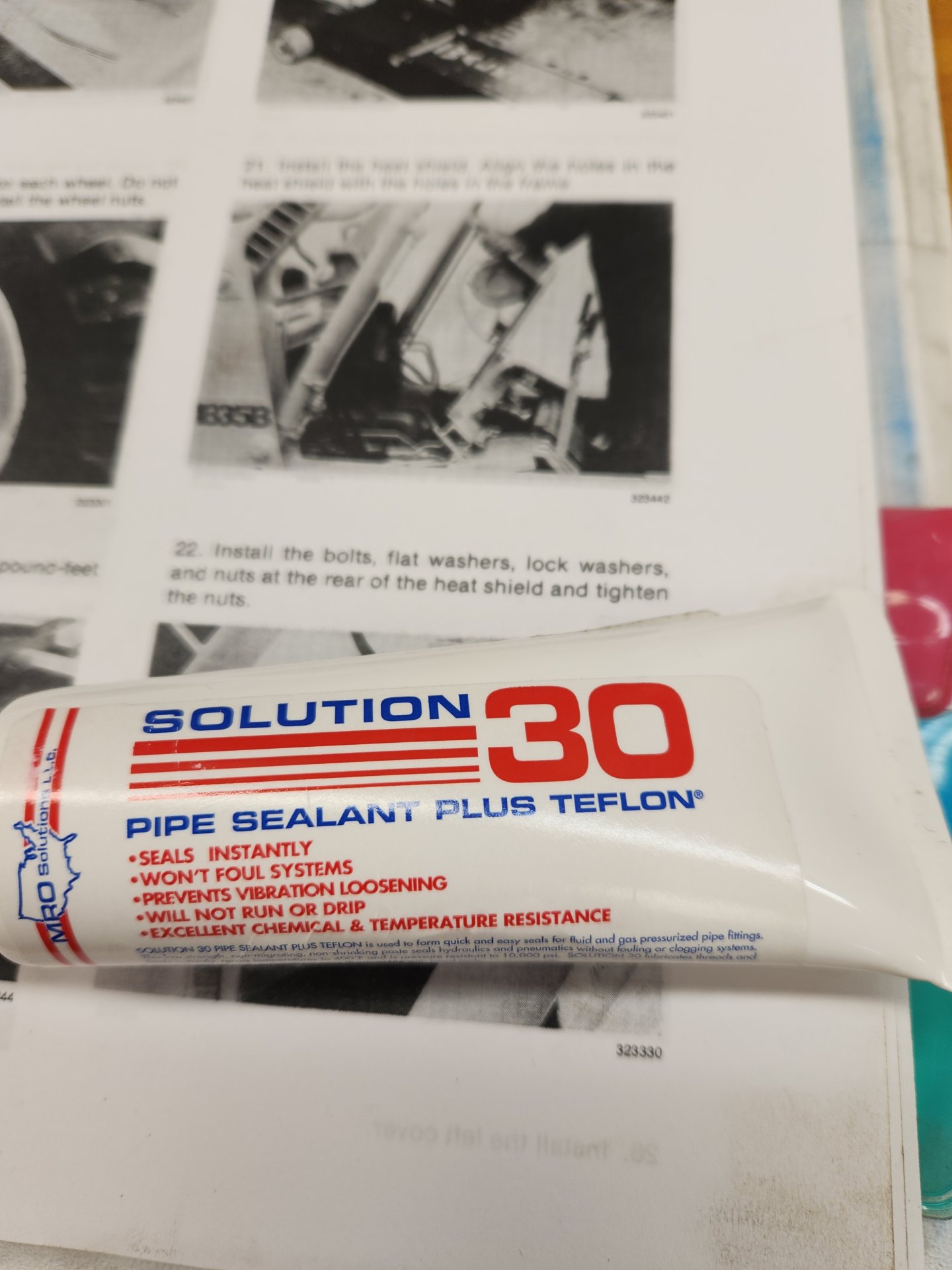

Local hydraulic repair shop recommended this
