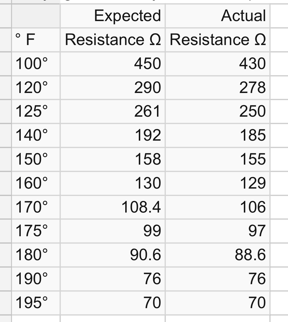

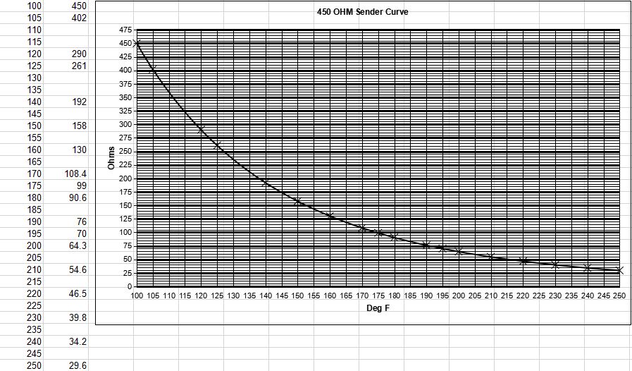

Ignore the above table. It was correct for the part I received, but not in spec for the gauge. That's what can happen when I buy parts from Amazon.

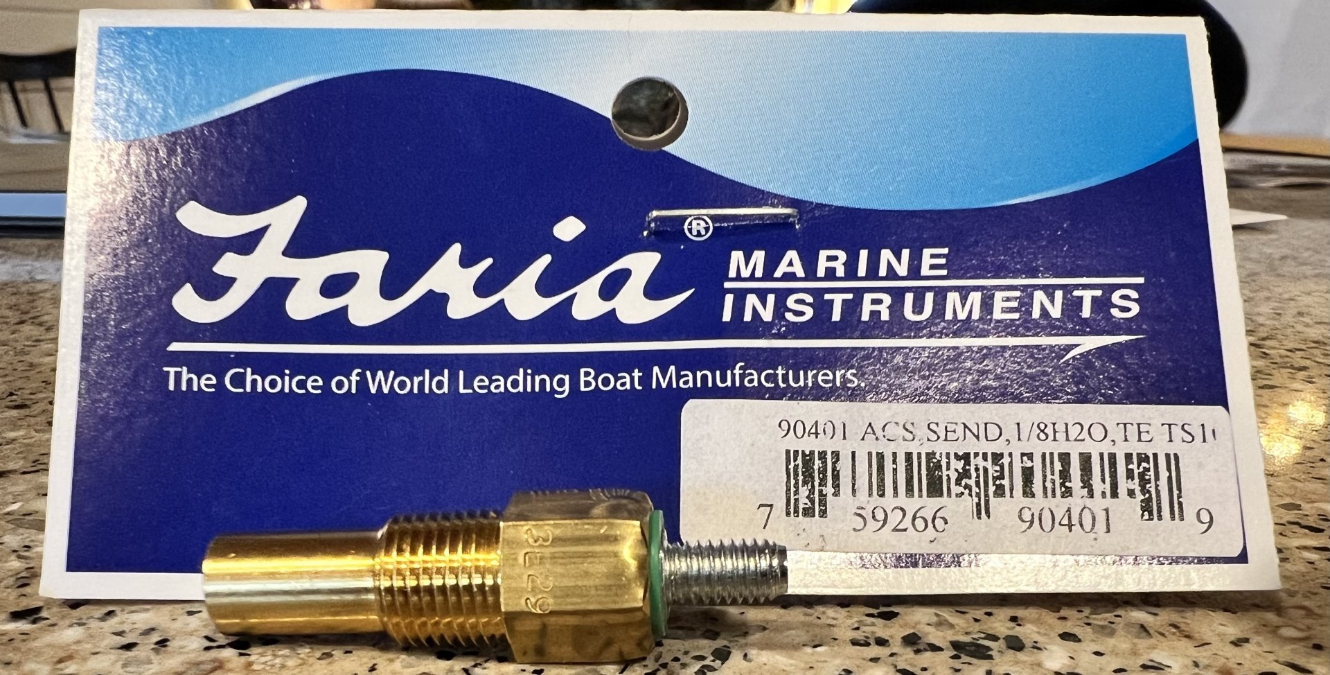

I ordered an actual Faria sender (who makes the gauges for Bobcat) and their part number is 90401. It was spot on for ~190°F operating range which is where I expect my Isuzu diesel to spend most of its time.
