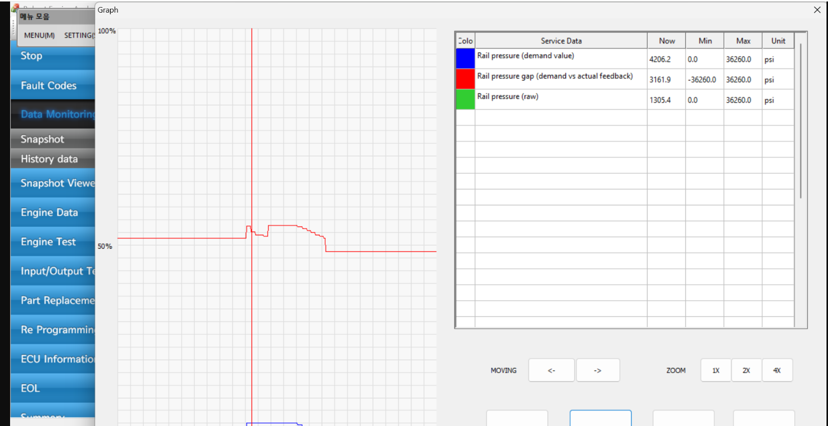

When the unit was dropped off we explained how fuel was added to the filter and that I questioned the fuel he used. They ran the diagnoses and deemed that we needed to replace the fuel system. Pump, lines, rails, and injectors ($11,000). The report showed that the rail pressure was 4200PSI and we were told that was well below what it should be. So we approved the repair and waited for the machine to be completed.

Its also my belief (and I correct me if I'm wrong) but the pick up tube being bad/split and having debris could have easily resulted in the initial low rail pressure diag. I have requested the results of the most resent rail pressure numbers (after we brought it back from that first job) but they have yet to provide anything.

I guess my question is, with the fuel pick up tube being clogged, would that restrict the high pressure fuel pump showing 50% pressure required?

If you had a clogged pickup tube, than yes your rail pressure will be low and could cause possible damage to pump, injectors but more so the metering valve on the pump itself
