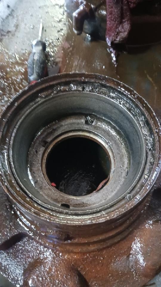

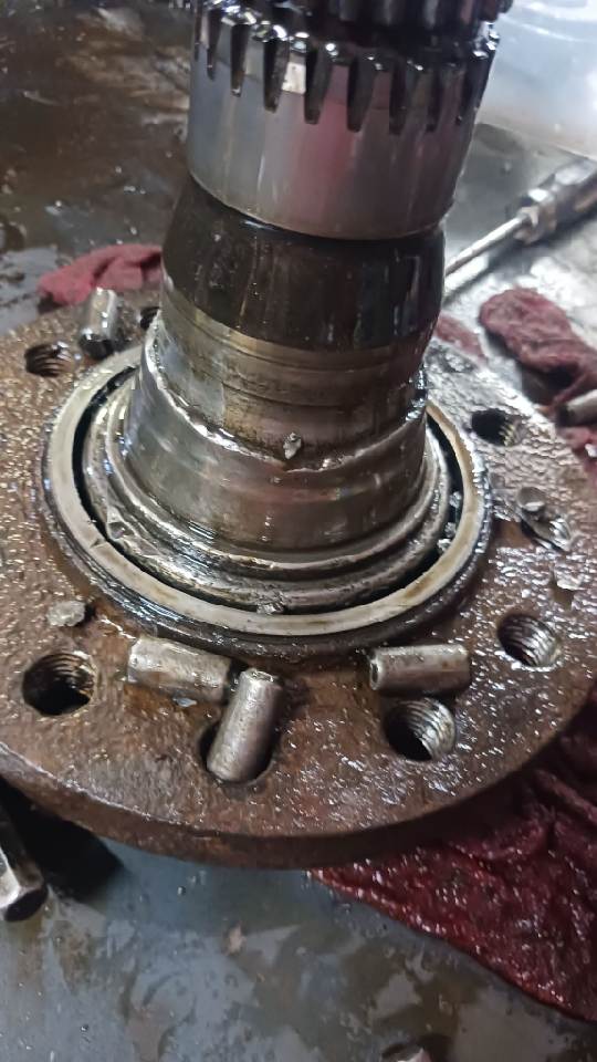

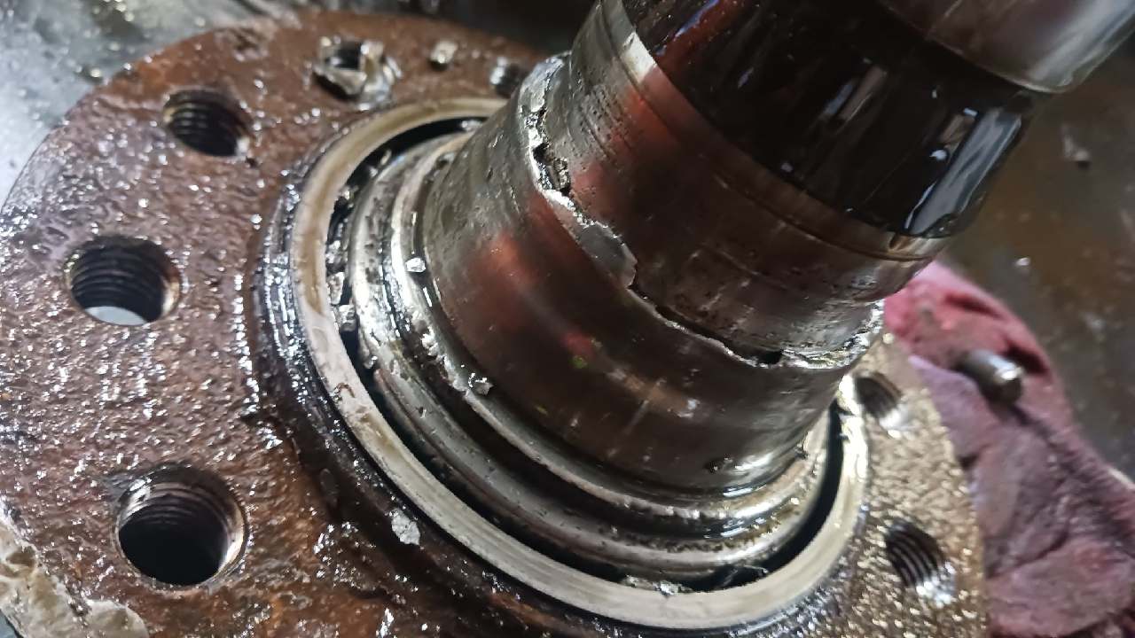

2012 T190 drive motor. Got these pics from the shop today. Case is ok. We're looking for parts now. I'll work on this uploading pics thingo
Too much damage to repair. My guy had a line on a rebuilt motor and is now trying to insure its the right one. He's not getting much help from Bobcat. I don't like to bug him too often. I'll be back this week with more questions.

LPS came back with this question. "Do you have a single speed or 2 speed? Also, do you have a speed sensor or no sensor?"
My motor is in the shop and my shop hasn't got back with me yet. Can anyone tell by my pics what I have?

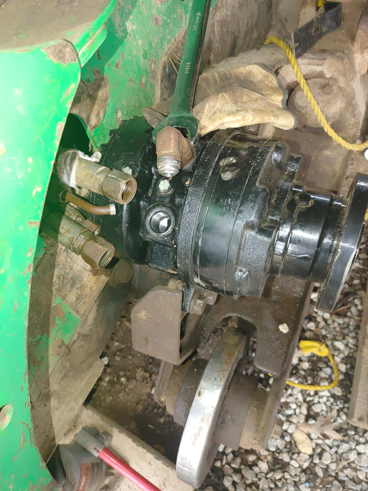

Back from vacation. LPS doesn't have a motor for me. A tractor salvage yard found one in their network. $3500. Waiting on one more guy to get back with me. Anybody out there got any other ideas?

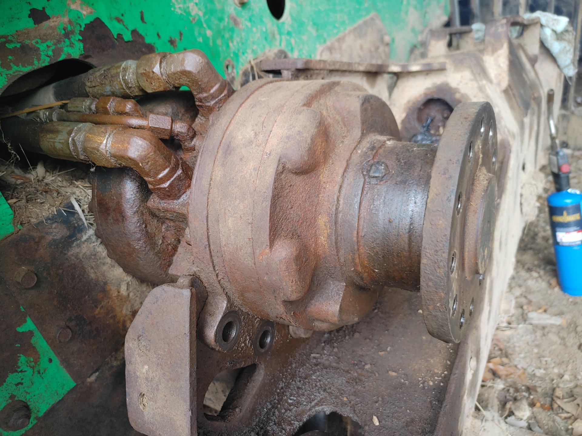

Started not reacting to forward and reverse signals properly all of a sudden. I got it to go forward and I drove it 500 or so yds to the shed yard where I noticed oil pouring out of the end of the hub. I had added oil to it before that day but couldn't find leak. No oil in engine compartment or hoses. Must have been leaking out of hub behind sprocket and onto grass.
My repair guy said it was probably because I didn't change the hub oil. I never knew that was a thing.

Unfortunately I parked my skidsteer too close to the wall of my shed and can't change the oil in my good motor while I'm waiting for the new motor to come in. I guess I might be able to put the track back on the rollers and back it out.
