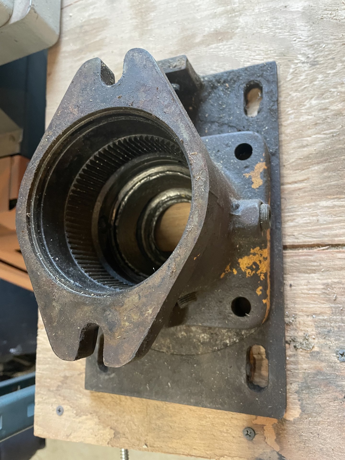

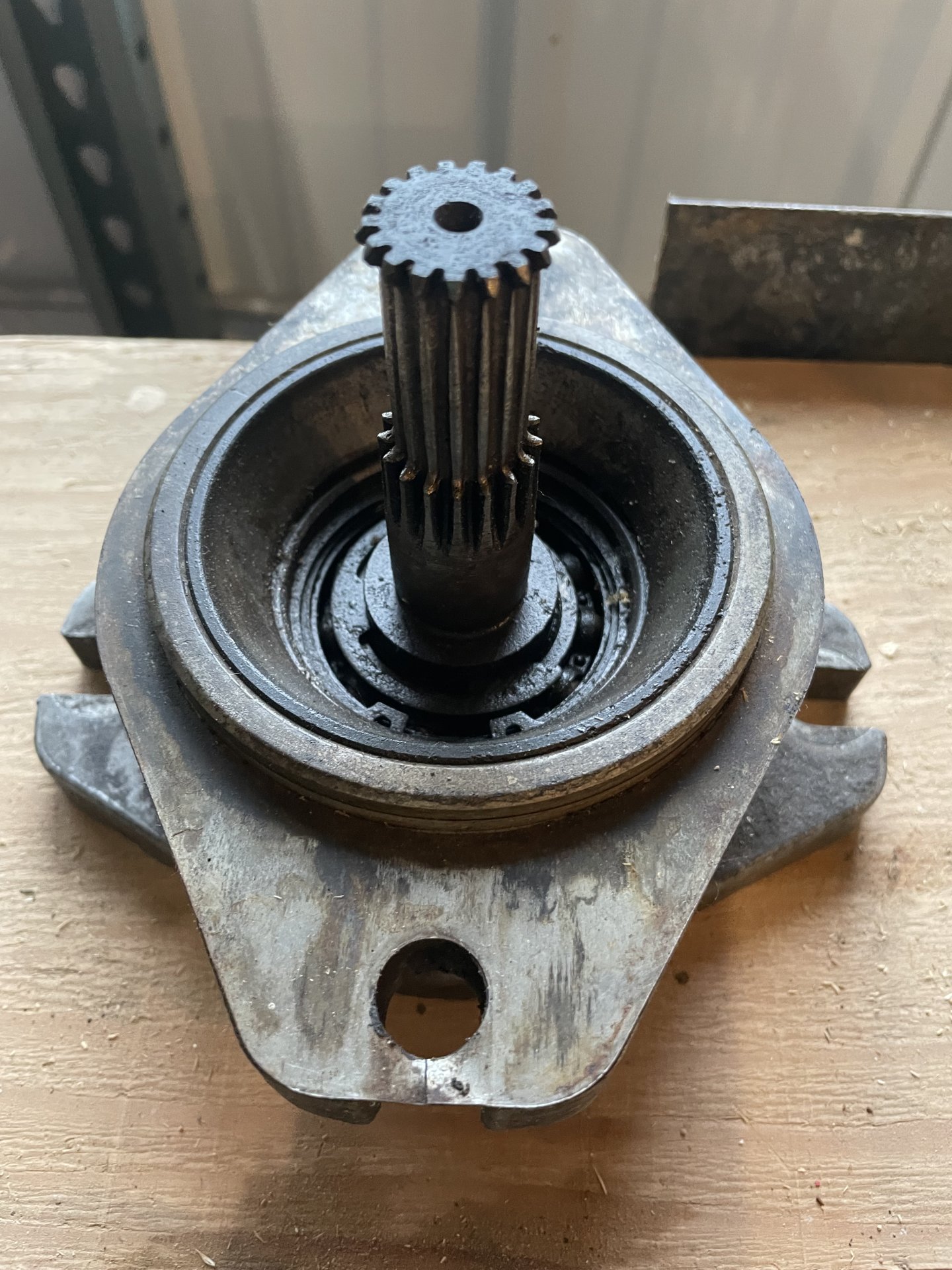

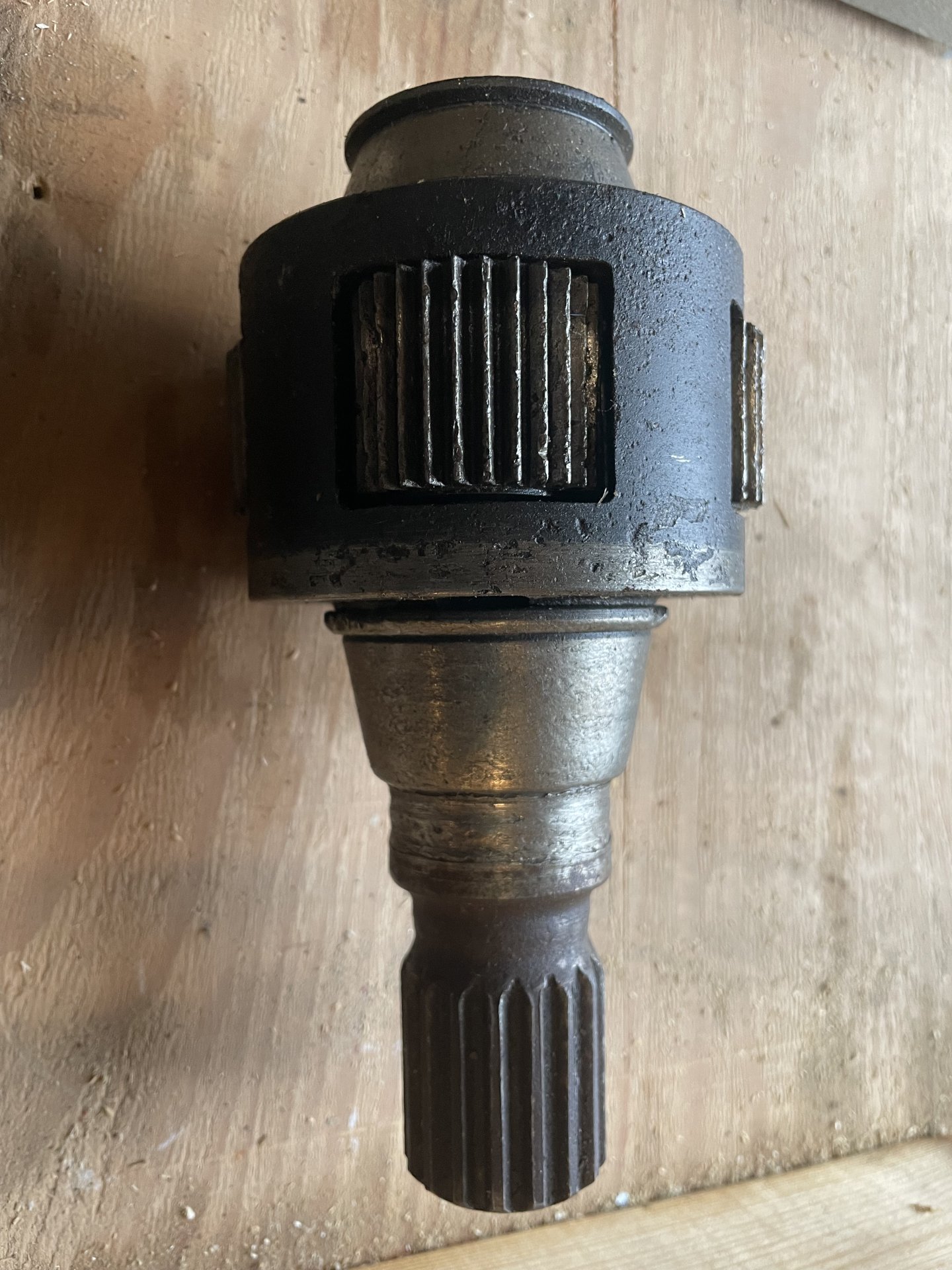

My 1845 skid steer has been out of commission for years but I keep looking for a rebuilt,used,or a machine shop to help me.:)van
I have an 1845c that burned severely. Would there be something in it you could rebuild for yours?

This is something I would like to have done for sure. But finding someone to rebuild a planetarium is not easy.ANY IDEAS OF WHO TO CALLWOULD BE APPRECIATED;)Van
How was the planetarium effected?if it wasn't damaged or worn out it might work ,do you have pictures? ;}van
I couldn't tell enough from your pics. It looked like the sun gear shaft was completely stripped or worn off, but the planet gears and outer ring gear were ok (sort of). This place looks interesting, but only brass:
https://www.precisionpinionrod.com/. Dig further online under pinion wire. One thing you will have to consider is that new gears are mated by design. Used gears won't mate properly with new ones--each tooth bangs on its opposing tooth until they wear together--the vibration can be extreme depending on the rotational speed. I don't know if a planet gear system would be significantly different. The fact that the sun gear wore out suggests that it was soft by design which would make putting in a new one possibly workable since it might wear in, and then could be hardened as needed to match the old one. Where the wear particles went or would go might be worth investigating. Boston Gear used to be the place to go for off the shelf and custon gears of all sorts. There are others too. You'd probably have to either have a machine shop send pitch and dimensions and alloys, or send them your parts. Depends on how desperate you have gotten. I'd look for the ohly machine shop in a smaller industrial area (mines or saw mills, etc) that had to fix whatever came through the door rather than a big city. You need a machinist whose standards are low enough to be sensible rather than perfect.
