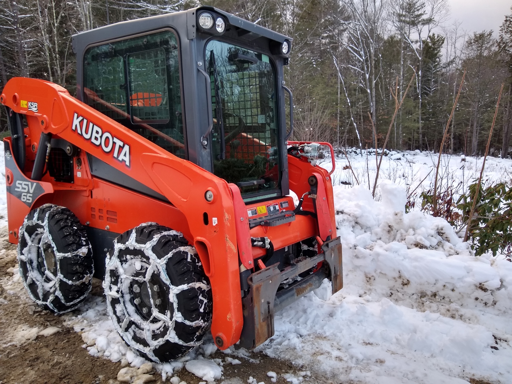

I'm in the other camp. I ran chains for snowplowing for many year.
Finally got a pair of snow tires and was floor at how much better they were.
Larger tire = more speed and more ground clearance..
And much better traction in most snow conditions - not as good as chains pure ice though.
So I'd say maybe try a different kind of snow tire. I got my locally.

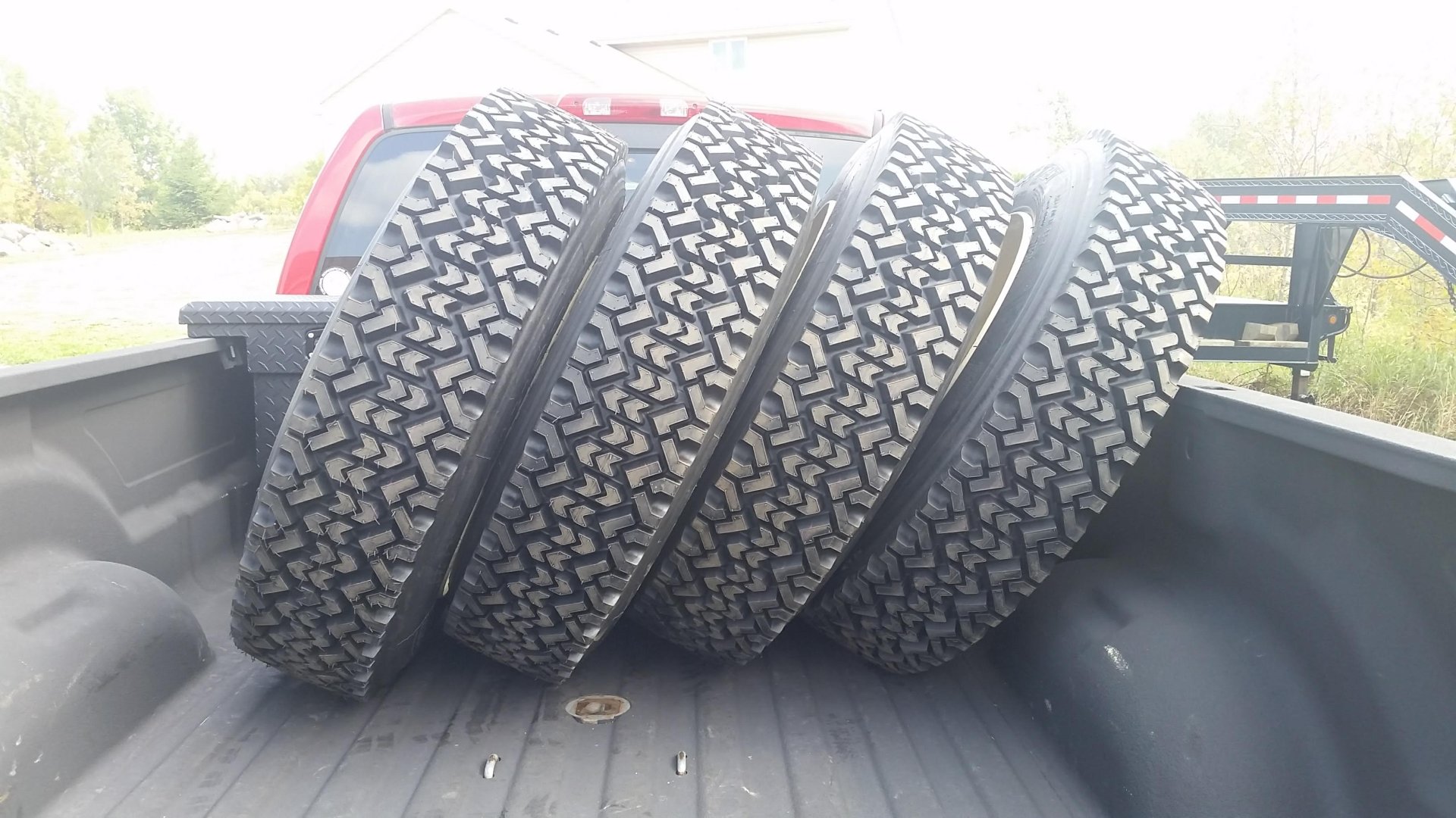

What brand snow tires are these? Did you get them with studs installed?
They really aren't a brand as such. I got them from a local place https://www.westsidetire.net/ that sells skid steer snow tires.
My understanding is they are recapped 22.5 semi tires with a snow tread pattern. And the lugs are deep. No studs, but you could.
I just got done plowing this weekend. I had 2ft deep drift on 12% uphill on my driveway. Under that was pure ice from a previous storm.
Couldn't plow uphill, but was able to drive to the top and then plow downhill.
NO WAY that would have been possible without these tires or even chains.
Once I got the snow plowed, I started sliding on the ice under it. But that's just ice.
