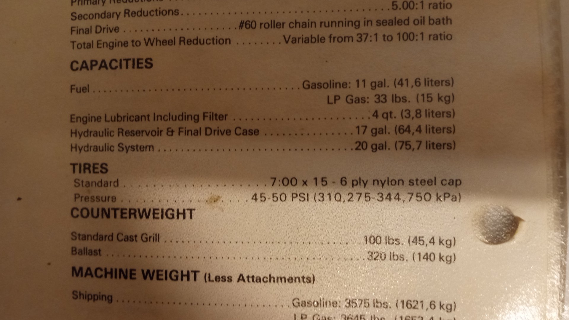

Thank you, I did find the original equipment specs. I just want to verify that I have the original rims on the machine, as I have read that the larger 16.5” will fit. Being an older machine it would not surprise me if the previous owner swapped them out.

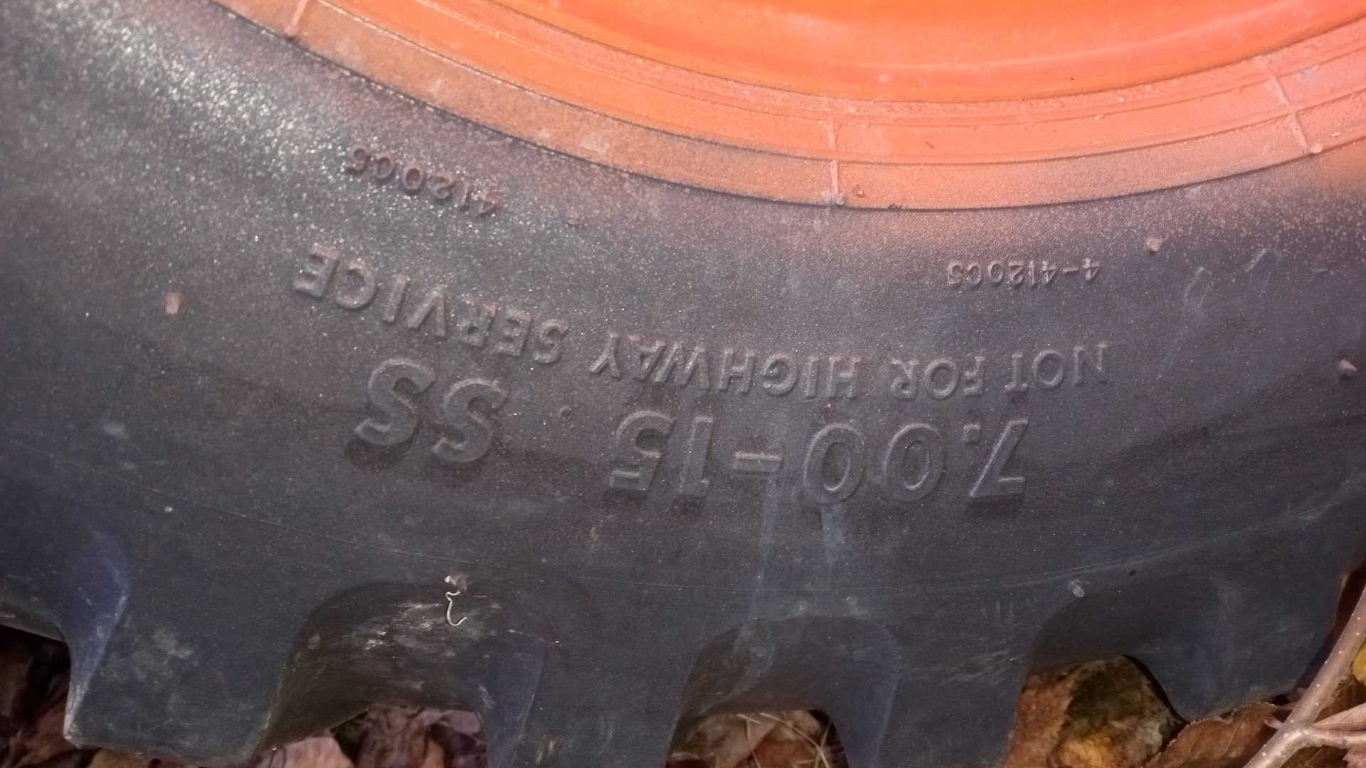

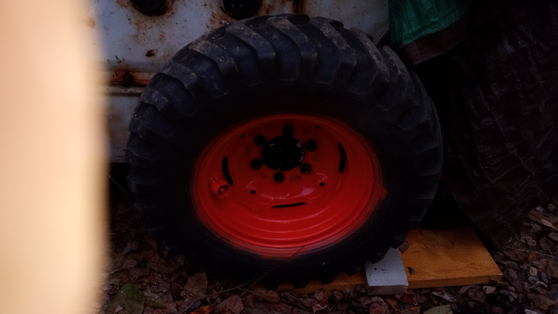

. This is a picture from my current 610. The standard size was 7x15. I just measured the rim, and it was 16 and 3/8 in outside diameter they have a chevron pattern to them. I restored another m610 and sold that a year ago, that one had 10x16.5 tires on it, Those ones had your standard skid steer tire on them. I just measured my bobcat 763 rims and those are about 17 in across, they have 10x16.5 tires. They do make a 27x8.5-15 skid steer type tire for that 15" rim. Walmart plus and Amazon prime have really good deals on those.

Awesome, thank you lmcl123! I screwed up, my 15 1/4” measurement was approximate at the root of the OD. I also have about 16 3/8” for the true rim OD. So the ID of the tire must be what determines the size. Mine are 8” wide at the tread, but barely clear the lift arms on the front, so I can’t go any bigger. The ones I was looking at were in an online auction, but are 15x10, so they won’t work.
