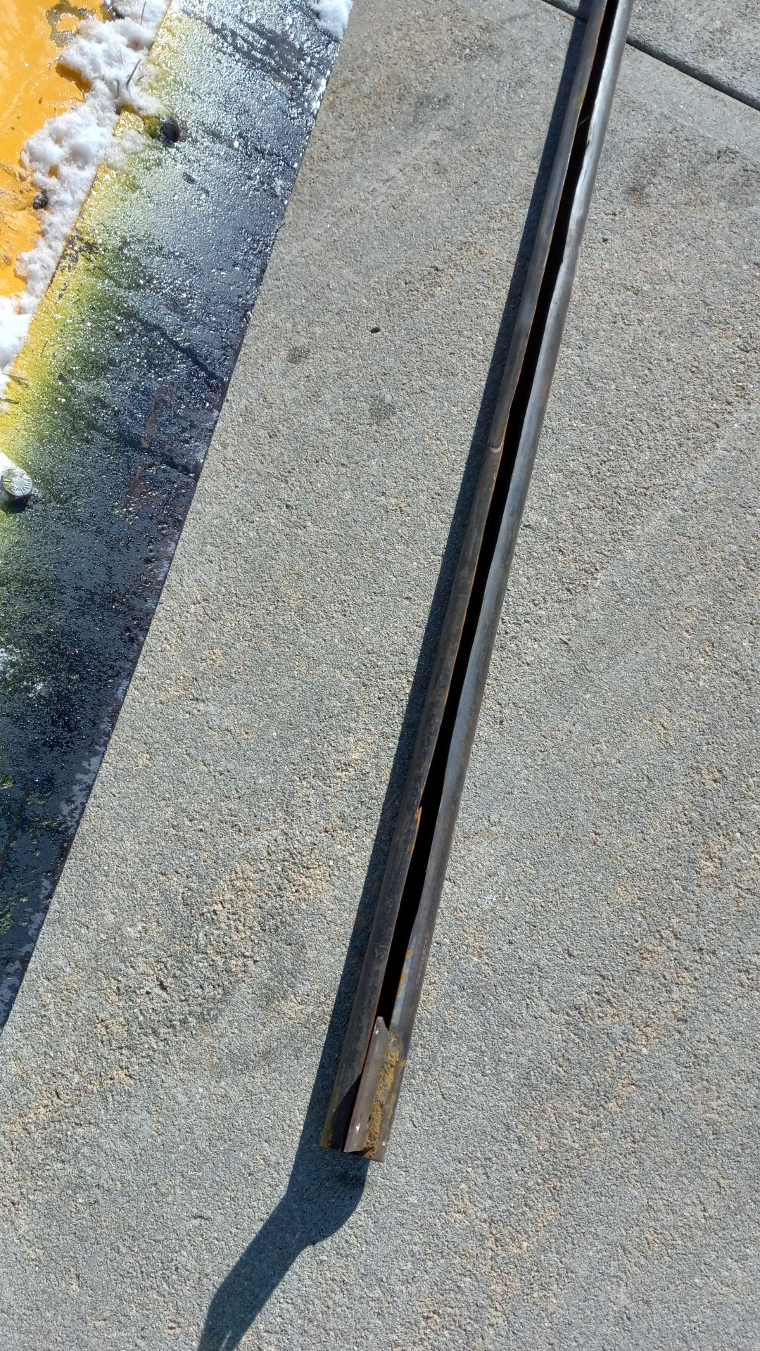

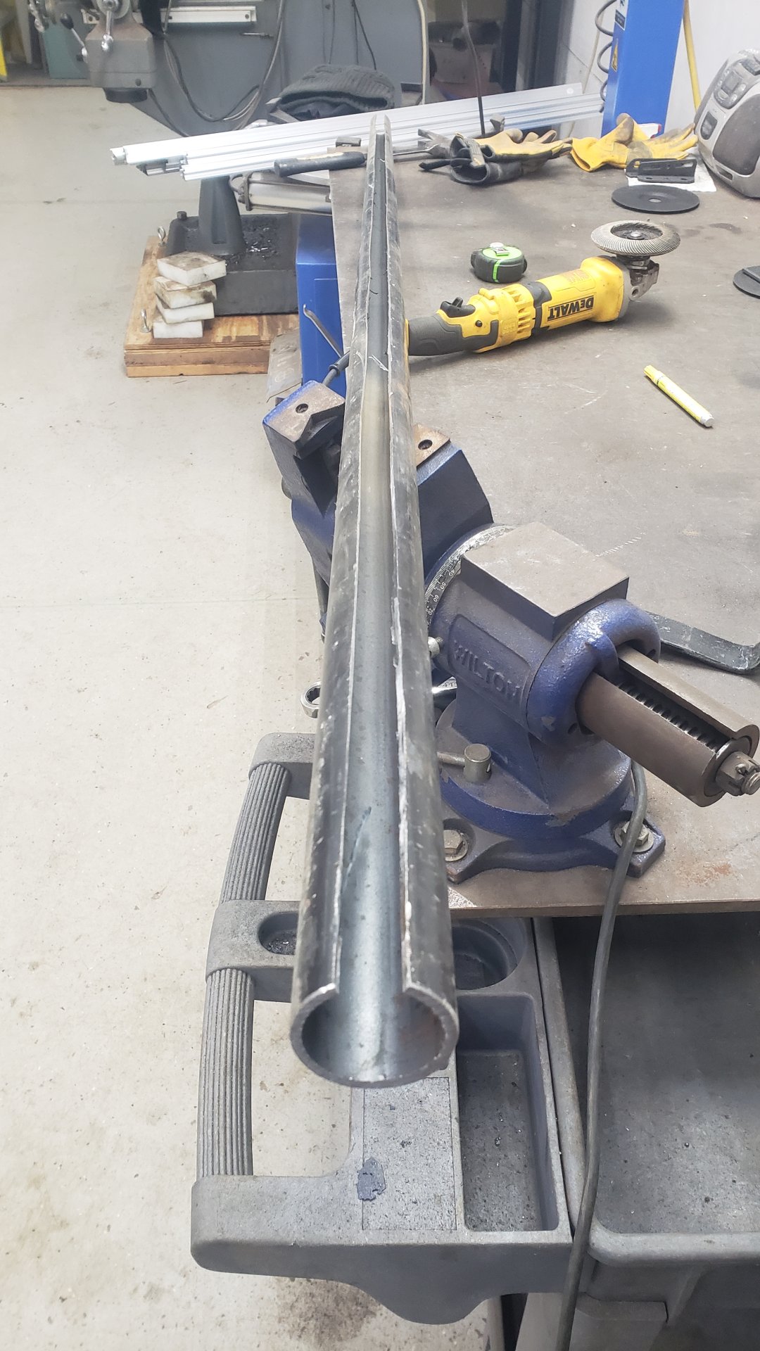

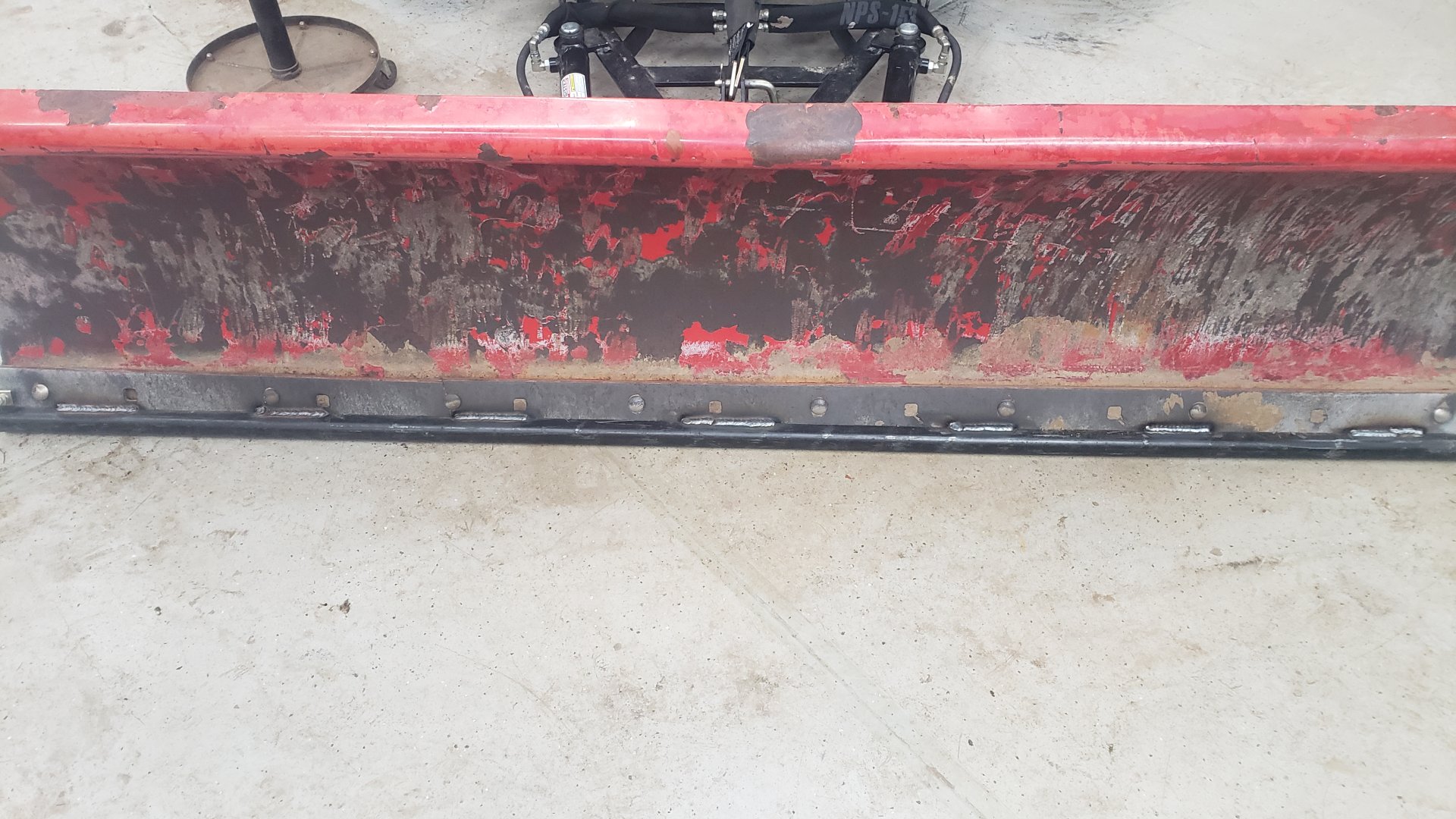

I got a small mustang 332 that I cut down an old meyer blade, and for my gravel lot I cut a length of 2" steel pipe then cut out a slice the width of the cutter bar and now I move snow off gravel with out digging in even with tilt forward pressure on the blade, went across some grass area and didnt rip up grass, works slick.. putting one on bucket edge should have same results, give it a try
lol, I just did this last weekend. Google 'snow plow gravel guard' for ideas.
Here's mine. Cut a 1/2 inch slot down the middle of a 1.5 inch black pipe.
Then welded it over the bottom of the cutting edge. (my cutting edge was fubar anyway).
You can make them removable too with some tabs and bolts.
Worked better than I could imagine. Clears the snow, but floats over the gravel.
Also requires less effort to push snow since it doesn't dig in. Win-win.

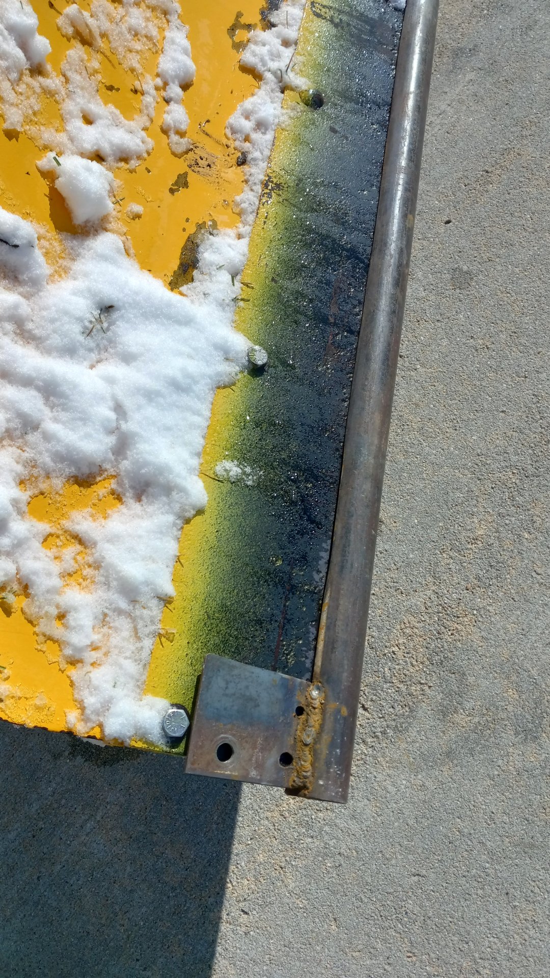

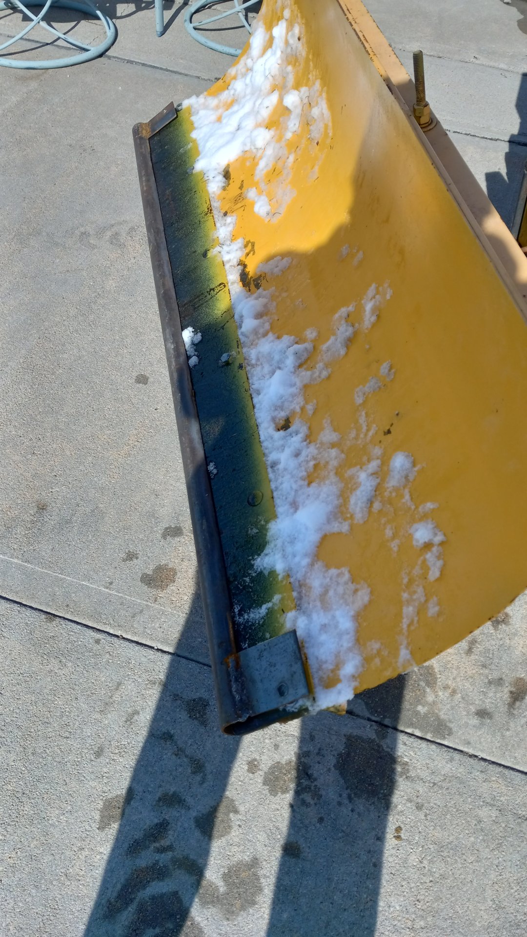

yes i can get some this weekend or like stated plenty on you tube that use pvc, i think steel will last longer, I used mine on concrete with good results
This is what I came up with and when I use it I pull 2 outer blade bolts and put them back in to hold pipe on works ok on concrete, but won't Peel off packed snow with pipe on. Looking into coming up a quick pin or a slotted latch to make it toolless removal
