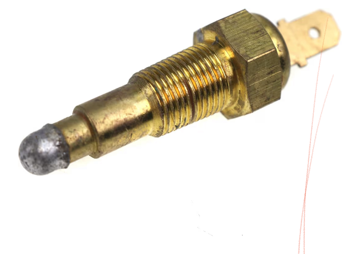

have a skat trak with kubota engine and my machine is flickering the coolant warning light, not full bore like overheating but a slight flicker. Ohm tested the sensor and get no reading at all so either im doing something wrong or its DOA.
I bought one on amazon that said was for kubota v2203 but it showed up looking way different and ohm reading was very low for 40-50deg compared to what ive read online that it should be. Put it in and started then got full loud overheating warning. I dont know how my machine reads overtemp. The single wire has 12v with key on. I attached a picture of the style mine has
Rather have it working correctly but im debating putting a aftermarket actual temp gauge in then trying to somehow fool the factory gauge so it shuts the warning sound off
