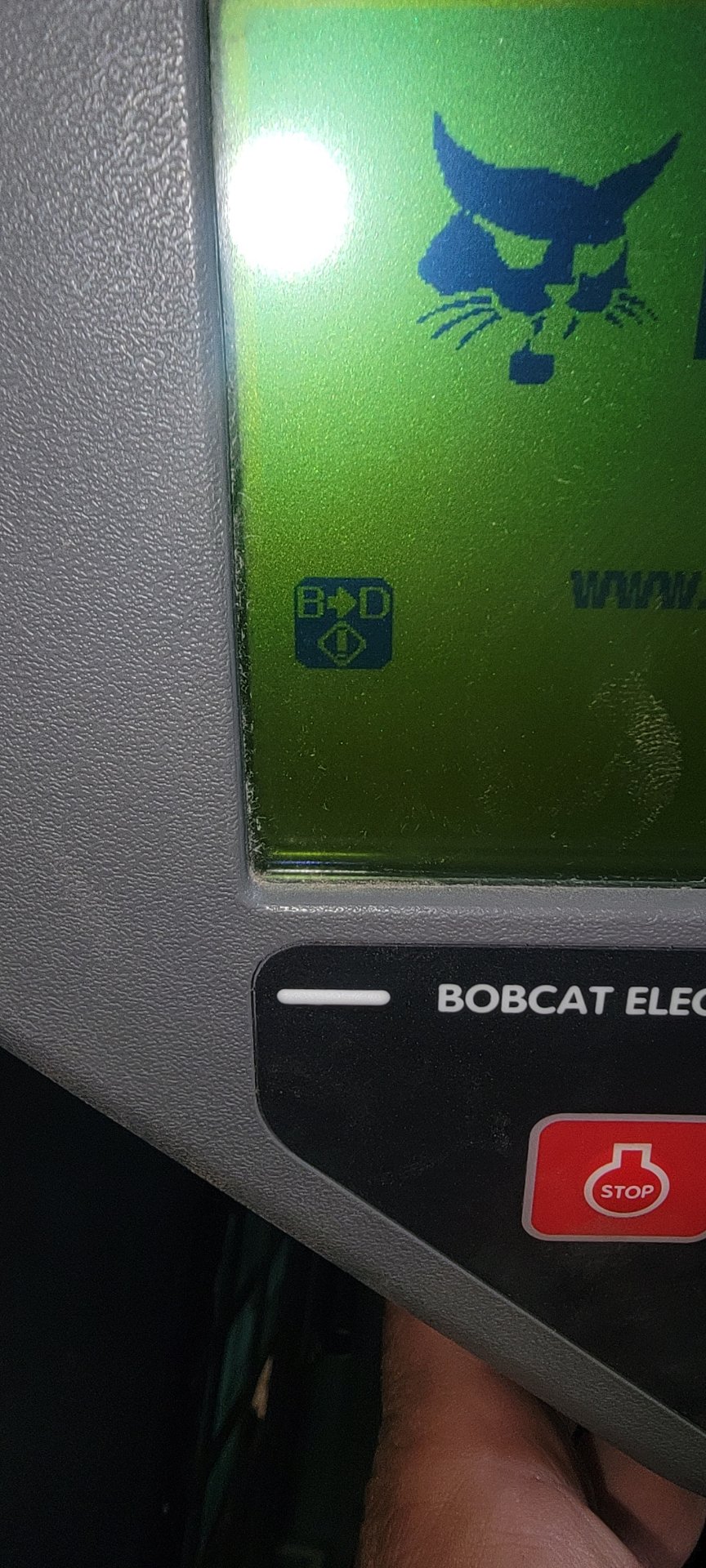

my S250 does not have a key. I push the run/enter button the display lights up some relays click and the display powers down. already cleaned all my grounds at the battery and rear frame, cleaned the positive battery post. if I hold down the button for a few seconds i get on the lower left of the screen a logo with B a right arrow D and below the letters the symbol !. not sure if that is some sort of error code. if anyone could help I would greatly appreciate it.

I have never seen this before. Those are not icons that show problems. It's like the screen is stuck on a partial menu screen. You may have a controller problem. The only time I know of a right arrow coming up is when it points at a button to choose a menu option.
Could you take a photo of the screen?
You may want to start looking for a short or loose connection in your wiring.

Here is the image on the display

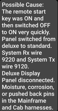

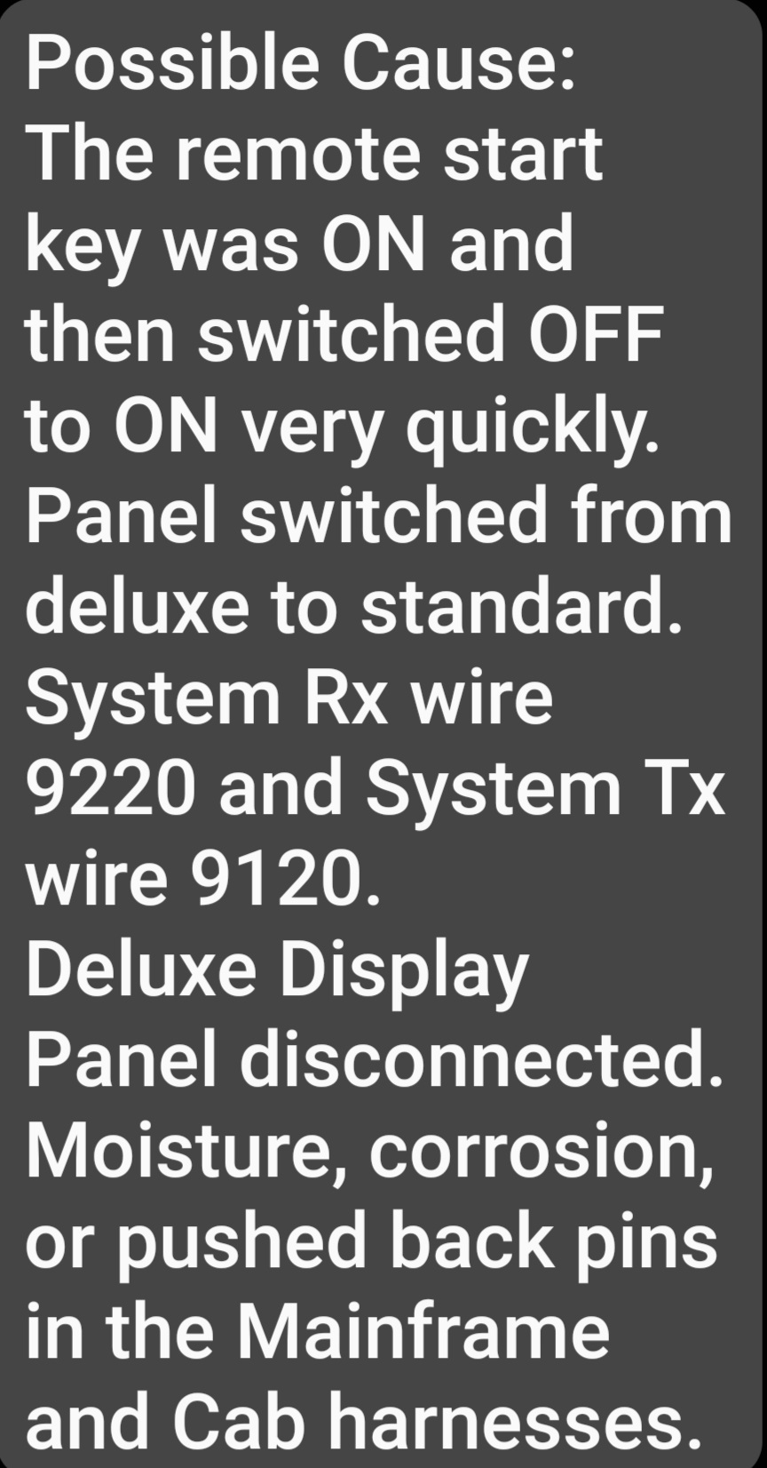

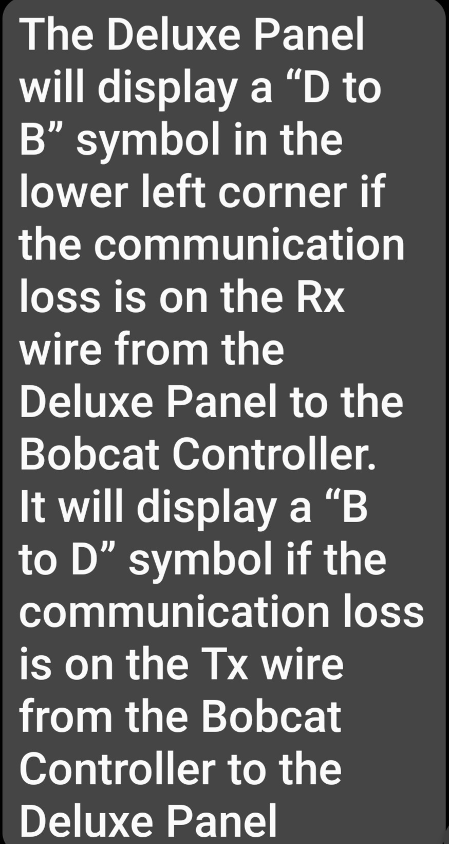

This isnwhat isocell gave me about the symbol. Still haven't found the issue. Checked resistance from control panel connectors to controller connector and they ohm out at about .09 ohms. Checked my power and grounds at the controller and my power and grounds are all fine. I'm thinking the controller is my issue.
