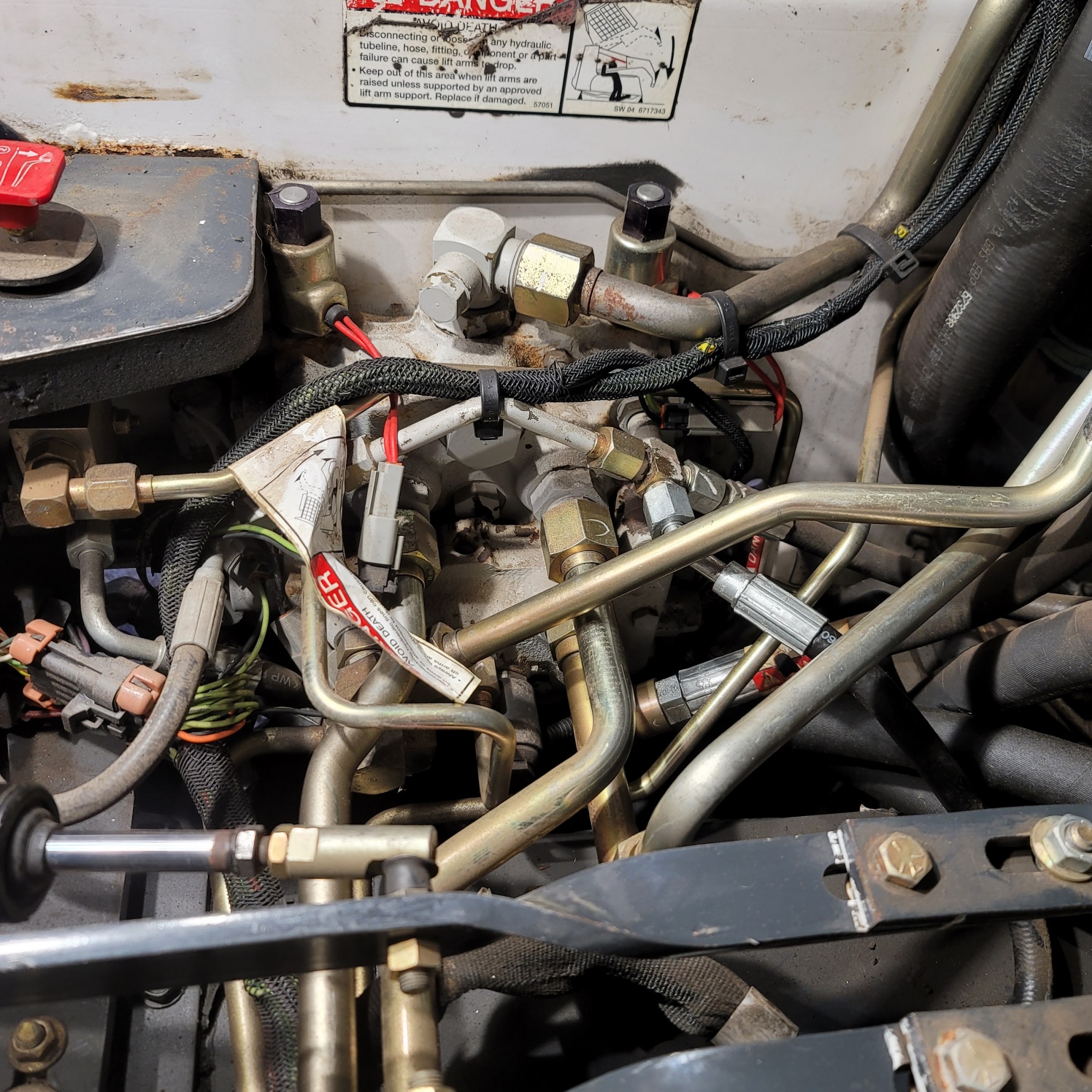

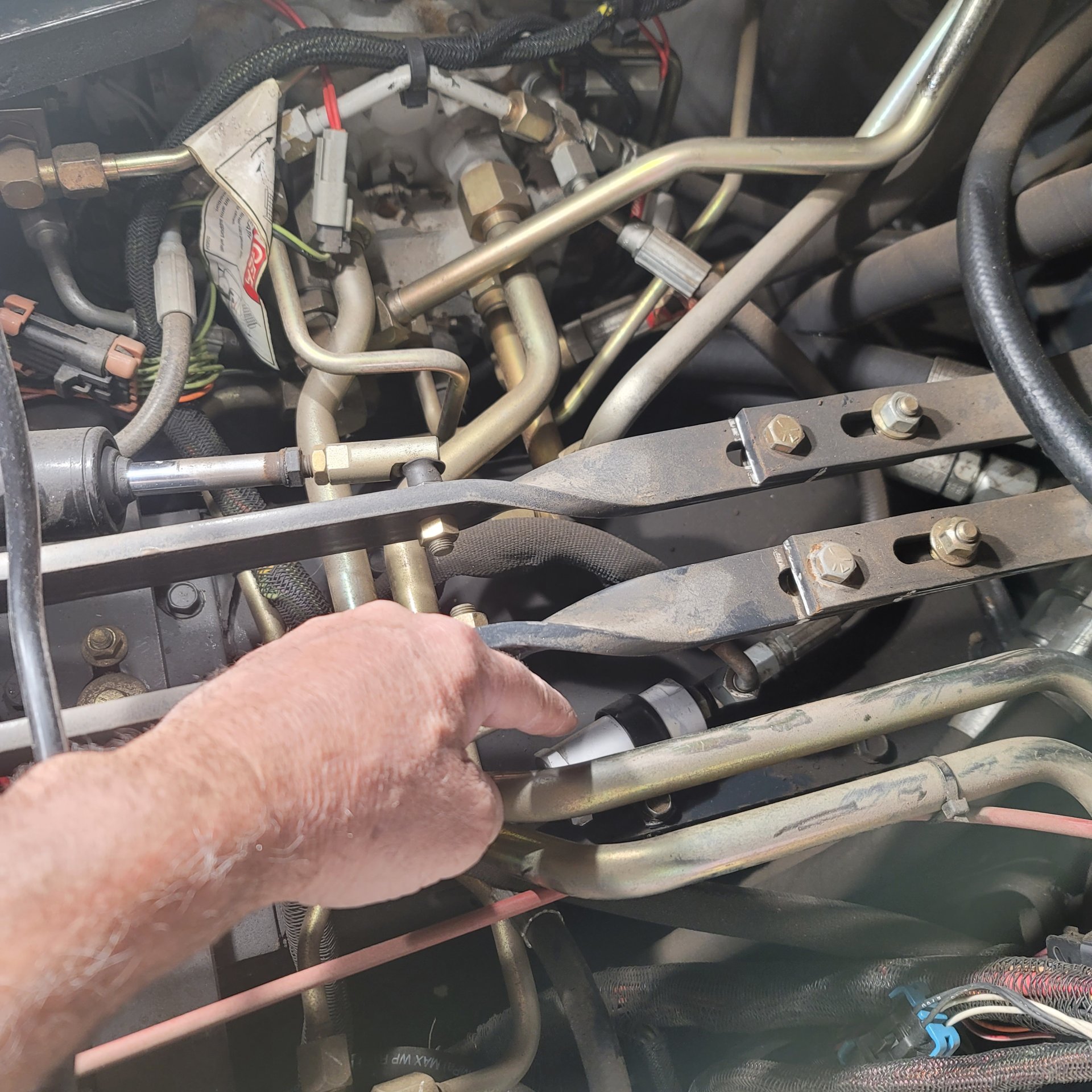

I thought I'd upload some pics, in pic #4 is that where these valves might be??

Photo number 4 is the control valve. The Charge Check High Pressure Relief Valves" are located in the pumps.
Since you say you are having trouble with the left side in both directions, make sure you "check the outlet and return oil lines from the effected hydrostatic drive motor to the pump package for leaks or restrictions". (That quote is directly out of Bobcat Hydraulics Manual troubleshooting guide).
Also, the manual I am using is a general manual that does cover several types of pumps but may not be specific to your machine. It is an older manual. For example, just looking at one of the parts manuals, there are two different pumps for manual controls on the S130. There is also a chance that you only have one check valve for each side that cover both directions. I would suggest taking a look at the parts manual for your specific machines serial number and looking at the hydrostatic system as a whole and then deciding if you want to dig into the pump or not.
