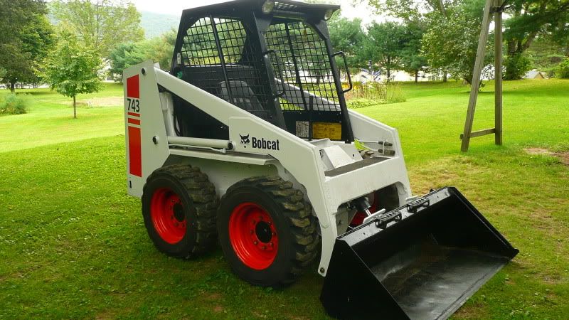

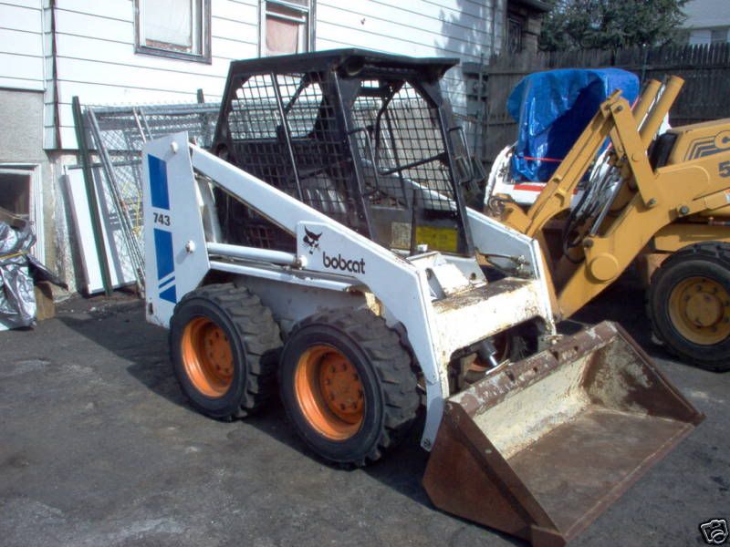

That looks great - nicely done. I have to show off my recent 743 project. Before & after...

The Bobtach pins & bushings were shot and I had to replace the "million dollar" hose so it ended up being gutted. My wife is a lot happier now...

What a difference a coat of paint can make :)
Don't mean to sound picky, but I'd have hammer that rops back into shape somehow. Otherwise looks great.

-actually, I tried to pull the bend out with a stongback and my heaviest C-clamps, but no go. Porta-power time baby! But no gots. The bucket was rotted also - replaced most of the bottom plate with new.

Where did you get those orange decals on your 743. I think they look better than the blue ones like I have. Also did you paint the ROPS black or is that Charcoal
Those aren't decals - I used just a bit of black electricians tape to make off the areas and then sprayed them with Case Flambeau Red paint. I used Rustoleum Industrial black and white gloss paint from Lowes everywhere else....
