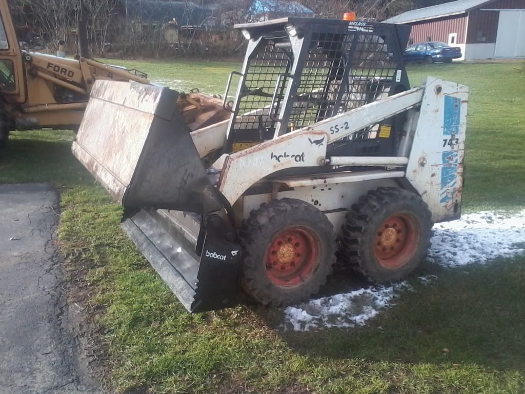

If you plan to use it for brush and handling wood, definetly get a one with open tines for the bottom with independent grapples. Clam buckets (4 n 1) are good, but are somewhat limited. Dont get anything built super heavy or wider then 60" for a 743. I bought a 74" Bobcat combo bucket off craigslist for $675 last with very little use, its VERY heavy though, Almost 1000lbs. My 743 wasnt happy about using it unless you were handling light brush. If I were you, I would opt for a light duty 60" brush grapple...less weight, more you can pick up. As long your the one running your machine, I dont think the 743 is strong enough to break a grapple. Or buy anything cheap that works on craigslist, that what I do :) Photobucket Photobucket

I run a 4 in 1 on my 743, no issues here. All my machines have come with 4 in 1 buckets, i couldn't live without one :)
No issues with lifting abilities either, I sure can move a lot of dirt and fast with it. Great to load, just grab and close the clam to fill. No need to try and get enough traction to push into the pile to get a full load.
