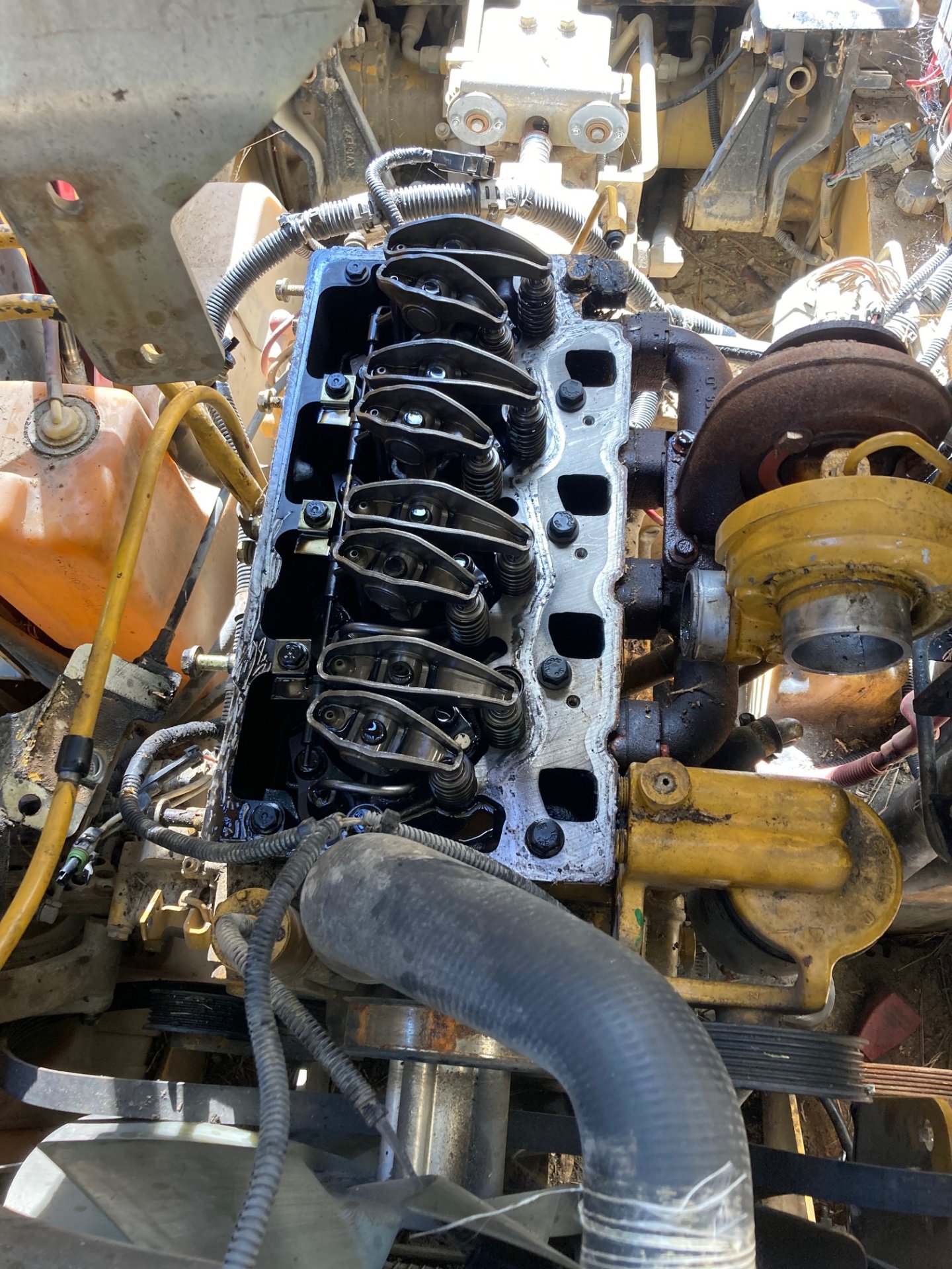

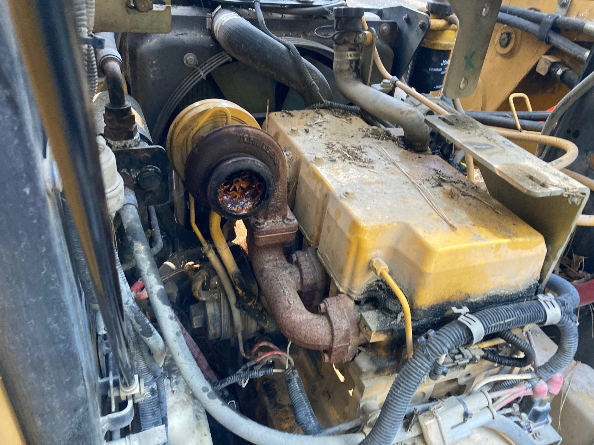

Hello Folks, I am doing some pro bono work on a Bible schools' John Deere 317 Skid steer that was inadvertently exposed to the elements, for a couple years. (The exhaust points straight up with no rain cap). While removing the exhaust from the turbo, water poured out. I attempted to heat the internal of the engine with a heat gun through the exhaust and intake as well as squirting large amounts of WD40 into it. Zero movement of the crankshaft with the starter. I was able to turn the crankshaft back about 180* and then forward again the same amount and then it comes up against a hard stop. I figured that there must be at least one cylinder that has a ring of rust built up in it, not allowing the piston to go past. My original intent was to remove the injectors and fill with a penetrant, but once the rocker arm cover was off, I got a little too carried away…
I had envisioned getting the head off, cleaning the cylinder(s) and perhaps the valves/seats, bleeding down the lifters, installing the head with a new gasket, checking/adjusting the valves, re-connecting everything, drain, flush and service the engine oil and fuel tank, as well as replacing the oil & fuel filters.
However, I was unsuccessful at removing the head. It appears that something is still holding it attached to the block near the front of the engine (aft side of the skid steer). There is a remote mounted oil filter bracket that appears to be attached to the head and the block. The heads of the bolts are sandwiched between the oil filter bracket and the block. Looks like a tickle technique to get those out? It also appeared as thou the timing gear cover did not need to be removed to get the head off, as the attachment of it was below the split line of the head and block. Perhaps this is an incorrect assumption?
