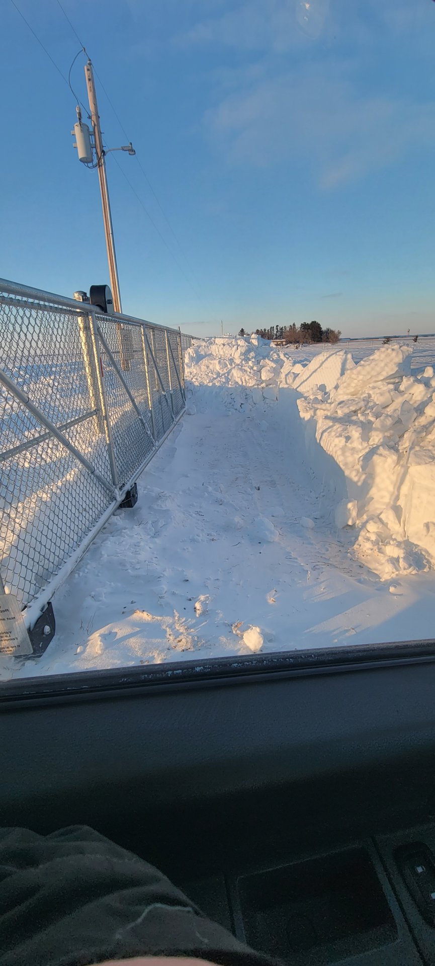

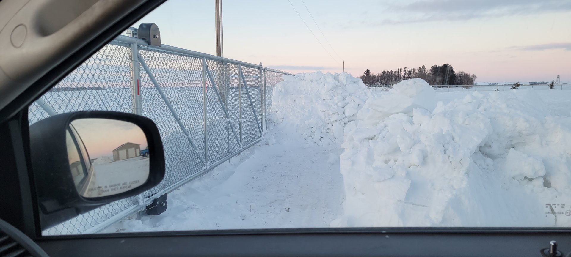

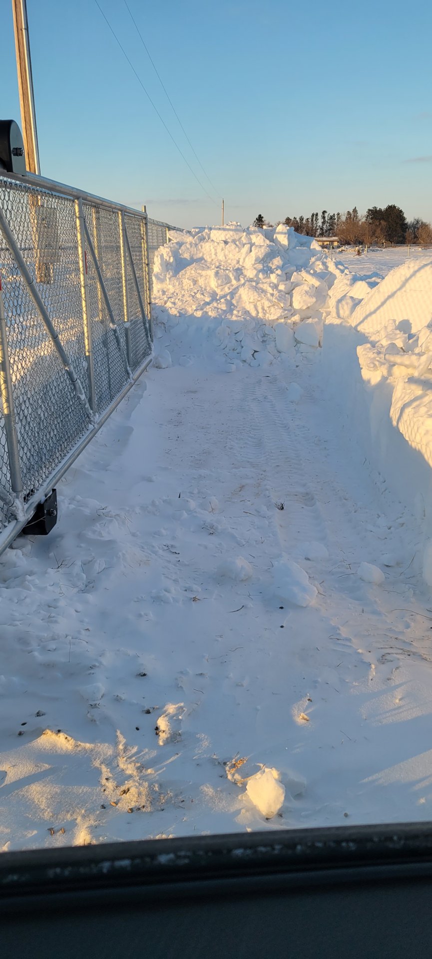

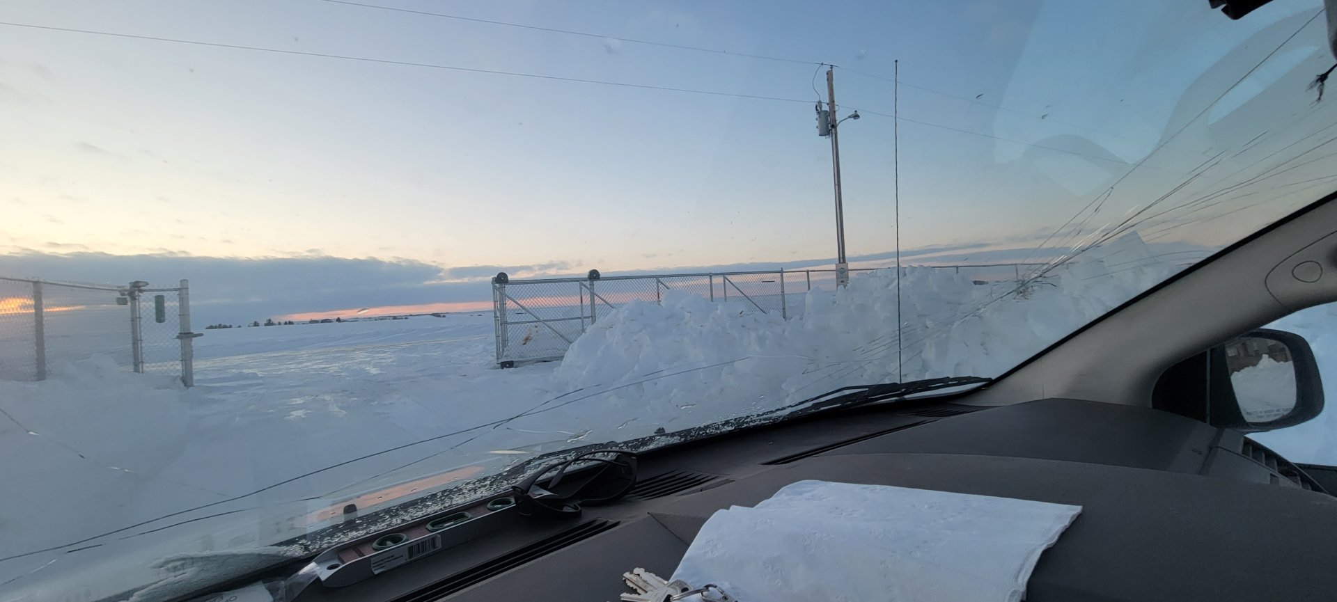

Nice! What kind of travel? Tires, TOT , tires with chains?I took a couple pictures of the last custom snow removal I did. I had to clear snow against a gate on a fence line. No way a plow blade would have worked here.
