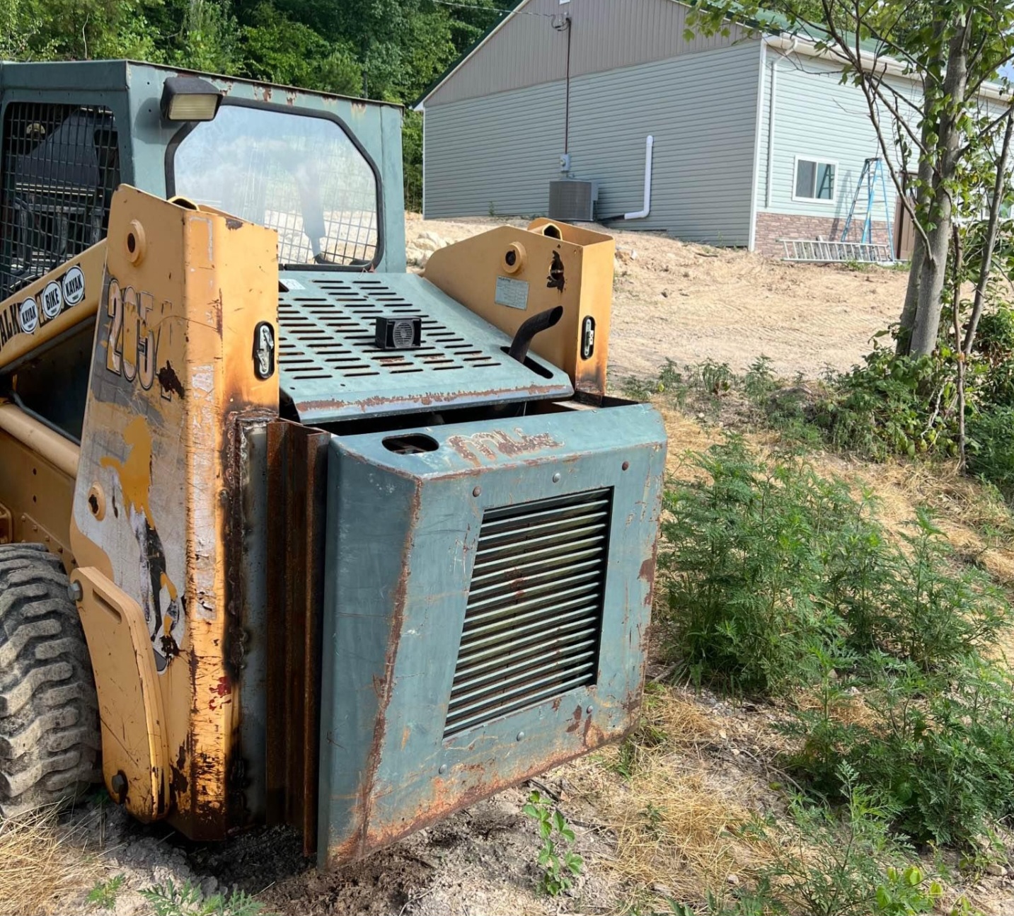

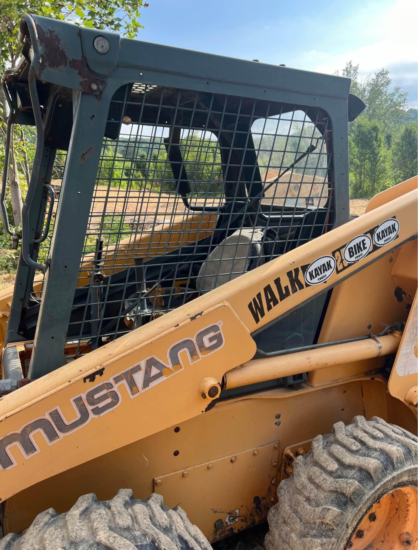

New to own a Mustang 2054
If I can only get to use it, the person I got it from. Did a engine swap with a Thermo King. The statrer went out and that was the start of everything. They did not wire up old sensors. Now it cold with no (Preheater). I've been unable to find any information on the motor to even start trying to wire it up. Before that it was great!

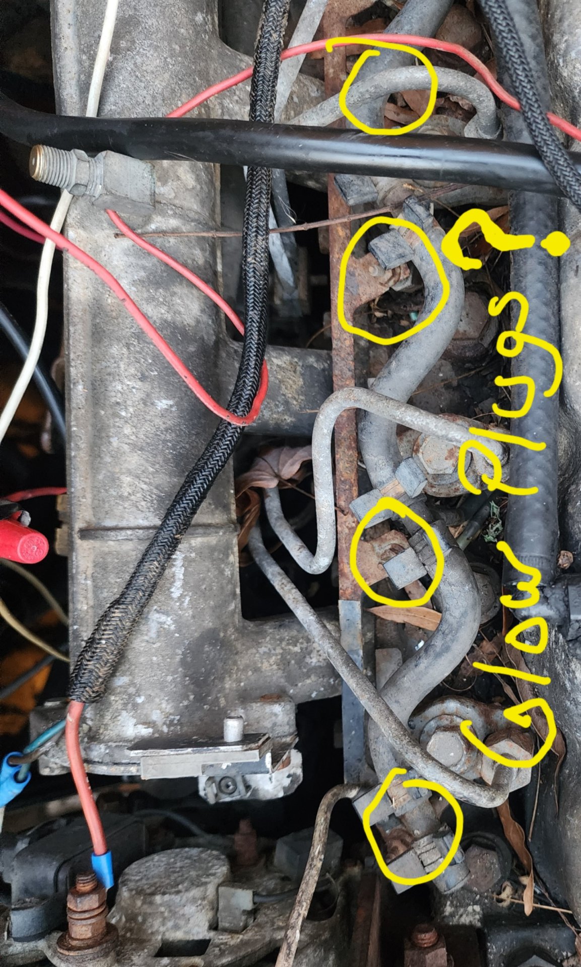

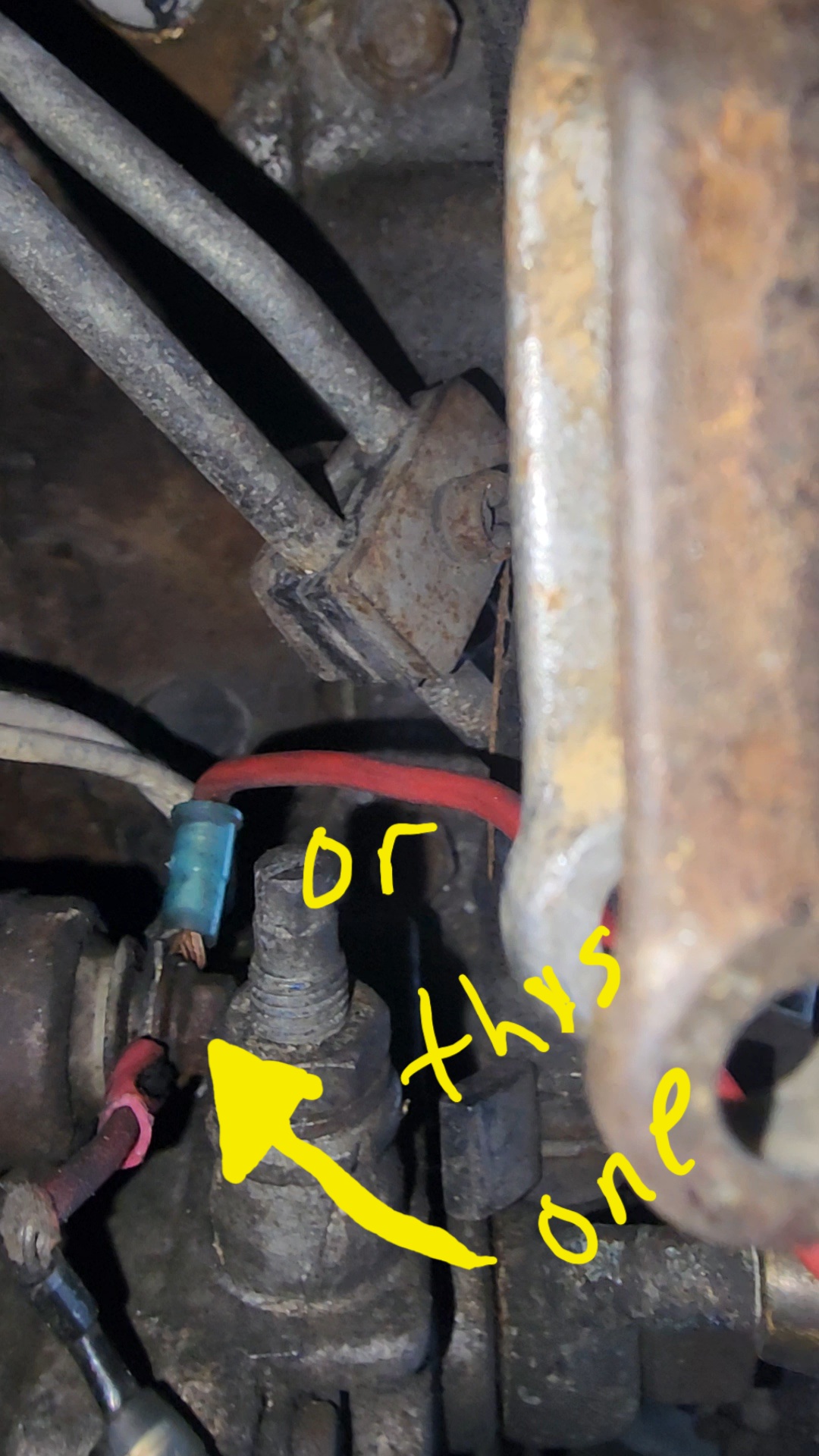

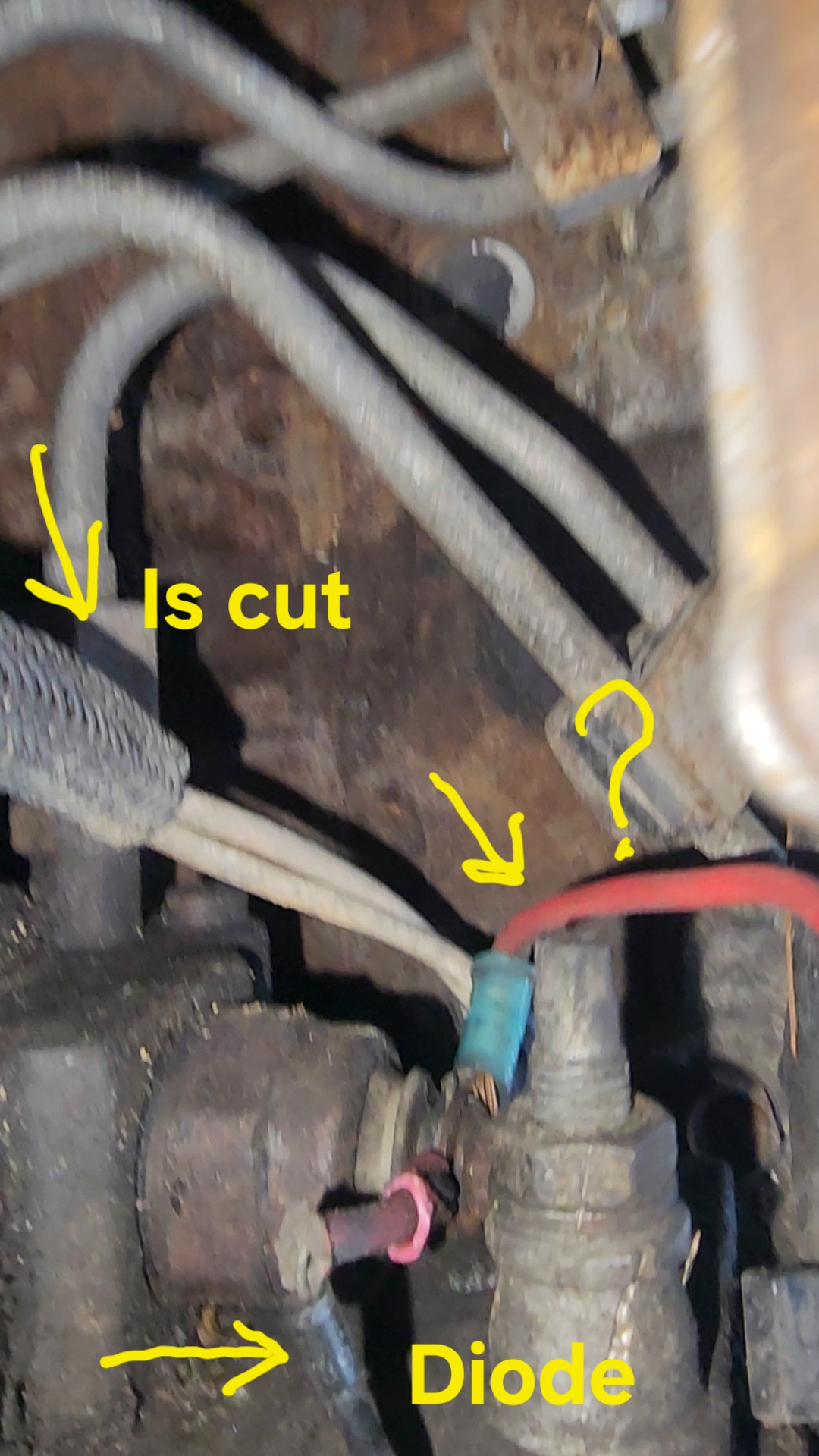

Thermo king izuzu engine is a foot longer than the original. Have no clue If the 4 points with connecter bar on top are the glow plugs or pre-heater right there below the carburetor. I have no idea because the wires are cut on both locations and same color wire

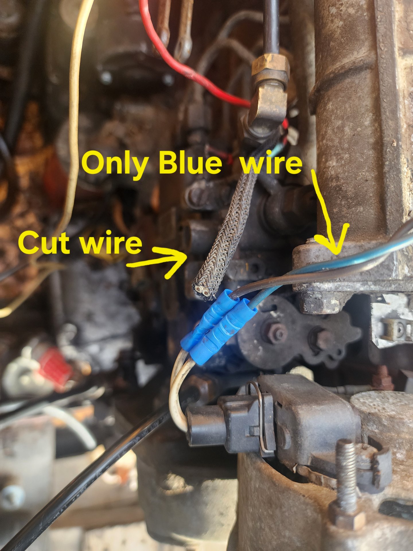

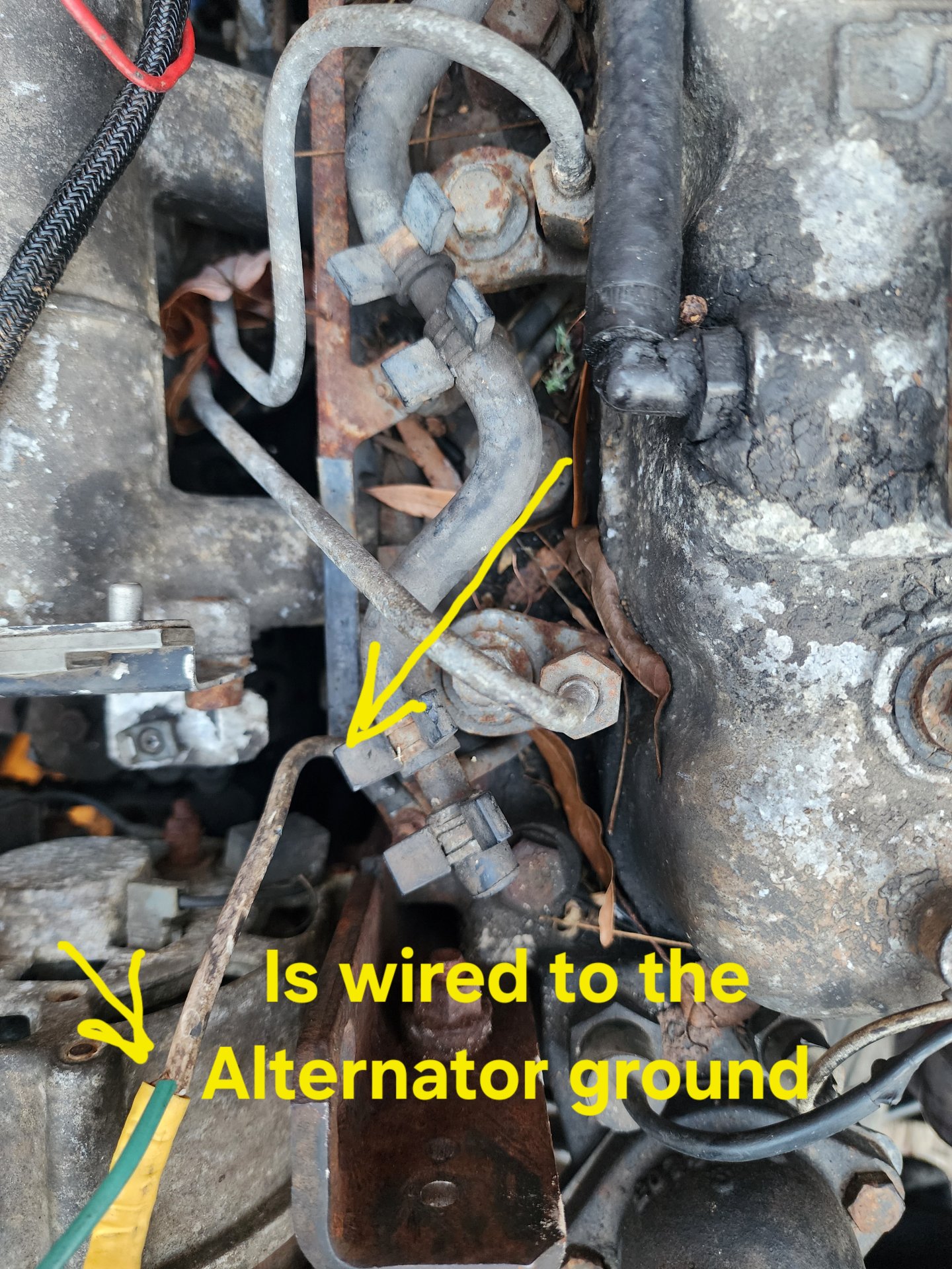

Man that makes me sick just looking at that, blows my mind how some peoples brains work, why would someone chop up a perfectly good loader just to save some money. those are glow plugs, the original preheater was fed from the thru the relay that is located on the fire wall in the engine compartment next to the main circuit breaker

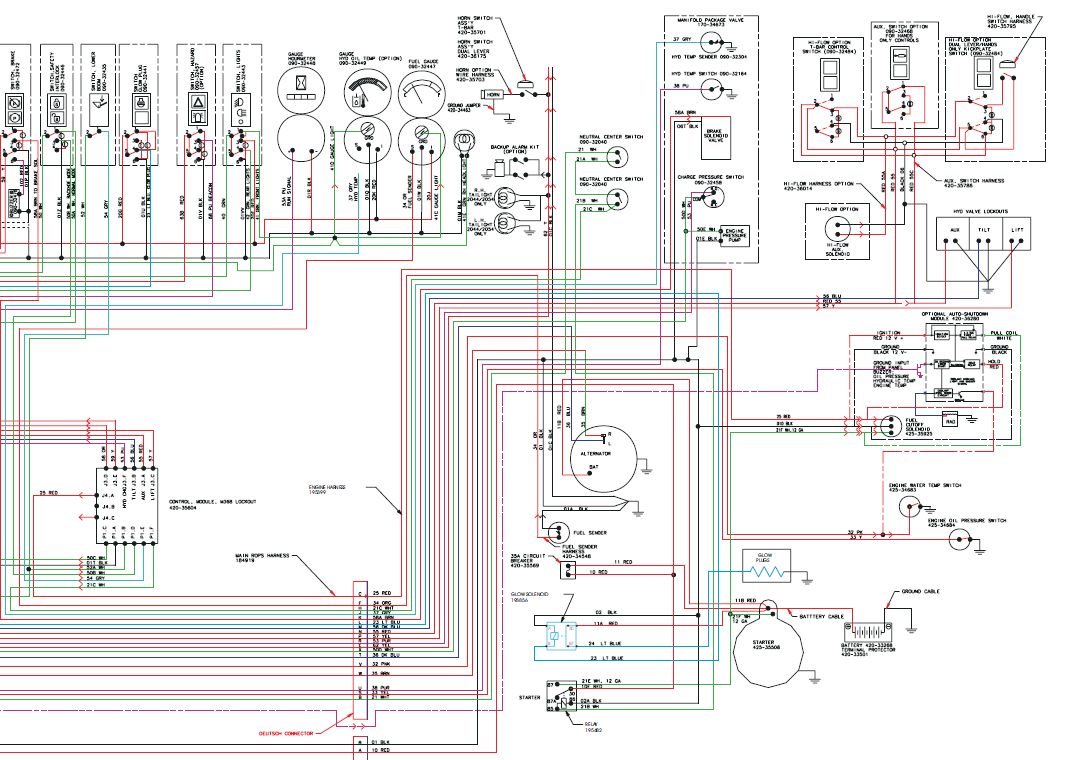

underneath the cover are to relays a start relay & preheat relay. the preheat relay should have a blue wire that ran to the preheater
