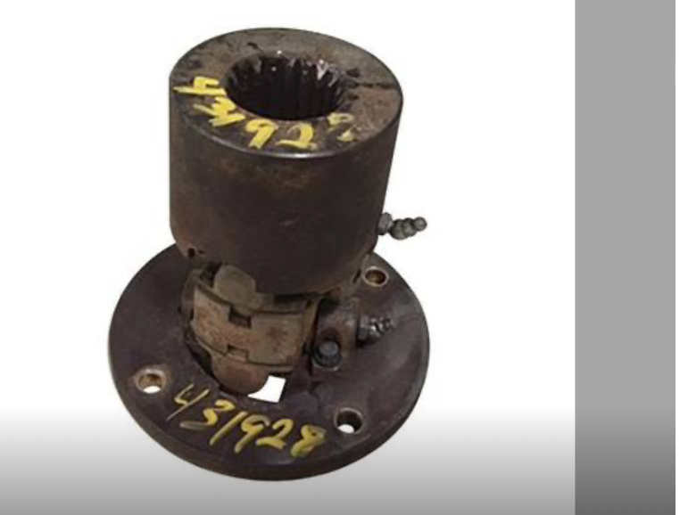

just remember to grease those zerks on the driveshaft,they are often overlooked.
There is a good "how to locate" article on this... it involves raising the cab and laying on the pump as you reach around the "firewall". You wouldn't know about these if it weren't for the helpful forum that you are currently reading... this forum is very helpful...
Ujoint coupler btwn engine and hydr pump.
