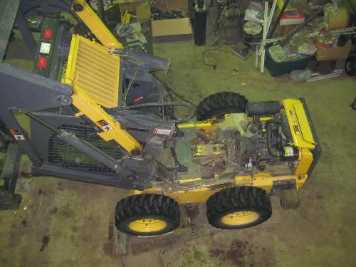

Hi flow is a asset for snow blowing, stump ginding, brush mowing and asphalt planing. I'm adding it to my ls160 (which is the same loader as your looking at except I believe the Lx has a Yanmar engine) for stump grinding. Hi flow allow you to put most of the engines horsepower to the attachment. But the attachment must be sized for the hi flow pump too.
New Holland has not changed these loader much in years, they are as good of a design as anyones.
Any vertical lift boom has more pins to grease and wear so be sure to check them out.
I have some pics of mine with the cab and boom tilted forward (in the media section LS 160 folder) This takes about 45 minutes, but access is better then most for major repair.

WOW, thats serious access there! I wish Bobcat were like that..... I'm very impressed with the access that will give, makes servicing much better.

When I rebuilt my lx865 you can climb right inside until you get your engine in. and then its still good access.I used two trucks to tilt my cab. chain the boom to each hitch. one pulling back and the other holding . when the weight of the cab goes over center the weight of the cab shifts to the other truck.I didnt have a cab jack kit.$. I sat on some jack stands.Engine parts are dealer only.$$$$$ Mike
