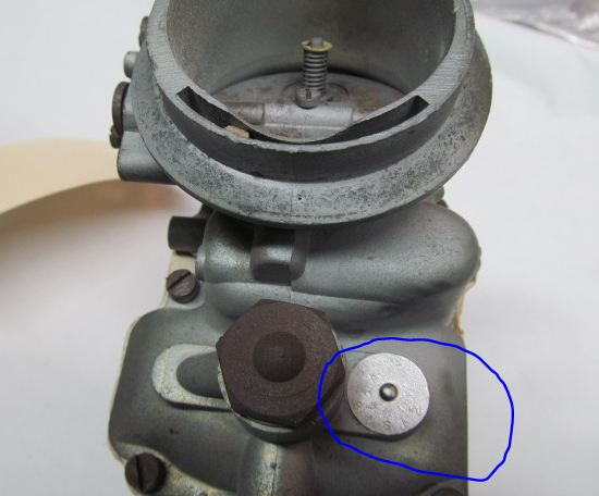

It might be 13873 if so you can search ebay for zenith 13873. on the carb look for a round disk or stamp. you should be able to see it without removing the carb, you will need to remove the air cleaner hose. If it is the 13873 there are carbs and kits available. If you are unsure of your skill level in rebuilding the carb I suggest just getting a replacement. If you get a replacement carb note that you may have to swap some of the levers and linkages from your old one to the new one.

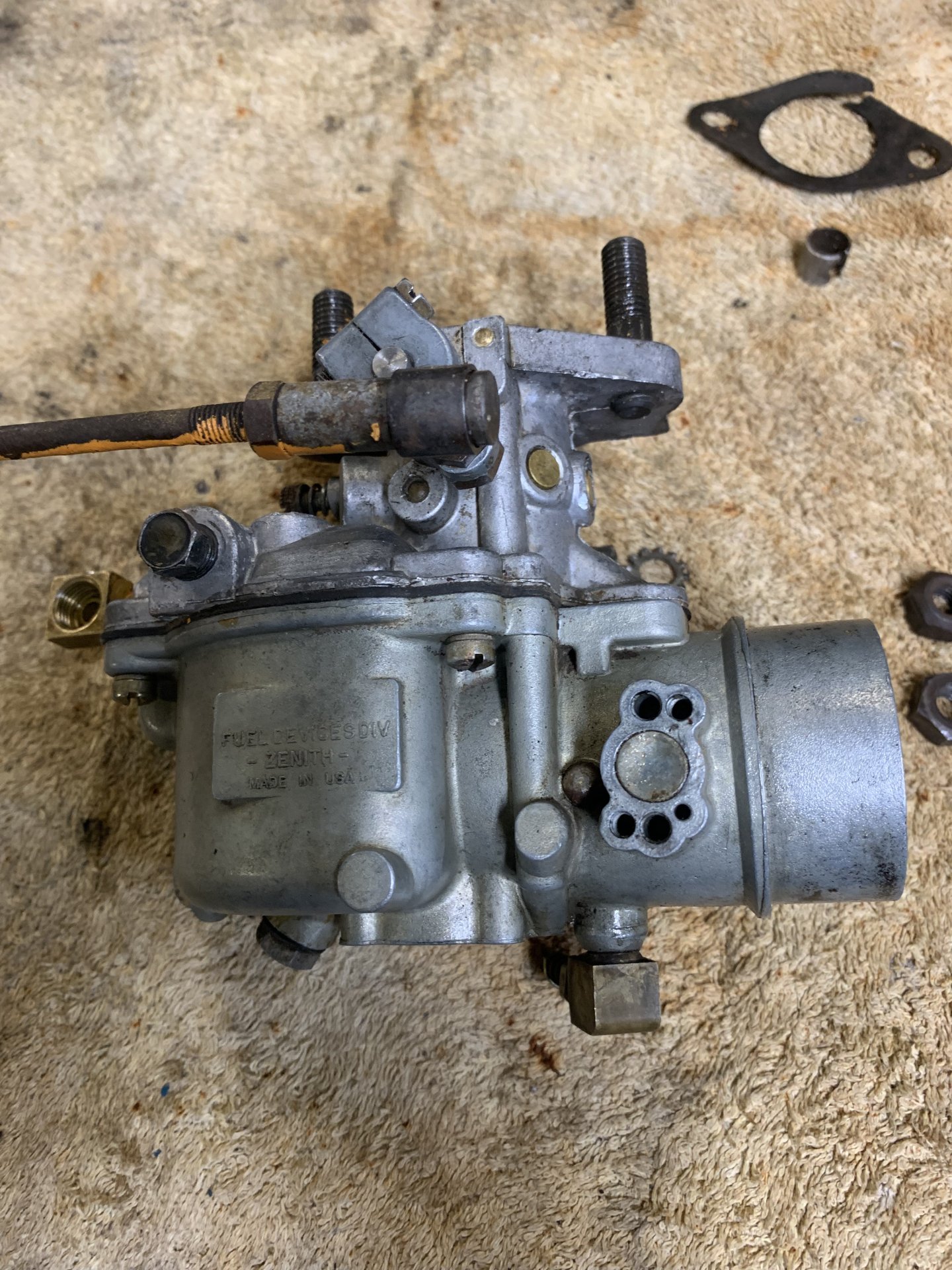

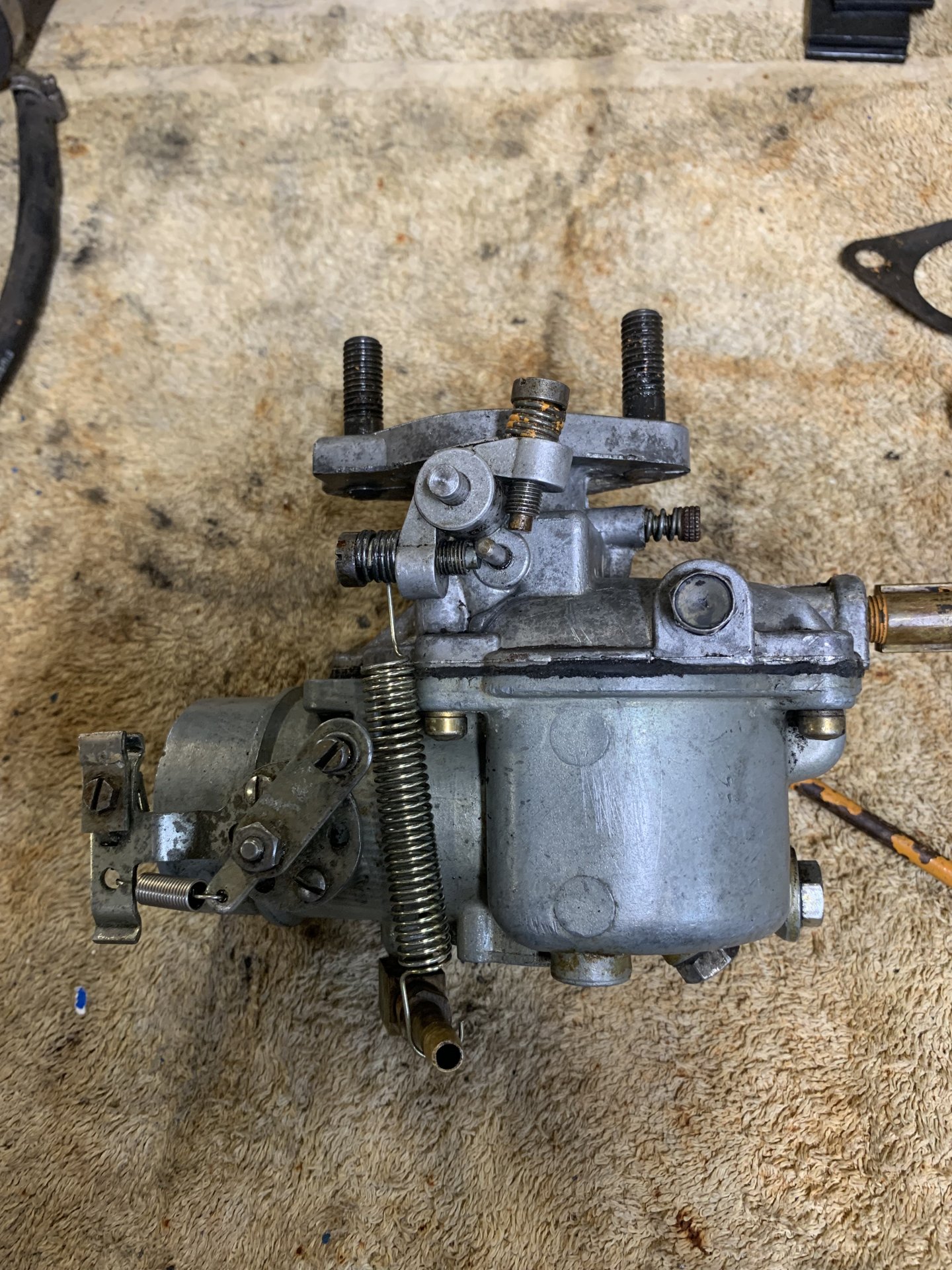

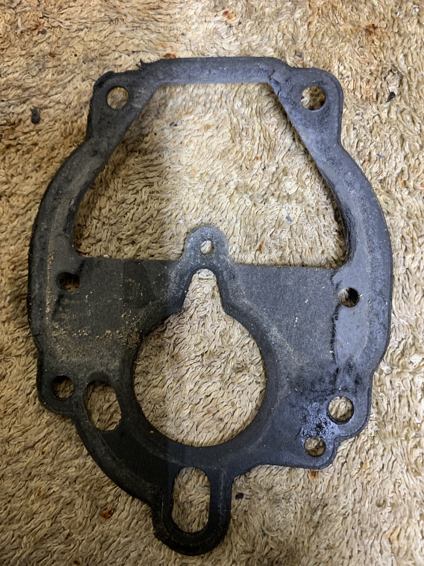

Update- with help from a friend we got the carb off. Unfortunately there is no I'd tag. Here are some pictures of the carb and main gasket. If any one can tell me the model number then I can tr try and find the right kit. It took two hours working thru the side but we got it finally I really appreciate all the help so far.
Check links below. These may or may not be what you need and even if it is a rebuild kit does not include every part in the carb. You really do need the number on the carb. The thing is I worry that you do not have the skill/ability to do the work. I don't want to be offensive, but you couldn't even take the carb off without help. I really recommend you find someone local that has experience rebuilding and identifying carbs. Good luck with your project.

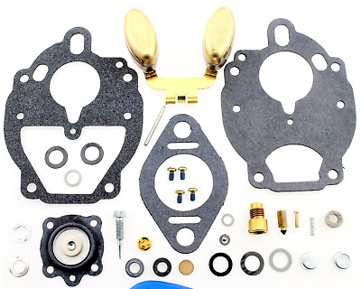

Anyway, based off the picture of the gasket you posted here are links to a couple kits, that appear to be a universal type kit that at least have gaskets that look correct.
As an eBay Associate we earn from qualifying purchases.
Do be aware with the links MIld Bill and I provided that you really need to get the correct one. The wrong one may give you the wrong Jet size. As I understand it Case liked to use a different size jet than everyone else. Hopefully the original one is marked, and you can compare that way. If not get some wire size drill bits and use those to compare. of course, you can only do that after you received the kit. If your original Jets are in good condition, I recommend just reusing them to avoid the issue all together.
Update – thanks to forum members. I located a universal kit that matched my gasket. We rebuilt the carburetor, primarily just a good cleaning job and replaced some small parts. We avoided. changing the Jets based on the information here and concern over using the incorrect one. Today we installed the carburetor and it fired right up and ran consistently. The machine is showing its age. but I'm over the first hurdle. Thanks everyone on this forum for all the help it is greatly appreciated. Now all I have to do is figure out while the lift arms aren't working I have bucket control, but no lift.
