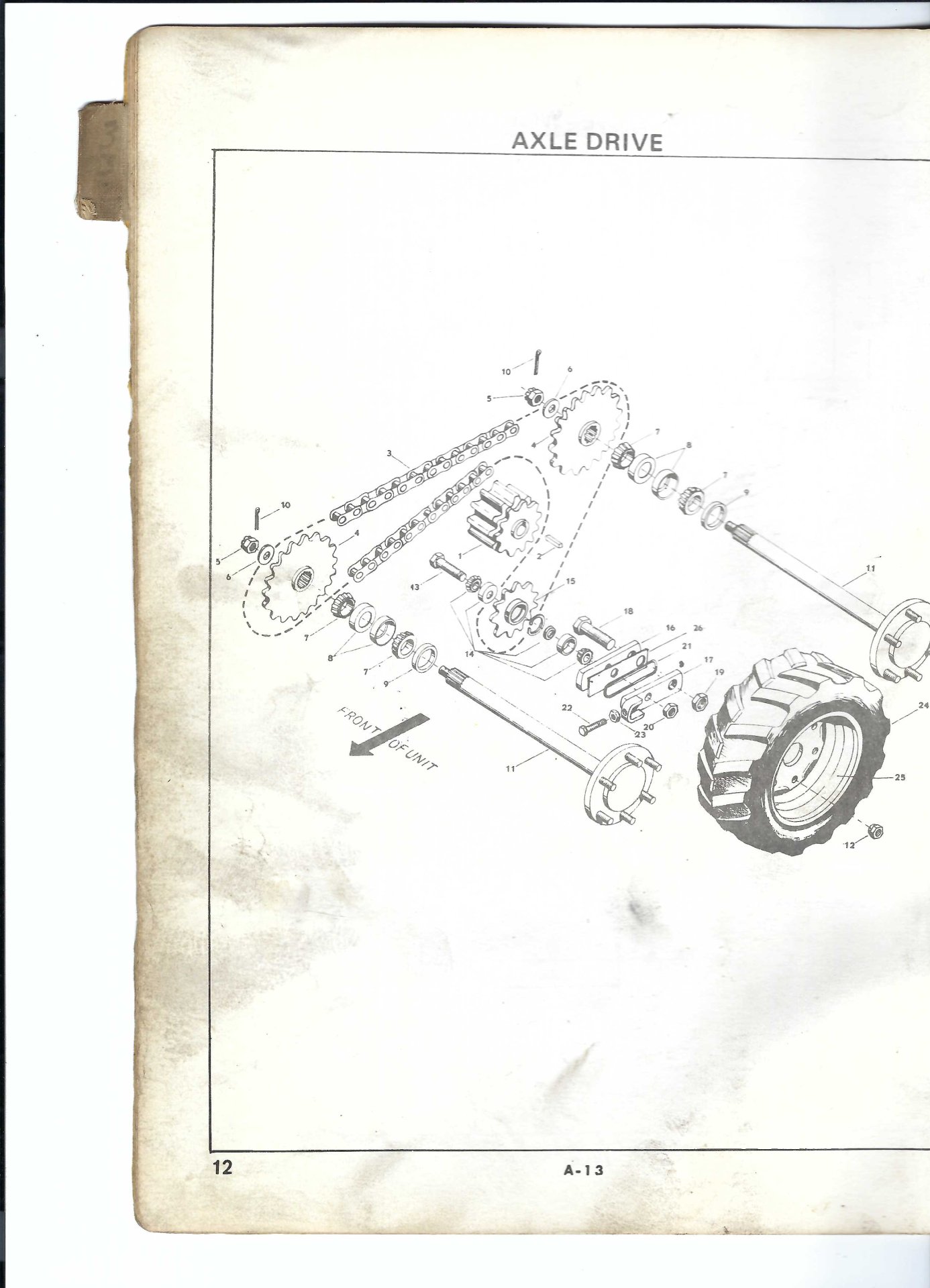

Do you have a picture of the parts to see the assemblyaxle #is 320-32587 sprocket # is 370-32115 seal # is 335-32152. Seal is Available not sure bout the sprocket or axle ,my guess is splines are out of the sprocket . a machine shop should be able to fix that if used isn't available
thank you for the diagramHere is a picture
Do you have whole parts diagram?Here is a picture
