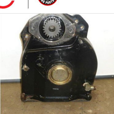

Hello. How to check the level in the gearbox if there is no dipstick? There is only a drain bolt and a breather! Transmission capacity is 0.95L 80W-90 GL-5? Can I drain the oil and fill in 0.95 liters through the breather? NewHolland LX656. Thanks. Gearbox example
I am not familiar with the lx565, but, isnt that a plug just above the level of the lower shaft on the left of the casing? I would expect that to be the level check plug.
