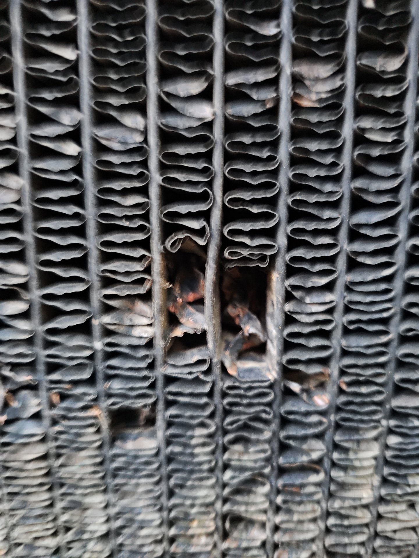

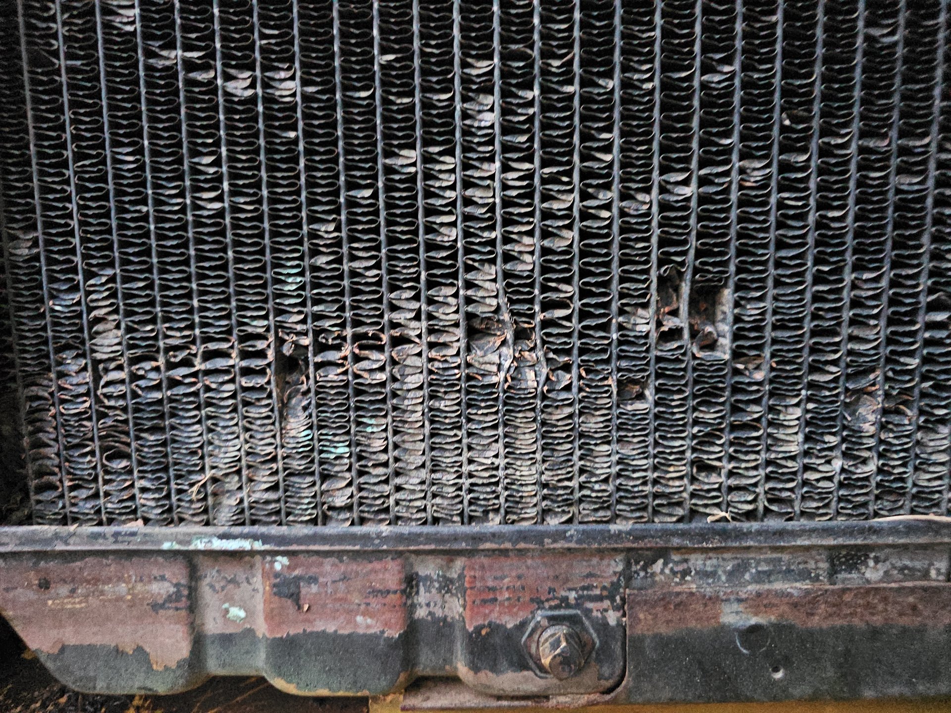

So I've been noticing mu machine getting pretty hott.. running today i got up to 255 within 30 minutes. Changed thermostat with oem, new gasket, no leaks, with same results. waterpump 2 years ago. I took the thermostat out completely and it's still saying 255 when running full power. Any help ? Running 50/50 antifreeze...
My radiator looks bad.
Fins and all are clean free from dust and leaves.
I ran it hard for 30 minutes and it didn't stop. I'm a little confused.
TIA!!!

- Did you check how dirty the fins of the radiator AND the oil cooler are AND the space between the two? From the outside in, there is the radiator, then a space, then the oil cooler, and finally the fan. The fan pushes air from the inside out and I have seen oil coolers get plugged up from the fan side with gunk and debris. Also, the gap between the radiator and the oil cooler will gather debris and block air flow. You can check it by pulling the two levers on the side of the radiator upwards & backwards. This will move the radiator back 3 inches or so so you can see between the two.

I have slid the radiator out and cleaned leaves out and sprayed out. Maybe not good enough.

Check the fan side of the oil cooler.

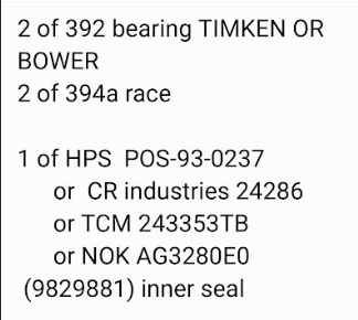

Wheel sliding--in & out would be snap ring off the inside; forward & backward or up & down is bearings--would require bearings and seal(s). Don't keep running it. It will ruin the castings & shaft. If you're mechanical and want to rebuild the axle(s) (check the others) yourself I can give you the bearing manufacturer's numbers and maybe the seal too. I buy them off the internet and save money.
Yes, sir, it is sliding in and out the up and down and back and forth is fine. I called my local new hauling dealer. They want three hundred and nine dollars per wheel 4 the Rebuild kit. Grease is coming out the casting around the rear of the hub. The chain and sprocket look brand new
If it's in-out it may be just the snap ring broke and you may need some new/additional shims (items 22, 24, or 25). The snap ring (item 23) takes a pretty good set of pliers to handle it. You can get those NH part numbers here:
https://www.messicks.com/catalogs/n...4-09-99/no-d-no-description/06b01-final-drive
If you want to do the bearings and seals, here are the numbers for items 20, 21, and 19. If you hunt the internet you'll find them cheaper (I used to get the bearings from Autoplicity). The outer seal 27 and wear ring 17 is NH specific numbers. Either get them from NH or google the numbers and you'll find other, cheaper sources.
This is using the normal seal. I didn't find the heavy duty seal to be worth the extra cost/effort for me. It replaces the outer seal and wear ring and you pack the outer wheel bearing with wheel bearing grease and no longer use the grease zerk.
