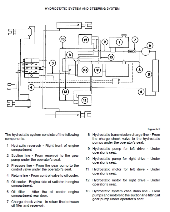

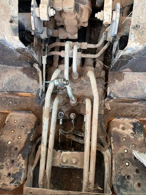

Hi!
I have a 1999 New Holland LX565 skid steer. All of the hydraulics work fine except for the tilt of the bucket (up extremely slow – down is working better but very slow ). The lift arm work fine.
>> it operate better/normally when both pedals are being used at the same time<<
I wonder if the return line could have problem? That might explain why it will work with both pedals, one would be open to be used as return.?? How to check it? Any ideas?
Last I do:
> i change filter and Hydraulic Oil
> I change (after I recently break them) the hydraulic hoses from the bucket line
> seat belt and seat pressure don t lock any movement
> no error/fault code in the display
What would be the best way to check for restrictions in the line and fittings?
I attach MANUAL REPAIR LX565 and pictures :
Thank you for your Help!
Regards
