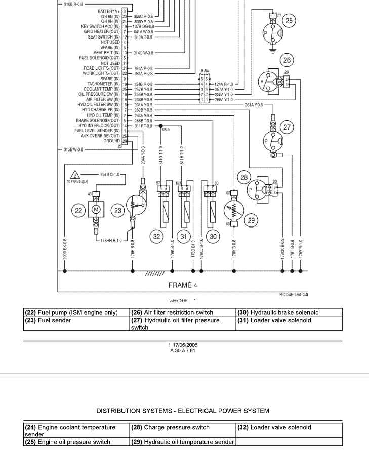

Is it physically preventing you from moving the pedals? If so, must be electrical. Odd that ground drive or (sometimes) fuel solenoid is not dropping out too, #31 & 32 are the lockout solenoids. Issue must be with wires going to them or grounds associated with that circuit. Believe there's a ground near bottom of RH front cab post. Think you have to take fender off to find it. That's probably the closest one physically.

I tried service mode, the controls did not work. I just cant figure out why boom is locked, but the bucket works.
On the LS185.B & L185 with the newer in-line hydro pumps, if the seat belt or seat switch fails/looses connection the park brake should come on, lock up the ground drive and beep. If that's not happening or you don't see the park light or seat belt light, I don't think the problem is coming from those circuits. (Although they frequently do cause problems.)
ordered a new door switch, i remembered that if the door switch is not depressed/ or gets knocked outta place, the skid steer will have bucket functions but not boom functions. also going to replace seat switch and harness as previous owner cut off the end and wired them together. still doing the same thing. on startup everything works. raise and lower boom two times and it locks. still have bucket tilt.
