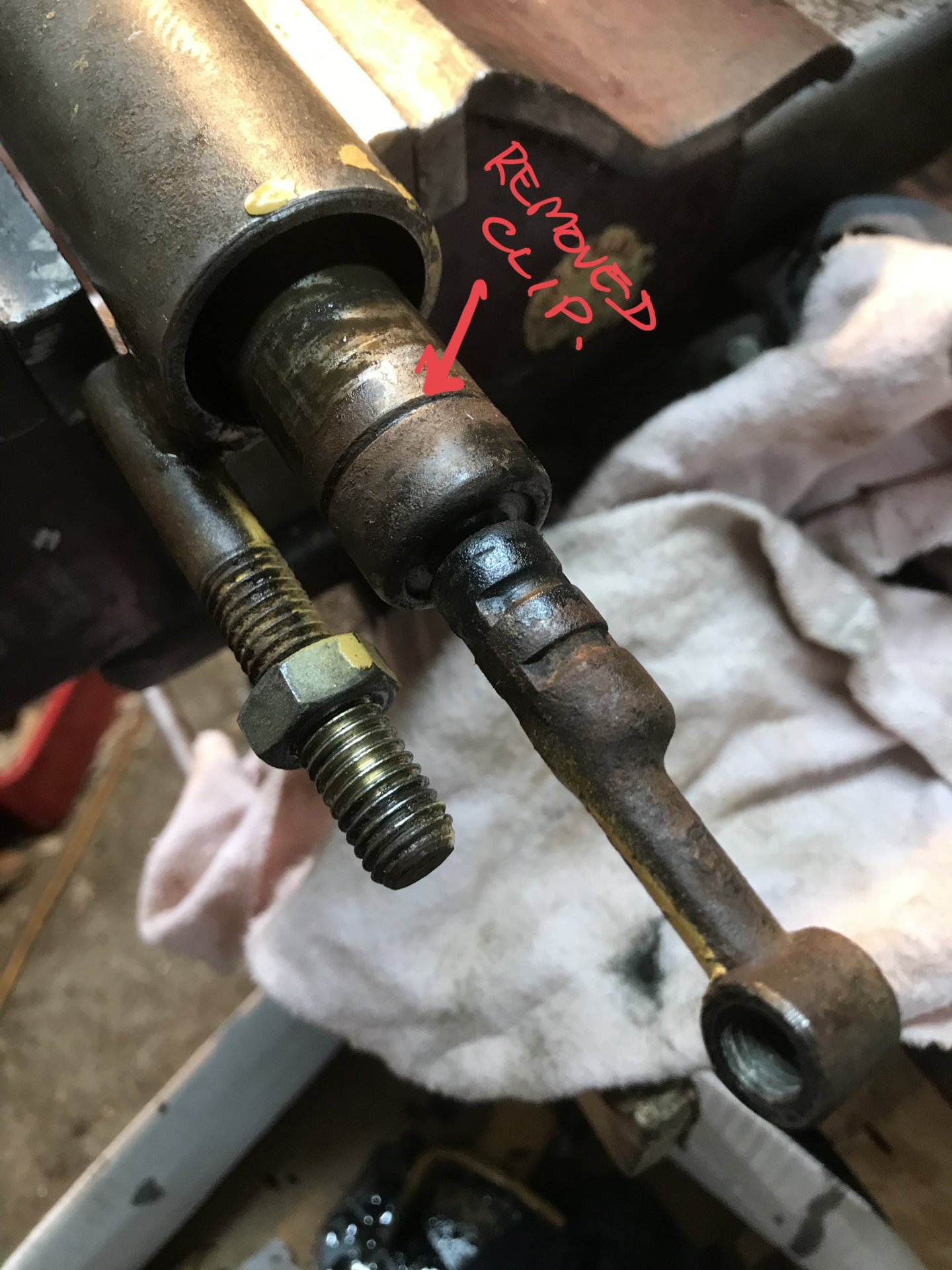

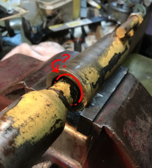

I removed the right steering shock and discovered it has only 15mm (3/4”) of travel compared to 40mm on the left shock. Using the parts diagram and Mike10’s instructions elsewhere, I attempted to remove the shock from the housing. However, I cannot see a retaining ring at the fat end of the assembly and I suspect it has somehow ended up inside the housing, preventing the shock shaft from returning to neutral or extending to reverse.

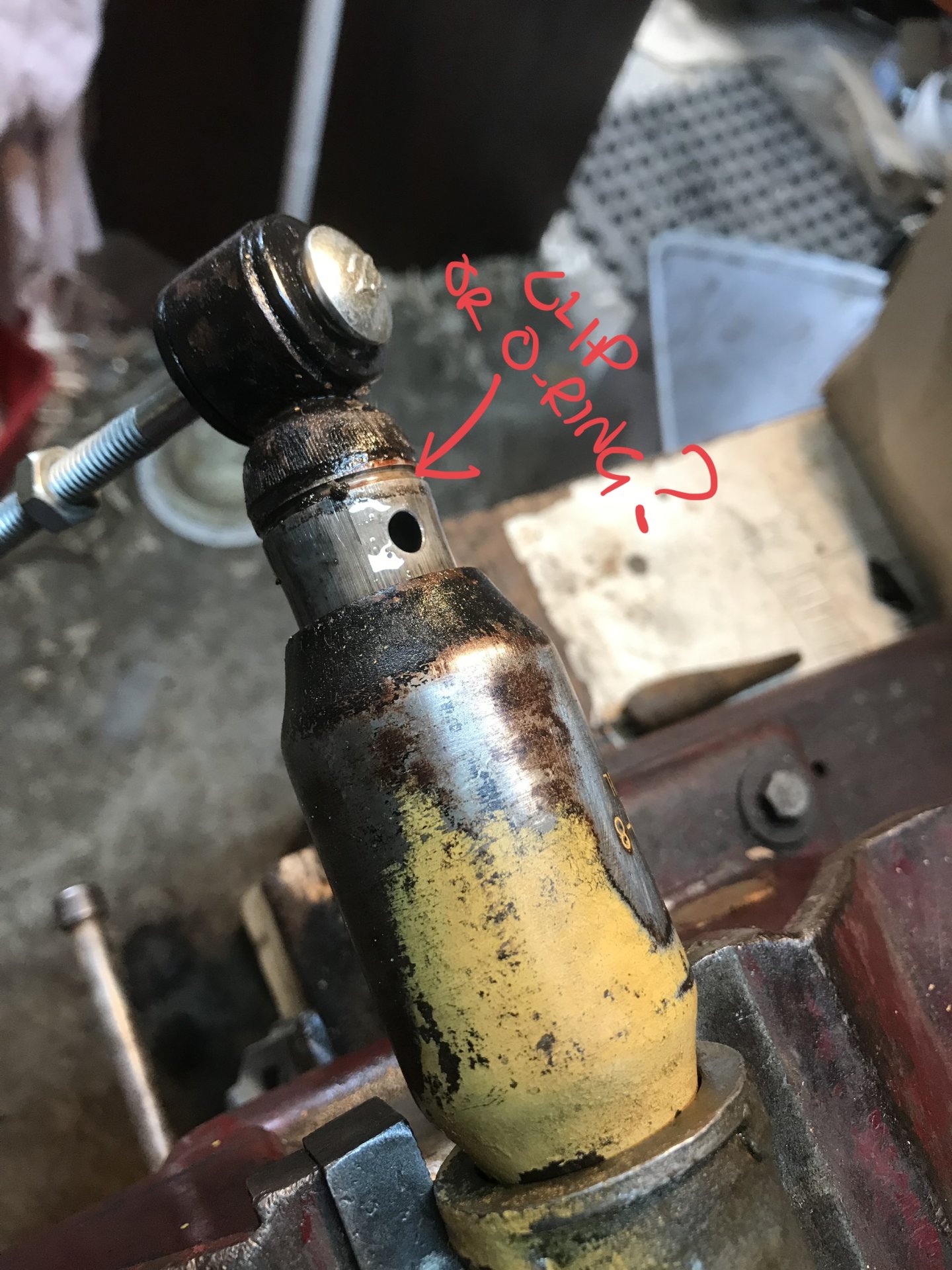

Whilst trying various methods (brute force) to extend the shock, something gave way, the barrel came loose and the shock drained. There are two groves in the shaft which were, presumably under the barrel - either clips or o-rings?
I assume the shock is now beyond hope but, if even I get hold of a replacement, I still can’t see how to get the old one out of the housing.
