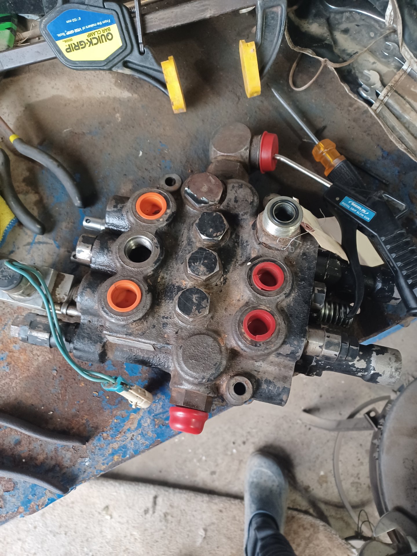

Now when u say valve, do u mean spool valve or relief valve. We took the valve control off last night and took it to hydraulic shop to get new seal done, thier was some water in the system milky hydrolic fluid.
Ok we got the valve control back and i did a air pressure test and got one of the caps blew right off with about 15psi. Iam thinking some this wrong with spool or the hole vlave body?
