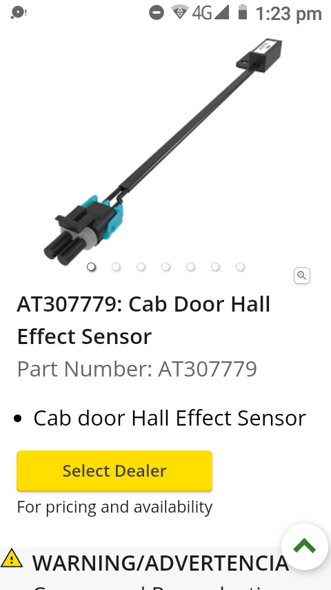

According to John Deeres website the 260E & 260D have a hall effect door sensor
I would check that first, you can bypass it with a piece of wire looped
