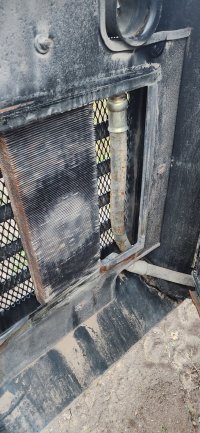

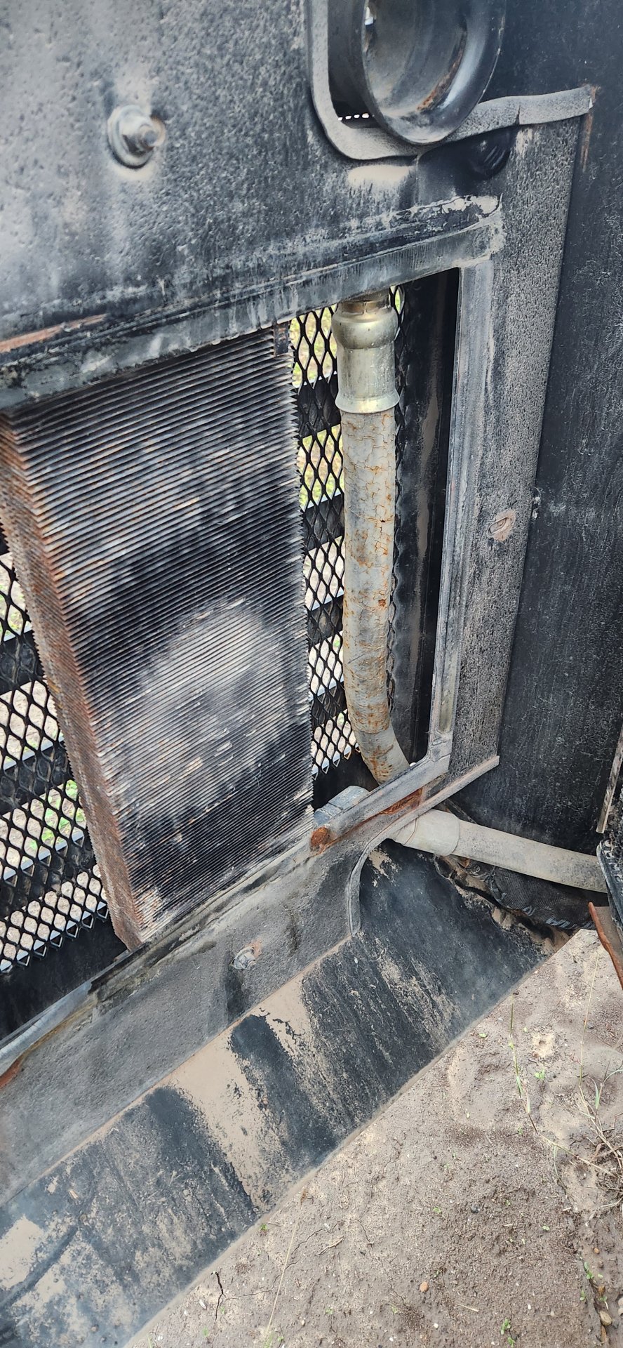

Hi Foton, that's a great suggestion! However the cooling system has a separate cooler on the back of the radiator unlike yours. It does have a belt driven fan to cool both radiator and attached hydraulic cooler. I never thought the cooler could be plugged or restricted lowering the flow/volume to cool. Now you got me thinking if this is an original setup from the manufacturer. I'll have look into further. Next time I run it, I'll check with a infrared temperature meter. Any other info would be great! Tks!
Oops, my bad the cooler is attached in front of the radiator on the access door. Here's a pic the hoses going to it are at least and inch in diameter as u can see.
