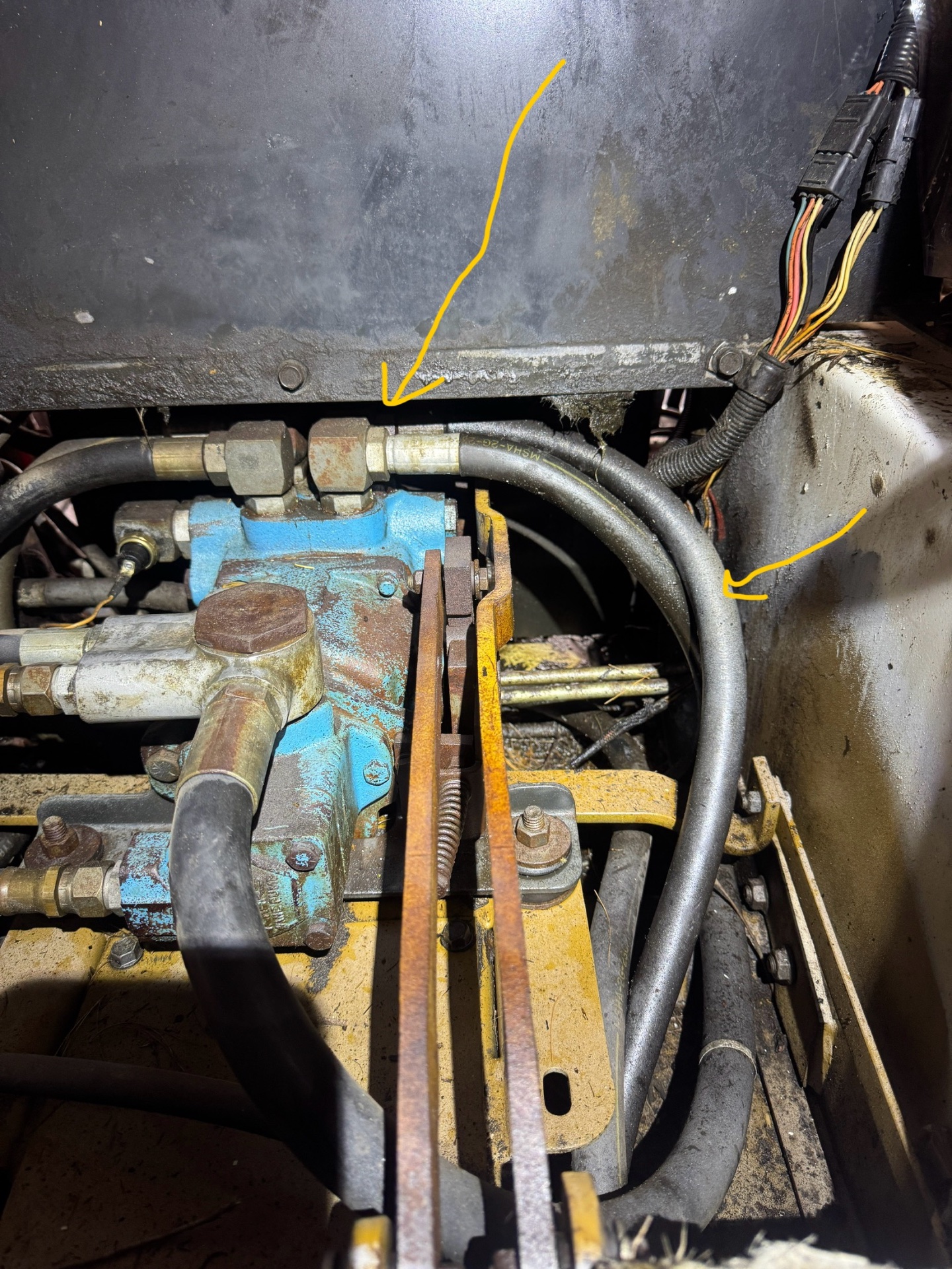

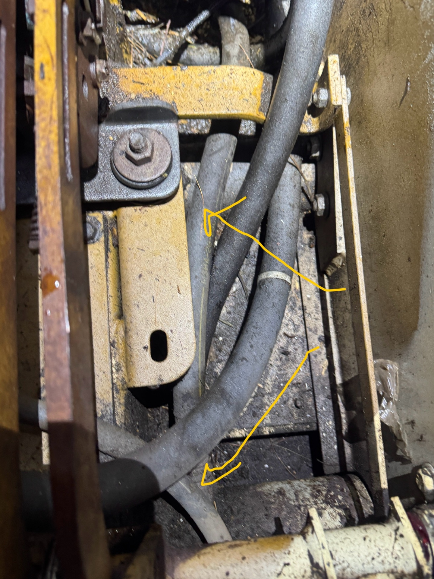

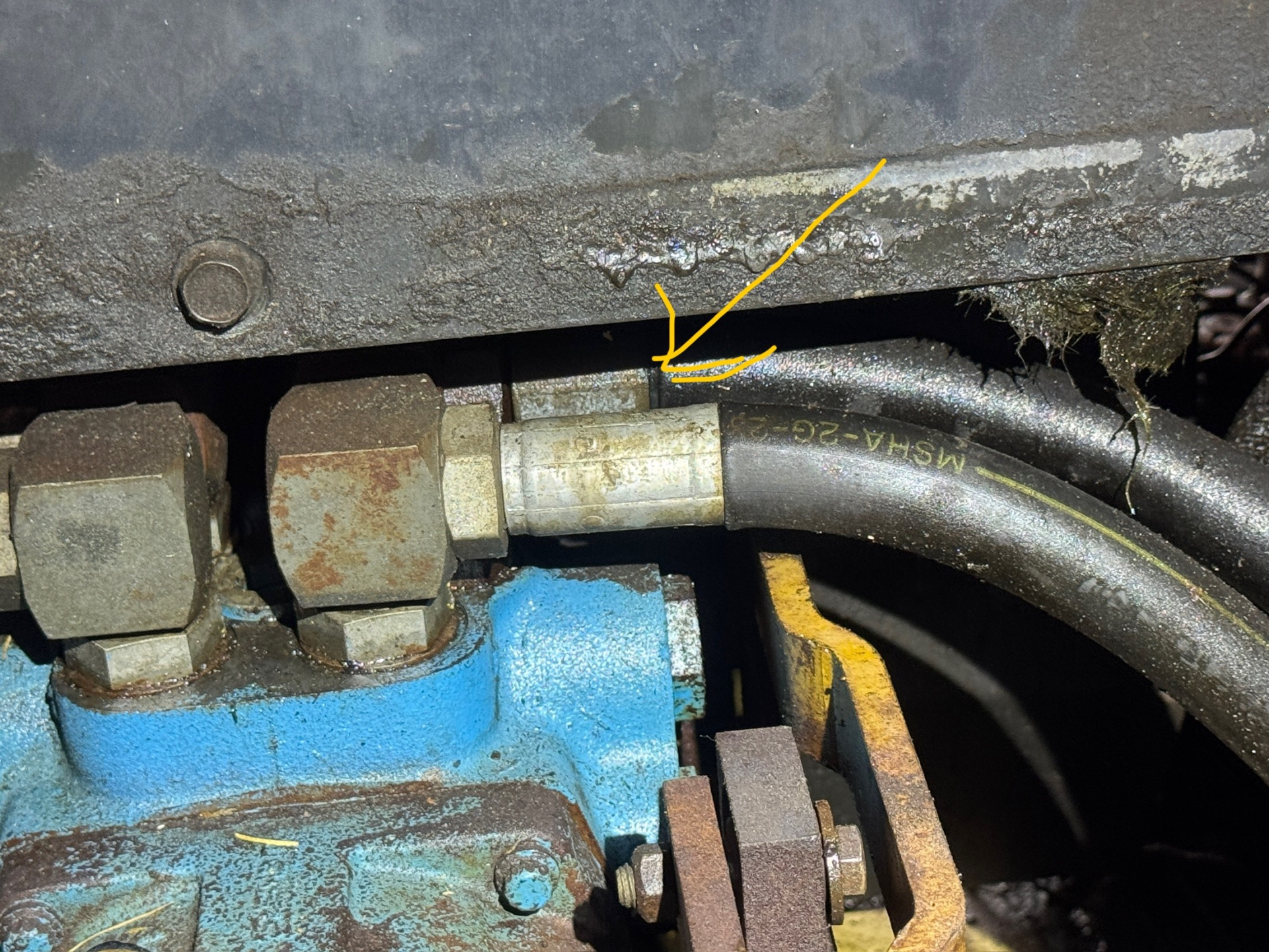

I have a Bobcat Clark 530, and one of the four hydraulic hoses coming off the pump is leaking significantly. Could anyone provide guidance on the correct replacement part or part number for that hose? Any idea on what size wrench(s) I need? Also, I'd really appreciate any pro tips on safely removing the old hose and installing the new one.
Thanks in advance for any help!

Here is a link to the parts catalog:
https://partscatalog.bobcat.com/
You need to make sure to clean the areas around the hose so no dirt is introduced into the system.
You will want to plug or cap the holes for the same reason. You can do this with actual caps and plugs or plastic and rubber bands.
The best way to get a replacement hose is to find a local shop that makes them. Take the old hose in and they will match it. A lot of farm stores or even automotive stores like NAPA will make hoses.
Part # 6557647
Hose is not longer available by Bobcat, bets bet, take it off and go to a Hydraulic Shop
