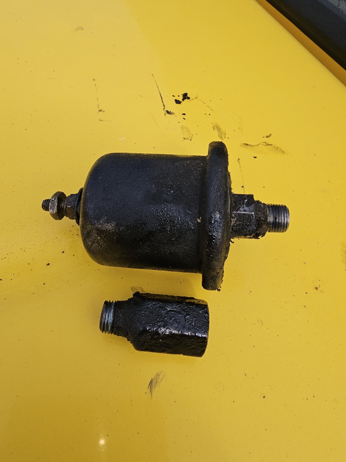

Looking for a hydraulic pressure sensor part # for a bob cat 753 that i cld pick up at a automotive parts store. Its on the right side of hydraulic filter and just has a stud type terminal.
Like this

Im not sure, I'm having no luck finding this type of sensor. Maybe someone has changed it.
That looks like something that was swapped out aftermarket.
I believe the Bobcat part number is 6660260. Does not look anything like your photo. It’s $67 from Bobcat. But go to the parts catalog and enter your serial number and search “pressure”. Look for the oil filter page and check:
