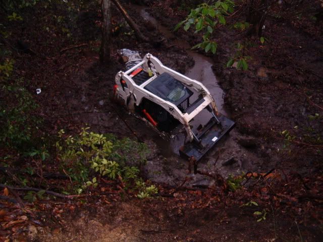

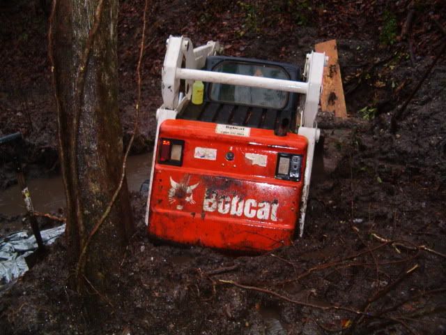

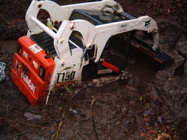

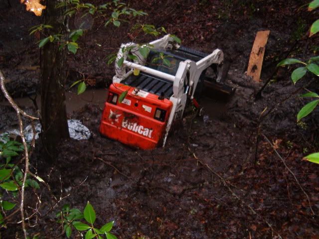

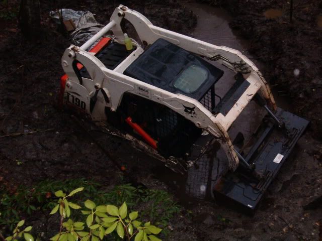

TriHonu, very good points. I just went down to take some pics. The water level at one point (before the trench was dug) was above the fuse/relay box. Unfortunately, it has rained again and now the water level is a good foot and a half now it looks like.
Ok, so I guess image tags don't work on here, here is a link to the gallery with the pics: http://s16.photobucket.com/albums/b26/Camshaft2/Bobcat%20Fiasco/
WOW!!! Sky Crane? Buy the skid steer and call it art? Sorry not much help, I'm jst glad no one got hurt riding that down the hill.. Would have been horrible if it had rolled and gone in upside down. Perhaps if there are some profesional logging equipment opperators. My wifes uncle used to tell a story about a D9 Cat sliding off a barge into the lake wehn he was logging in the pacific north west. They strung a cable accross the lake ran another cable from that down to the sunk Cat and hauled it back up and onto shore.
If it wasn't so wet I don't think the problem would be as severe, but the rain I believe has caused the no run situation (maybe if it's something in the fuse box) and makes it hard for other equipment to get to it/pull it out. I'm thinking that maybe if we cut that tree down that is behind the bobcat that another machine could get a long chain and pull it backwards from a spot with more traction. It's a bad situation and unfortunately I can't even laugh at it. And yes, it could have been worse if he had ended up upside down.....probably be dead. Honestly if there's a sky crane that can lift this amount of weight it'd probably be the fastest/easiest way to get it out, but I assume that'd be $$$ which we don't have. Cam
