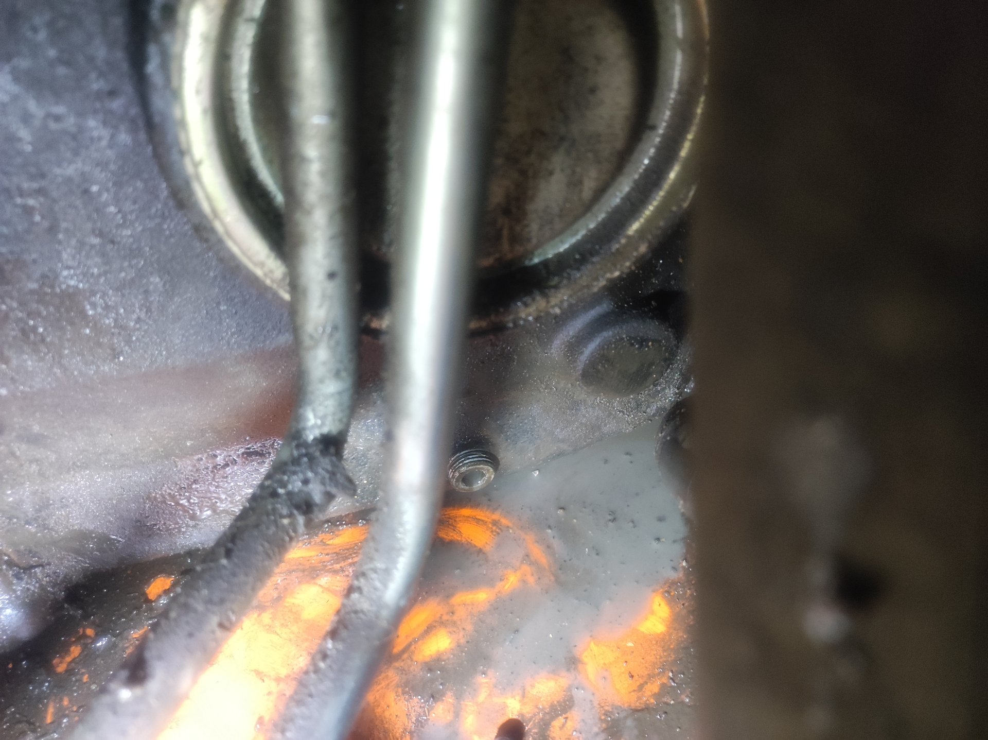

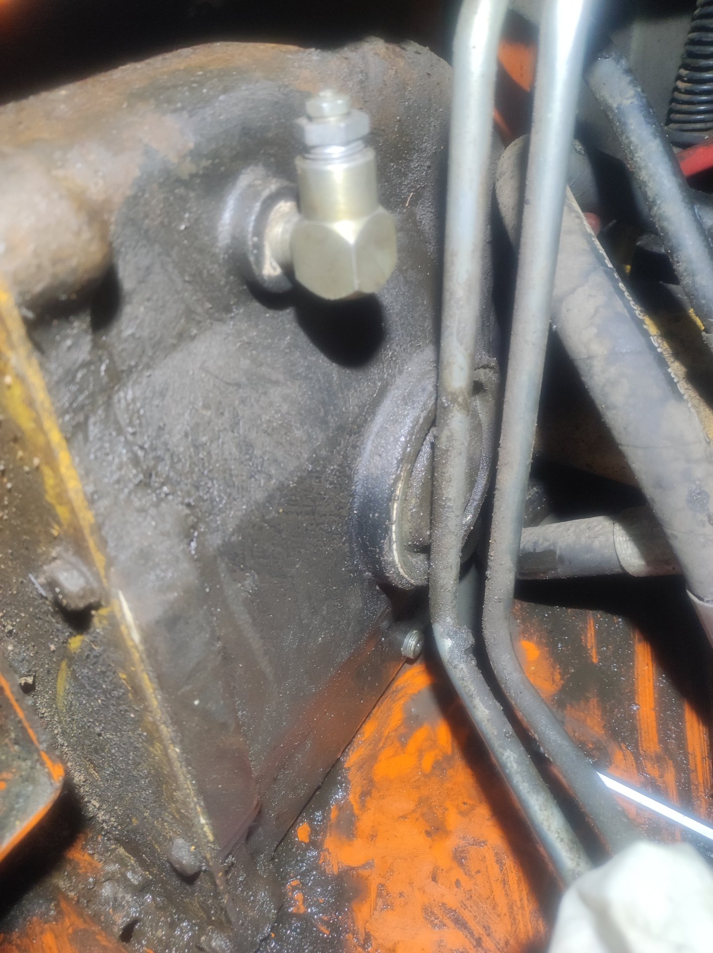

Hello. How to check the level in the gearbox if there is no dipstick? There is only a drain bolt and a breather! Can I drain the oil and fill in through the breather? Transmission capacity is 0.95L or 1.9L per box 80W-90 GL-5? In the manual they write two values. NewHolland LX565. Thanks!

In your first picture under the round plug at about 5 o'clock- is that a plastic cover over a pipe plug? Mine has a 45° 3/8 pipe elbow with a hex plug in it to fill the oil.
