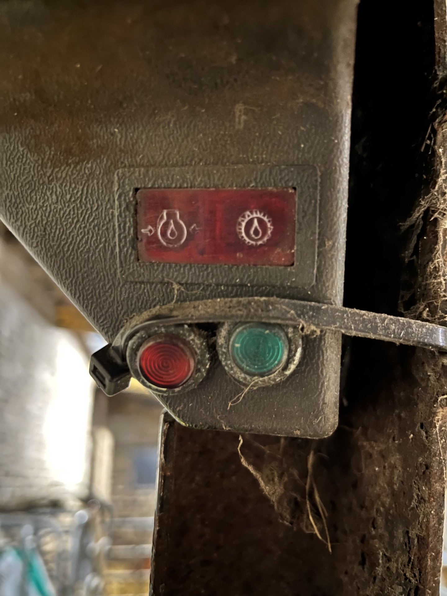

To start with, inside the cab top righthand side there are two warning lights, one red one green - please see photo.
Does anybody know what the green light indicates when lit?
When I start the engine the green light is permanently lit, the Bobcat will not move either forwards or backwards, there isn't any movement whatsoever from either leaver when pushed or pulled. The loader will lift very slowly but it's very jolty. When I then lower the loader back down to the floor fast the green light goes out and for about 10 second the whole machine works absolutely fine, moves forwards and backwards on both leavers and skid steers, loader works fine, but there is a loud groaning noise coming from somewhere under the seat (not the engine) when the machine is moving. After about 10 seconds the Bobcat gradually stops moving on either leaver and the green light comes back on. If I then lift the loader again and then drop it the green light goes out and it moves for another 10 or so seconds.

I was just looking at the parts catalog and those two lights look to be aftermarket. Do the lights above those two still work?
My guess is that the two added lights were to replace the two above. I believe the one on the right (green) would be your hydraulic pressure low indicator. The one on the left (red) is your engine oil pressure low indicator.

Regarding the green light on our Bobcat, it does indicate low hydraulic pressure and it is a replacement for the factory fitted one above it which no longer works. My friend who's an auto electrician had a look at the wiring behind the lights and confirmed it.

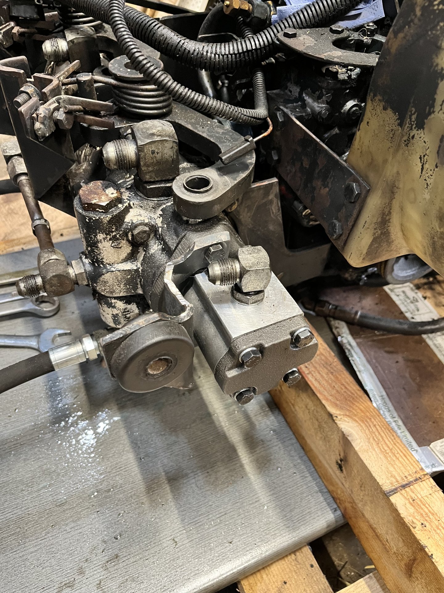

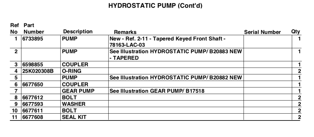

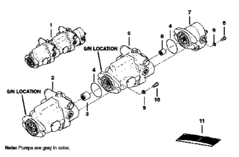

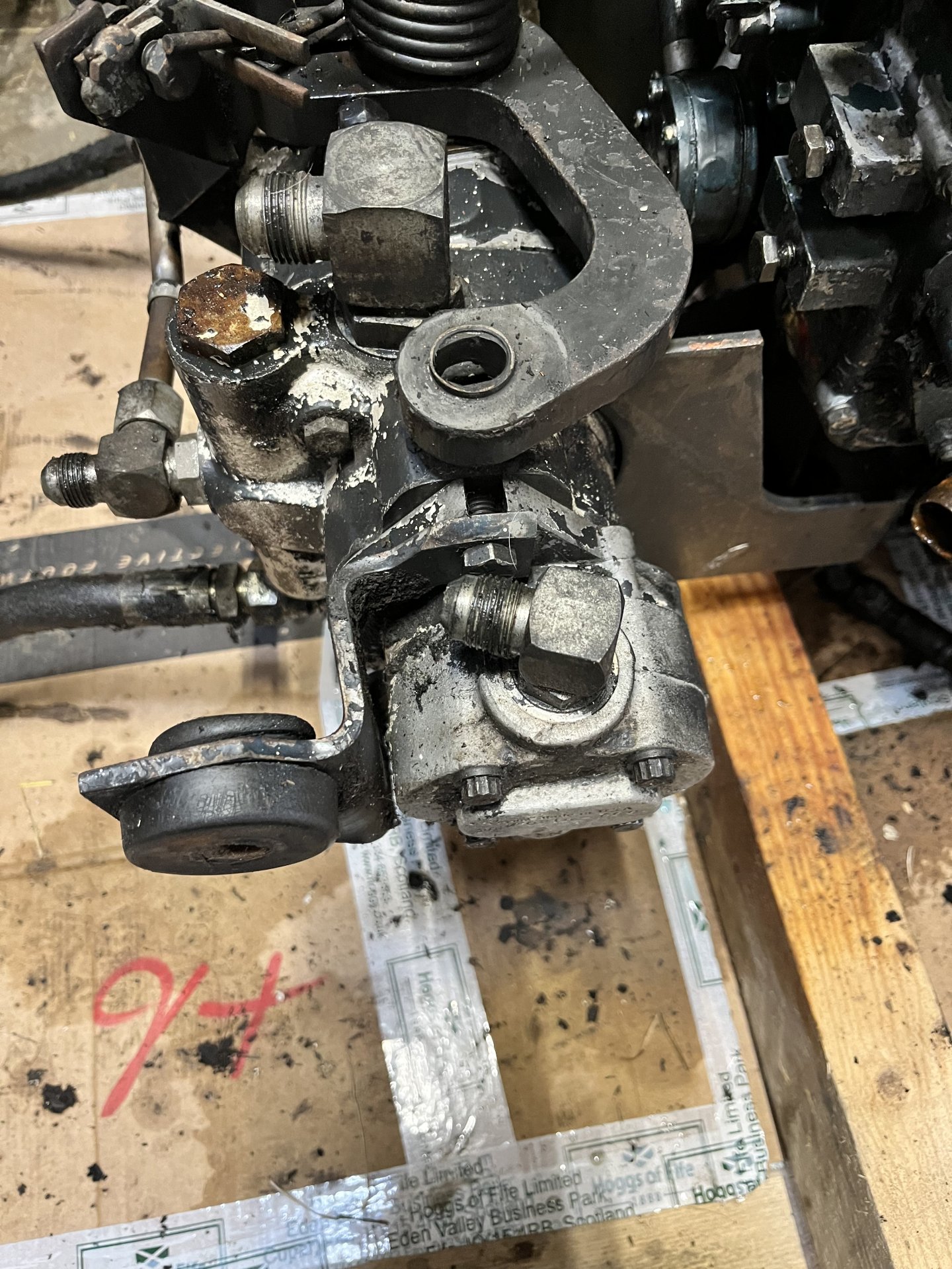

When you say our issue could possibly be a worn out pump, would that be the gear pump that is connected to the end of the two hydrostatic pumps? See pics.
Is the gear pump the main pump for both the hydrostatic pumps and also pumps the oil for the loader? I don't really know how the whole hydraulic system works on our Bobcat, whatever the issue is it is affecting both the steering and the loader.

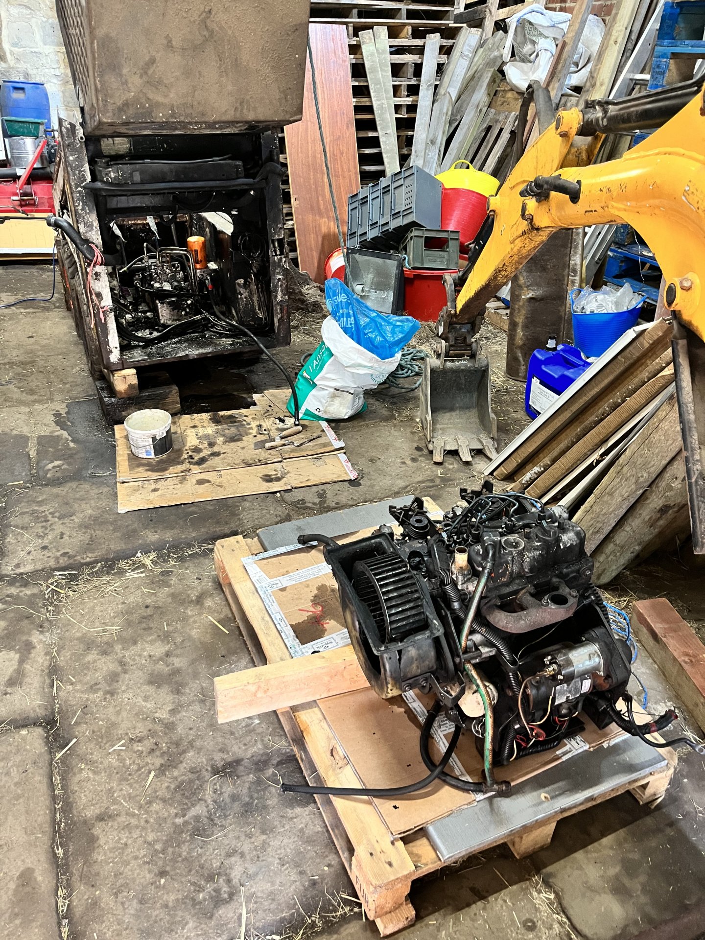

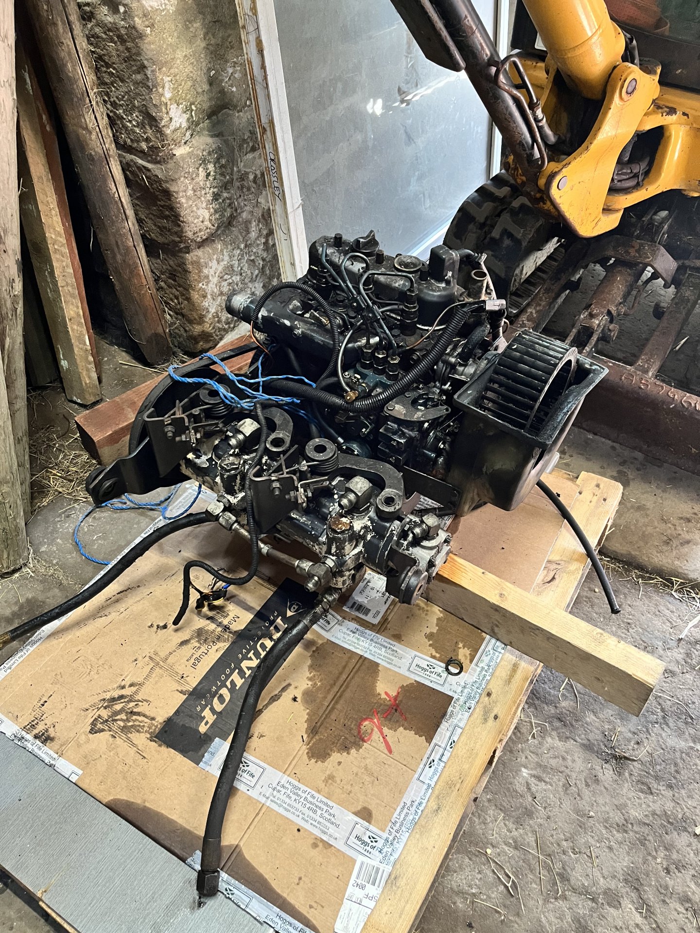

Hello there. Just thought I'd send a message to let you know what happened with our Bobcat, the issue turned out to be a worn out gear pump. We had to completely remove the engine to get access to the gear pump, the replacement pump was slightly bigger than the original so we had to cut a hole in the body of the machine to make space for it to fit. Popped the engine back in and so far so good, the Bobcat is working fine. Thanks for the advice you gave me a few weeks ago, it's much appreciated. Martin.
