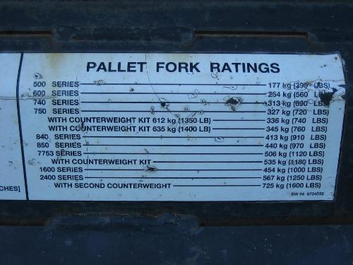

Also remember that you plannig on putting that weight a good distance in front of your loader. Pallet fork ratings decrease significantly at 24" in front of the quick attach. just over half. Tipping load for a 773 30" in front may be as little as 1500lbs
