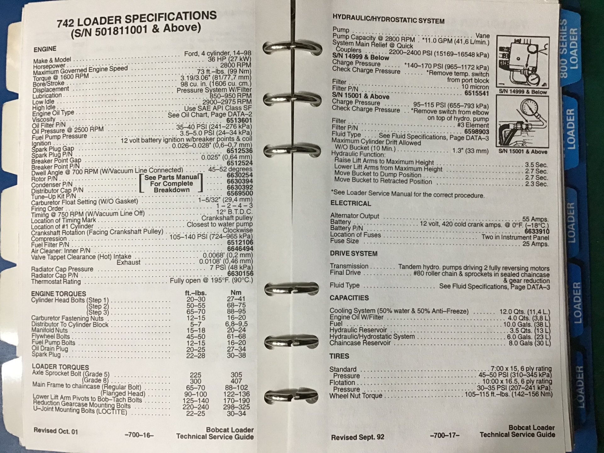

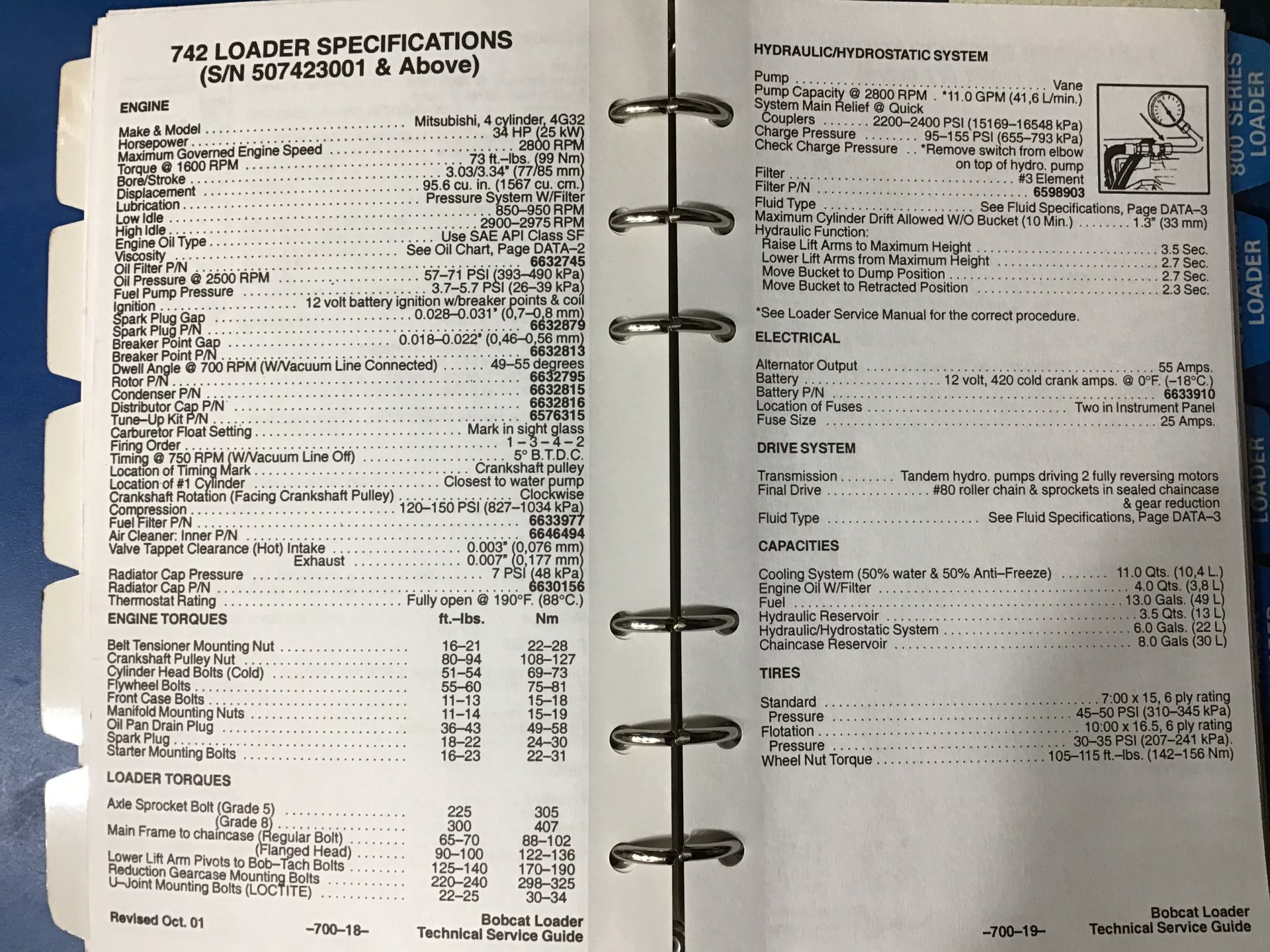

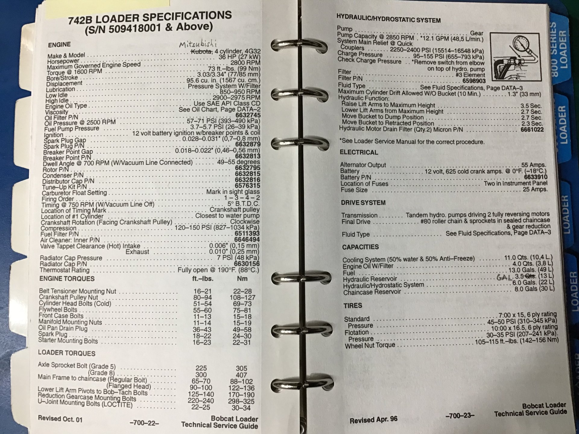

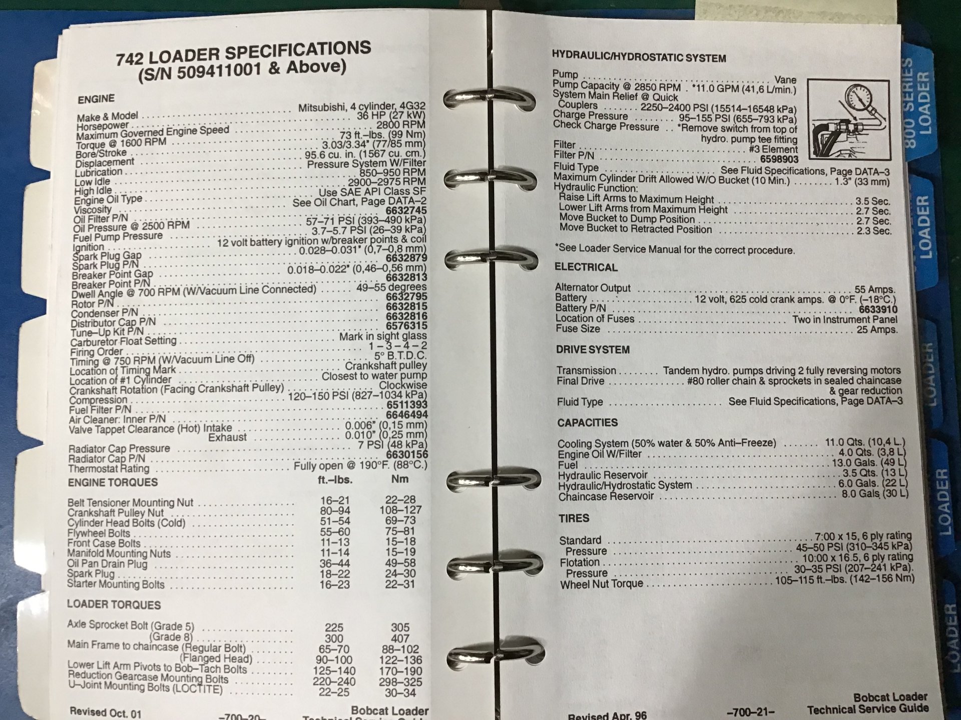

I have this manual that covers maybe all Bobcat loaders and 320-341 excavators up until at least 2001.
It has all the specs of each machine.
If anybody needs these I can take a photo of the pages you need and post them.
Attached are all of the pages for ALL of the 742 models since there seem to be a lot of posts about 742s lately.

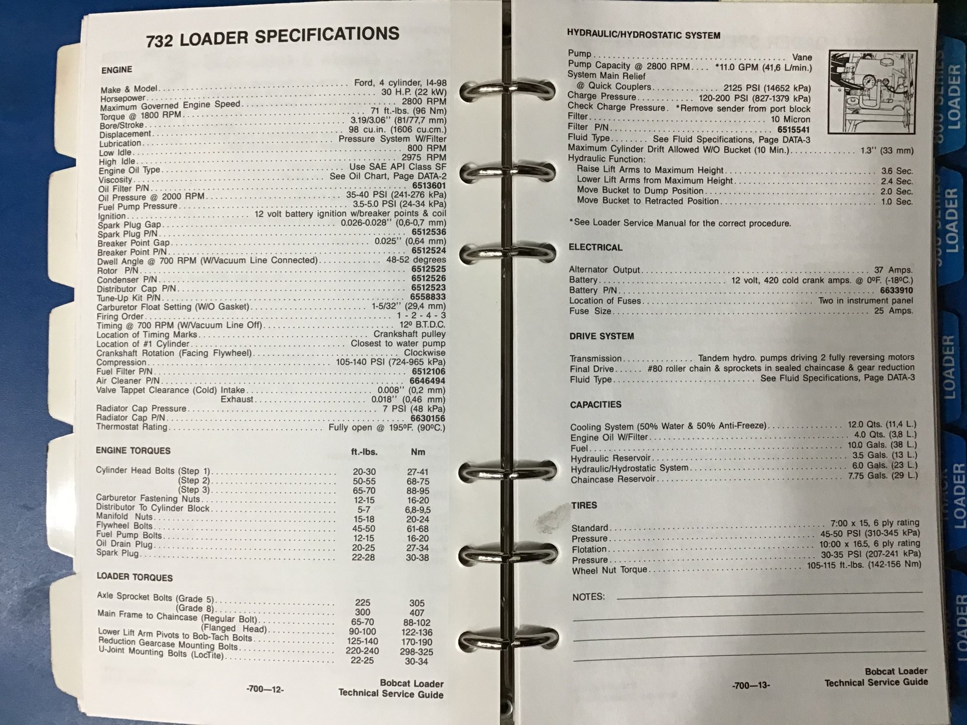

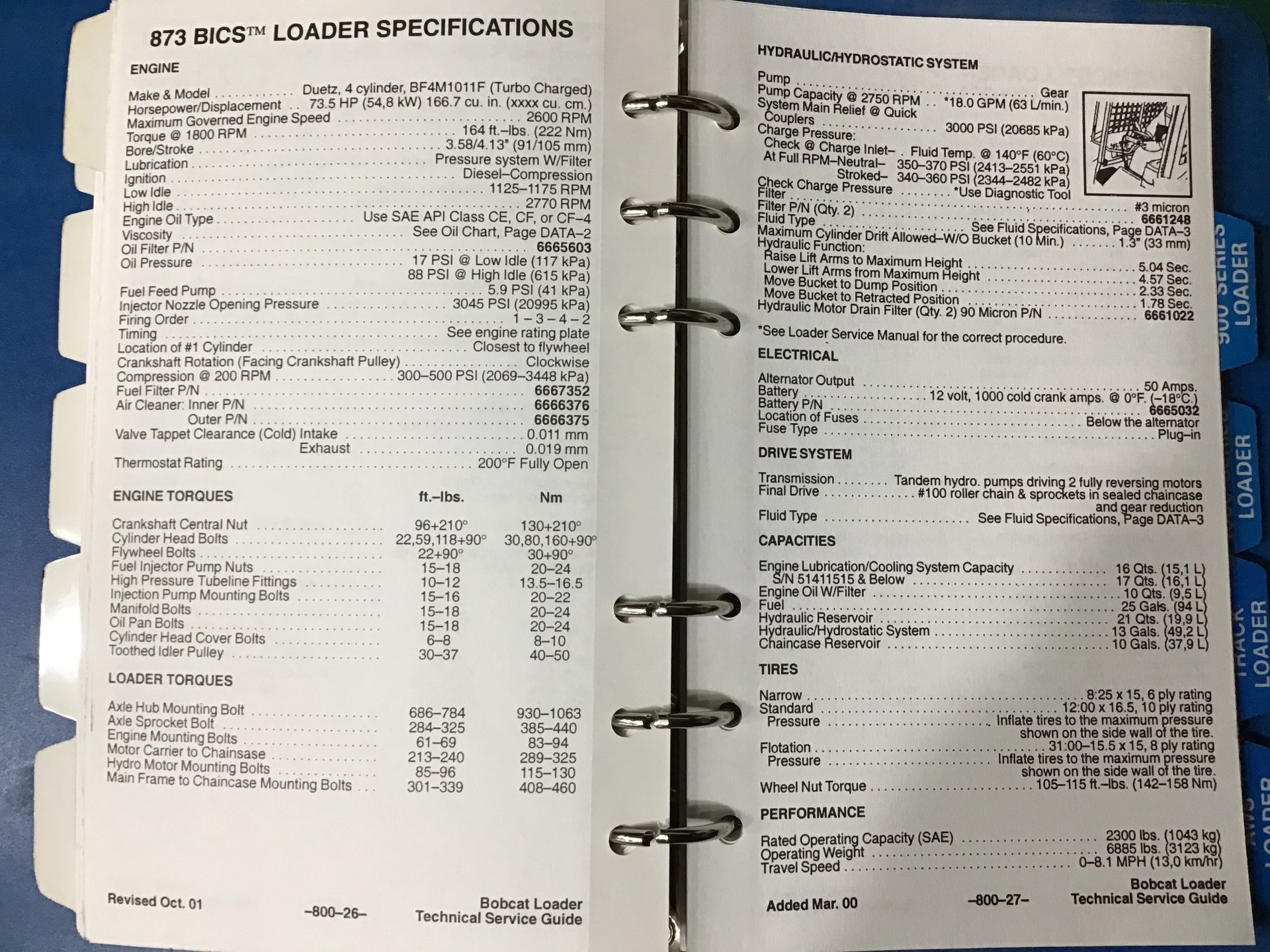

I got it on eBay years ago with some other Bobcat training books.
Attached is a copy for your 732 and all pages for all the 873 series.
