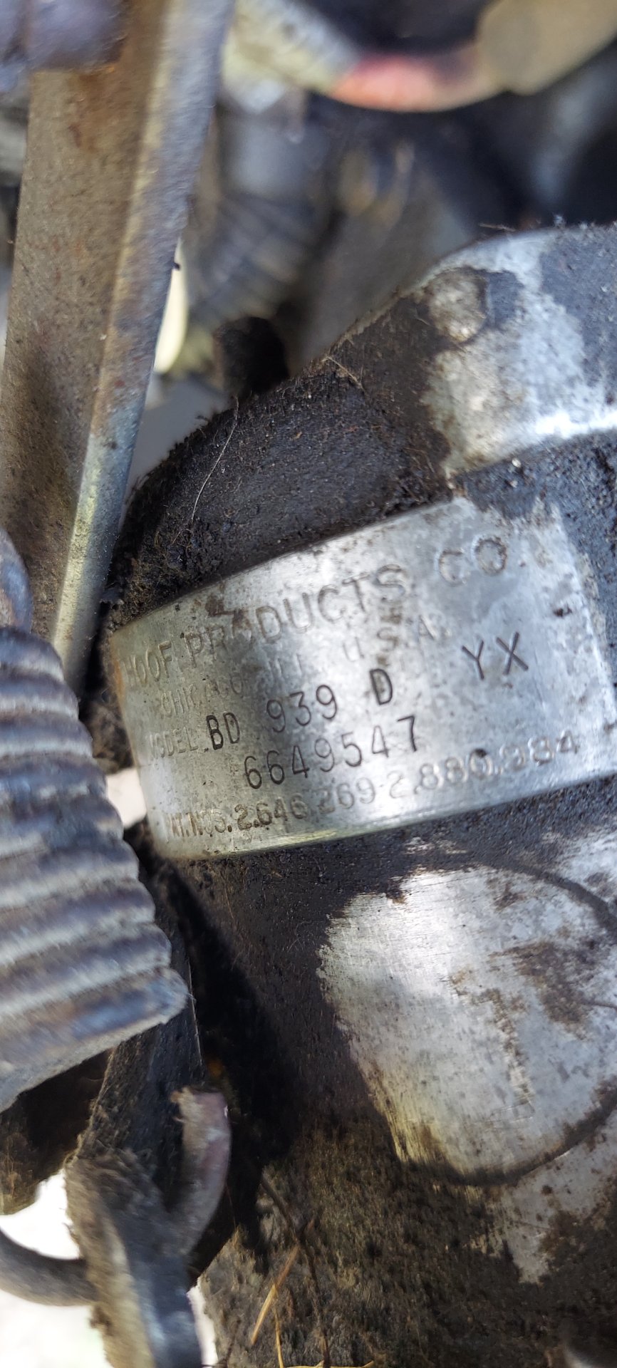

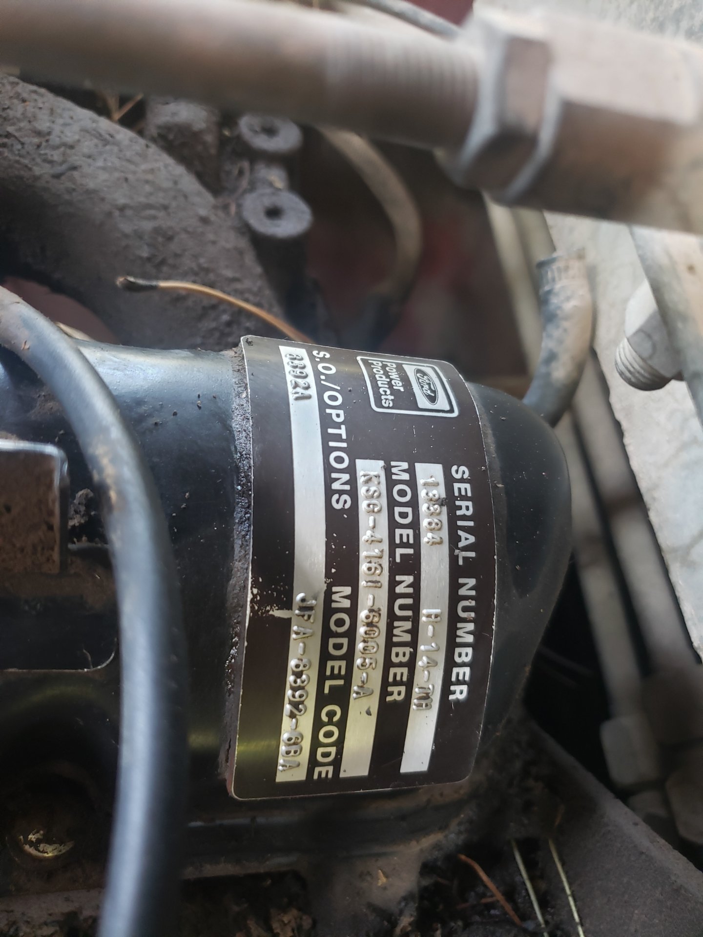

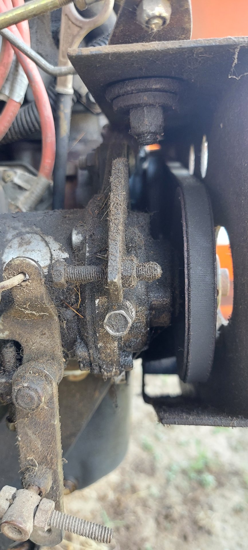

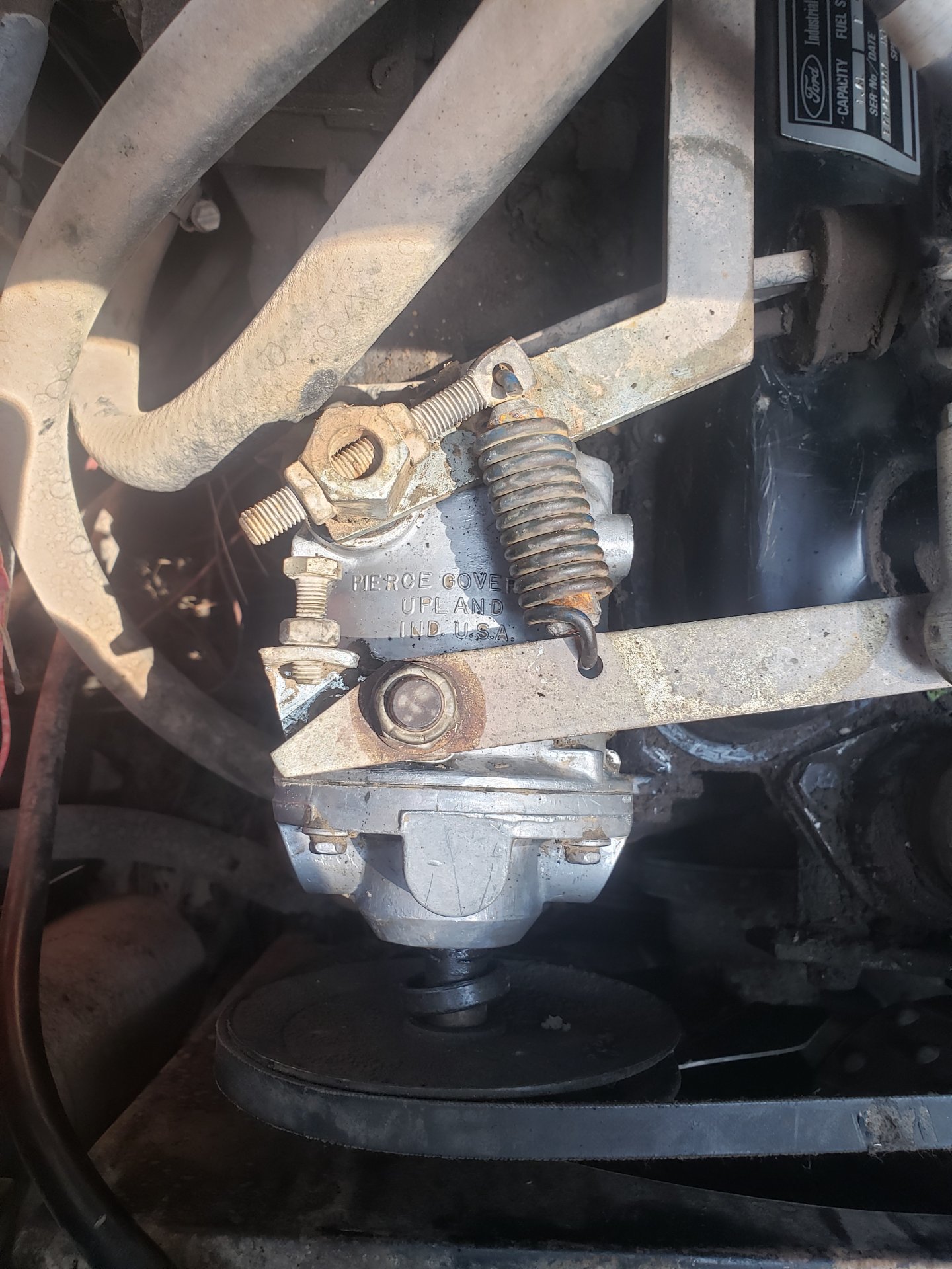

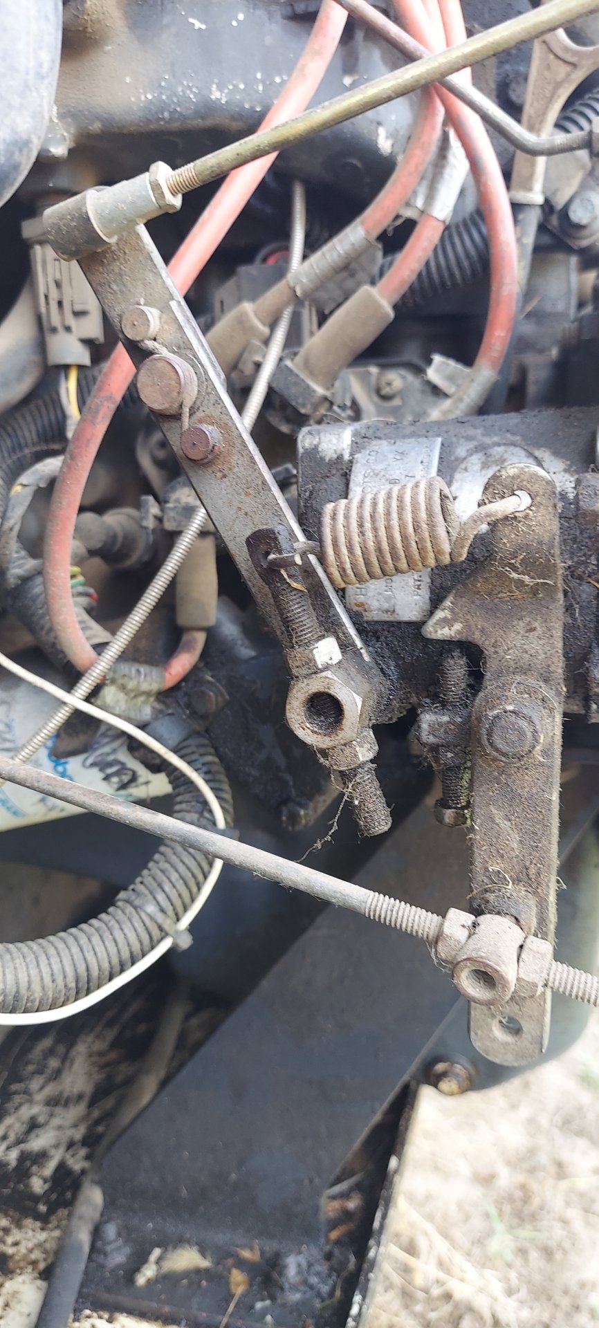

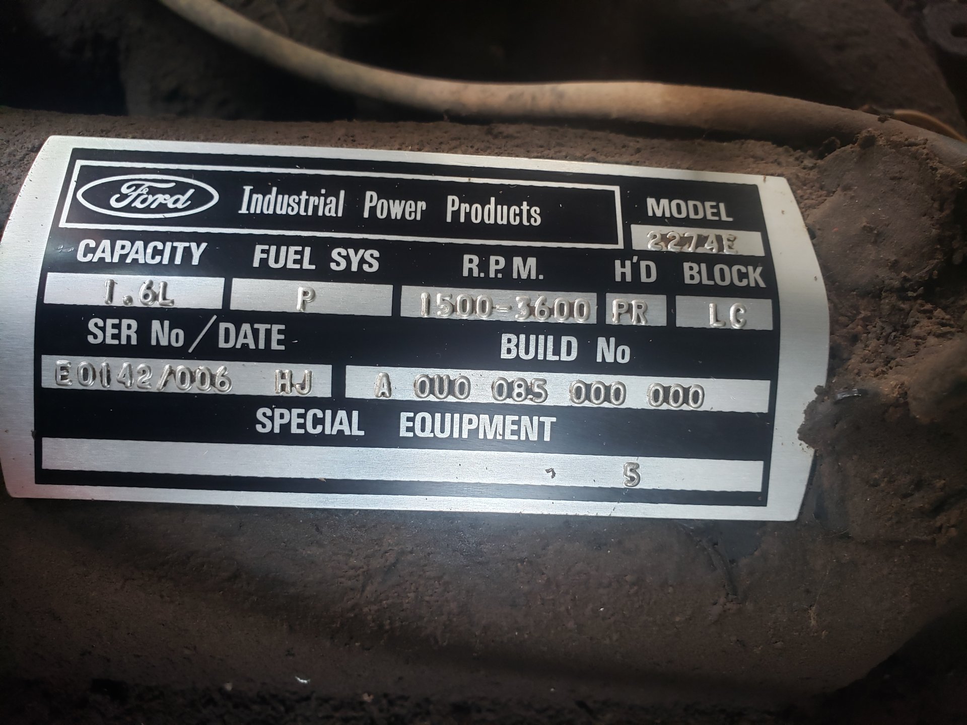

I just got to the location where my skidloader is. There are 2 tags on top of the valve cover. I'll attach those and also a pic of the governor. Maybe with these someone can tell me what year it is (92?) Size etc. Also what model and such the governor is???
Below are pictures of my governor and the Pierce/Hoof product guide.
Mine is listed on page 3 Part # BD 939D.
Yours is listed on page 4 and could be Part # BD 772, IF it is variable speed.
Part number BD 947 if it is constant speed. However I cannot say for sure what yours is with the information I have.
You will see only 2 are listed for the 1.6 and there are many listed for the 1.1.
Fortunately I was able to clean mine off and find stamped numbers on mine, perhaps with closer inspection you can do the same.
Mine is a Hoof and your photo is oriented 90% to mine I believe. Yours is a pierce so it may not be stamped.
You can see by my photos where the stamping is located from the shiny spot behind the spring..
I am giving you all the information I was able to find...Good luck.
