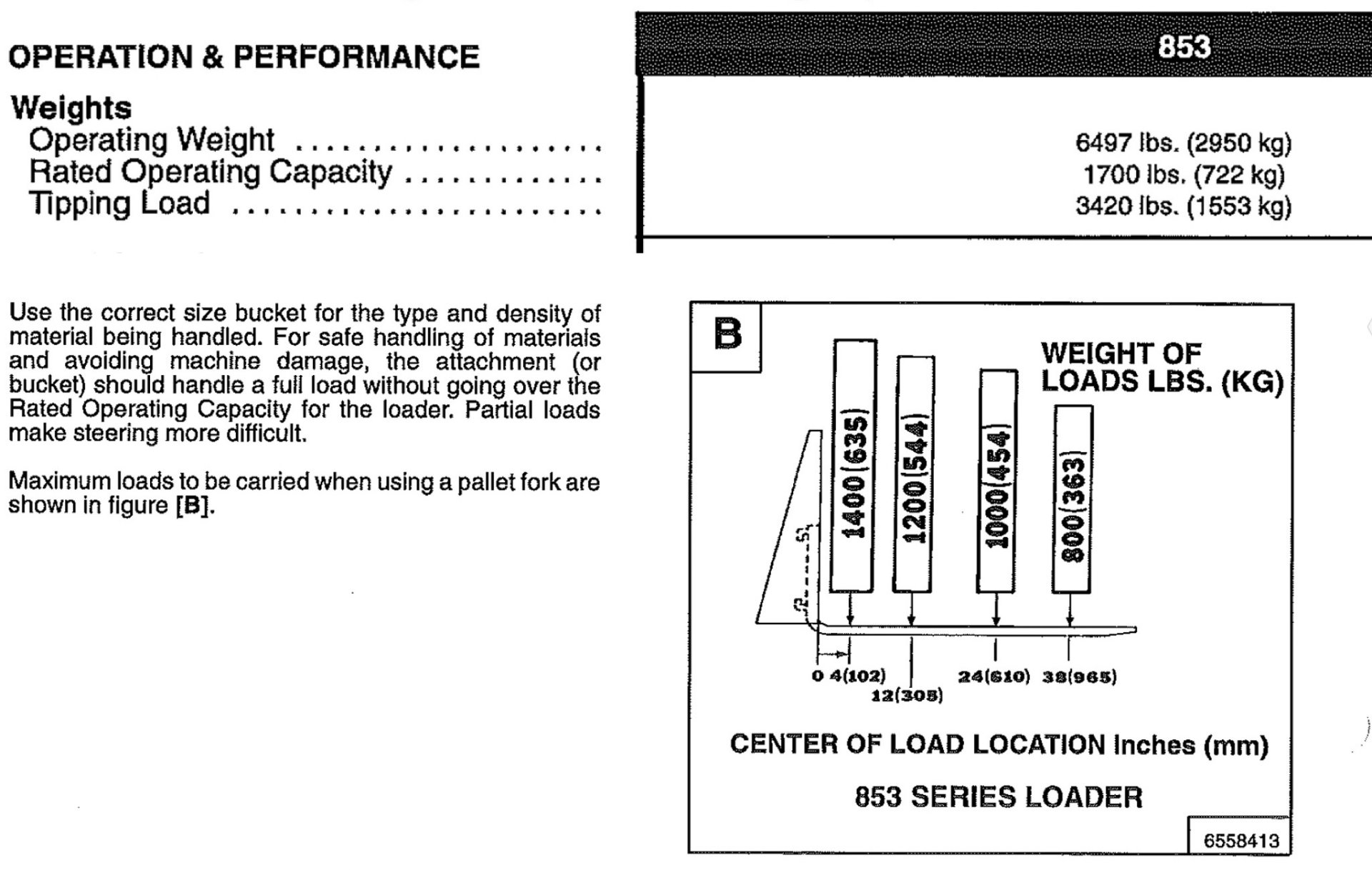

For whatever machine you end up with, check the operators manual. My 853, rated for 1700 lbs, has the below graphic for pallet forks.
