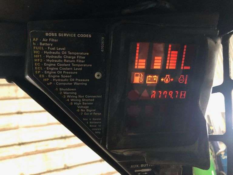

the fuse blows immediately, all others are good. The fuse is labeled BOSS but i dont believe this machine has the boss system. Ill have to take some time and look at the schematic.
If you have this display in upper right cab, you have BOSS.
Fuse blows instantly, sounds like dead short like you hinted.
    55.9 KB
Thanks for the clarification. I do not have that display. I wonder why that fuse is Labeled BOSS. Oh well, i will have time to look into it further this weekend. Should be a good oppurtunity to do some deep cleaning while im at it. Amazing how much straw, dirt, and other junk is packed into my machine. I bought it from an old farmer that bought it new and i dont think it ever once was washed.
