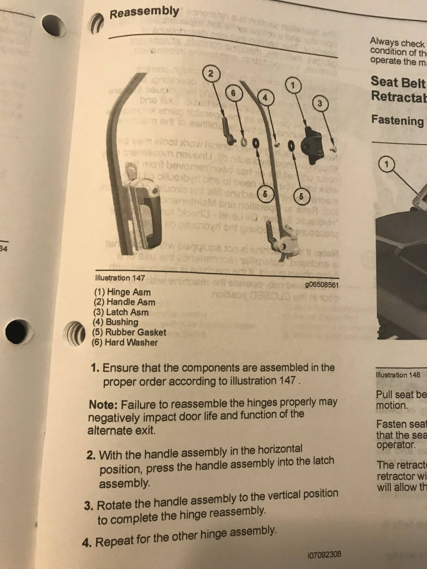

I see this is old and you have not been here for a while. If you are still having issues I can send you a pic of the exploded view of the door release. My book says it can be put back together.

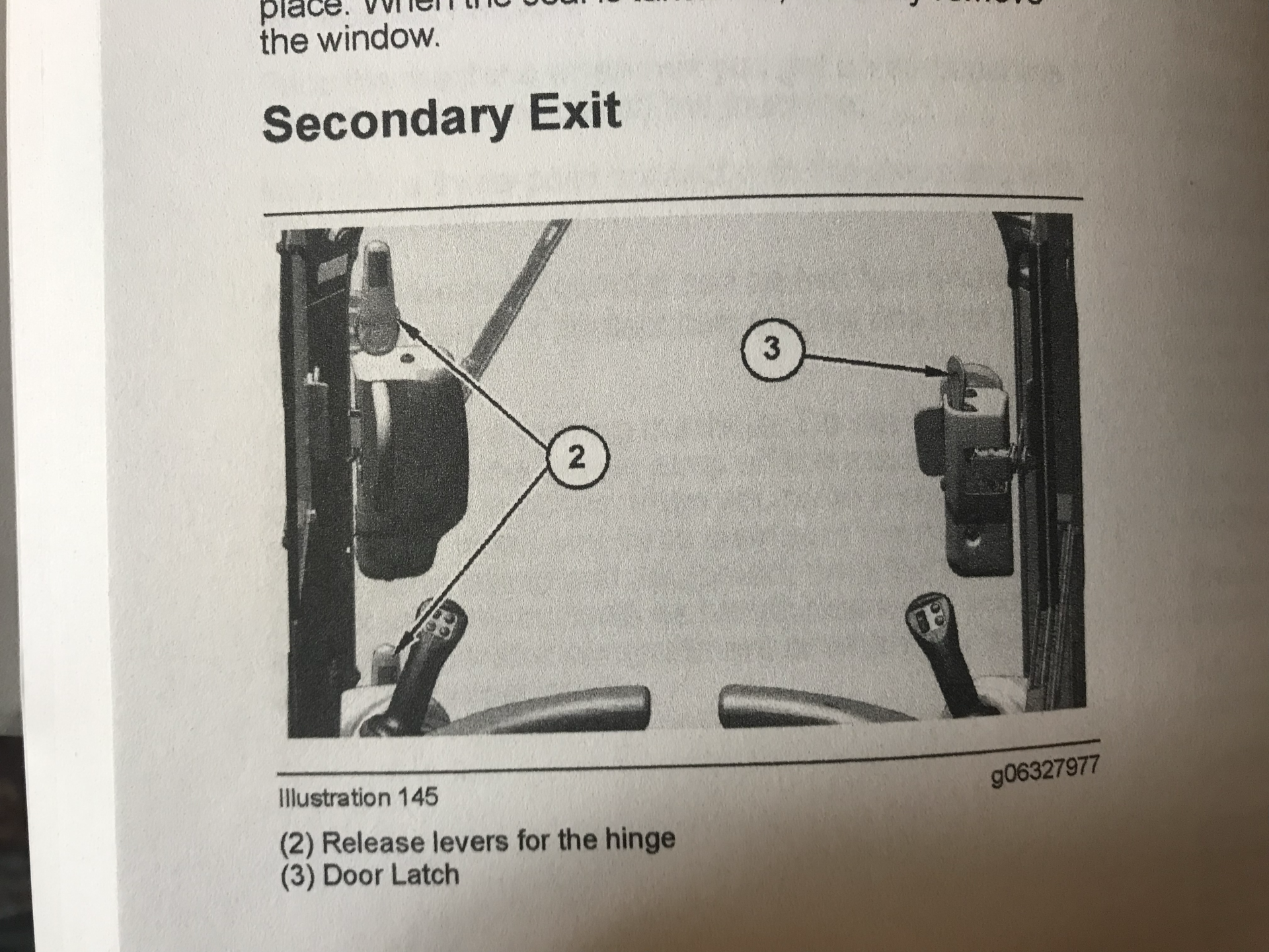

Hey would you be able to send this to me please?
This is what I have in my owner's manual.
Hope this helps.
Steve
They can be put back together but what happens is when the handle is released the parts go flying, good luck finding them. The main piece that goes thru the glass is $35 alone from a Cat dealer.
