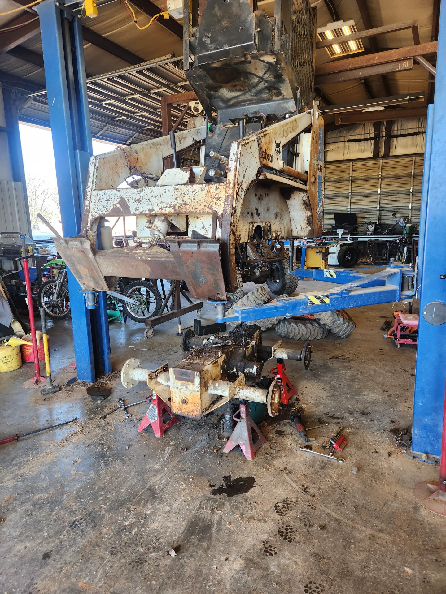

Thank you for posting this photo. It is great to see it done this way to get the Best access possible to the chain case. I had not considered the loader arm as a lift point until I see it chained down. Simple and brilliant, Thank you!
I was skeptical at first, it's tail heavy
