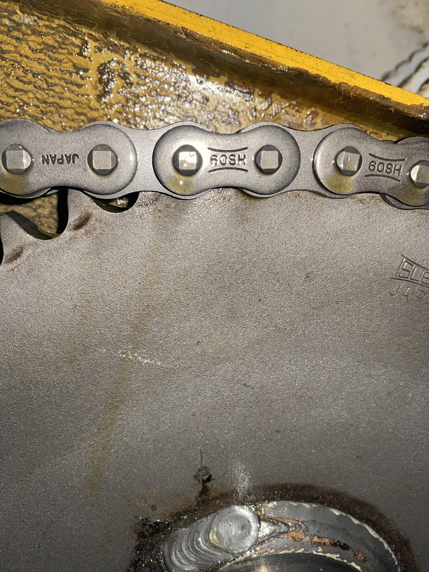

Along with the engine work, my 632 also needs an axle bearing and the chains have way too much slop. The side plate on the chain is stamped HS09, can anyone tell me if this crosses over to an 80 or 90 chain or where I can can get a bulk 20 ft of it?

It looks like the sprocket is marked Tsubaki & the chain has Japan on the link. I Googled Tsubaki 60SH & found some info from another manufacturer.

When I replaced mine in my old Bobcat I just took my old chain to my local implement dealer, and they gave me what I needed from right off the shelf.
