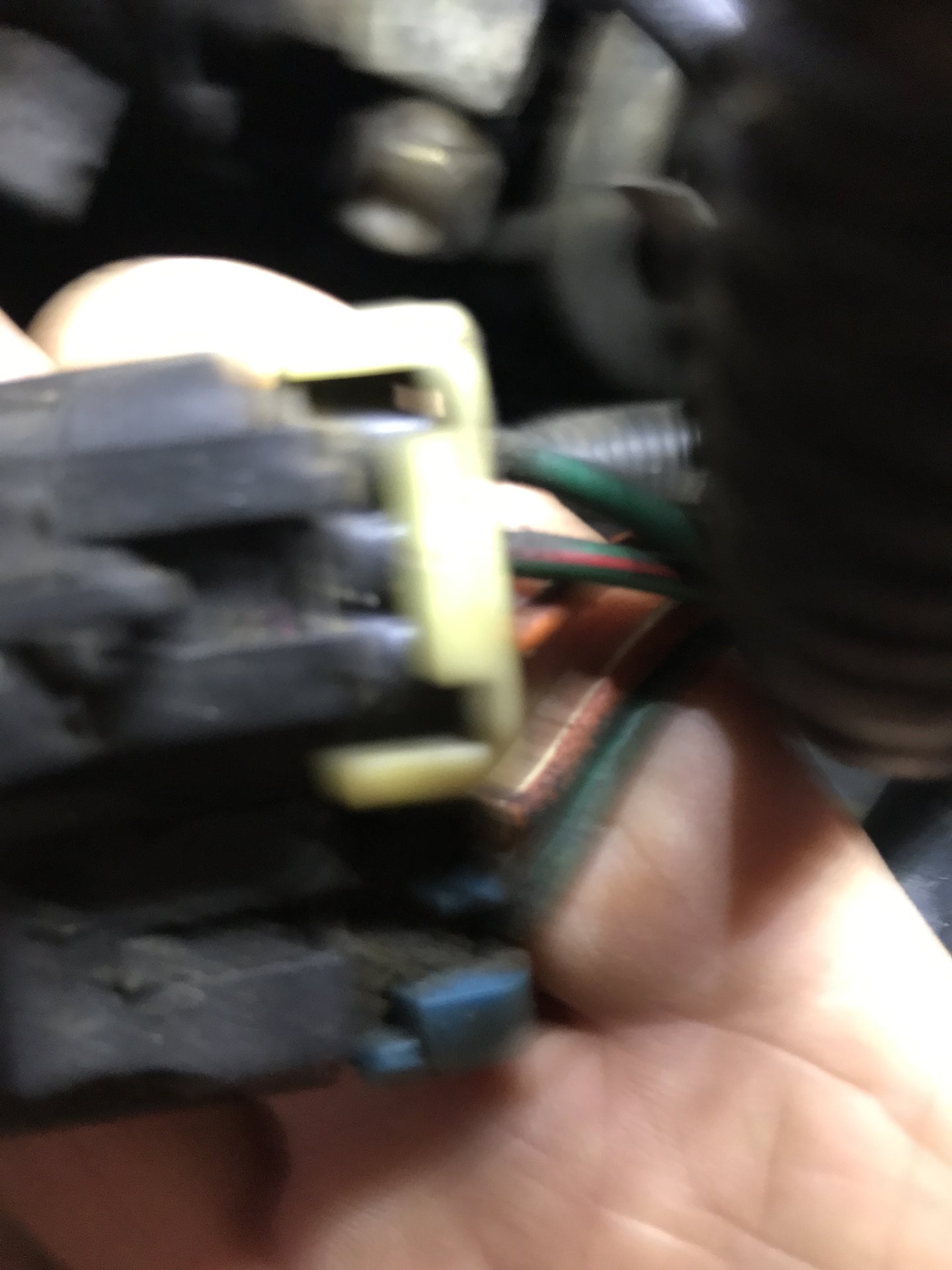

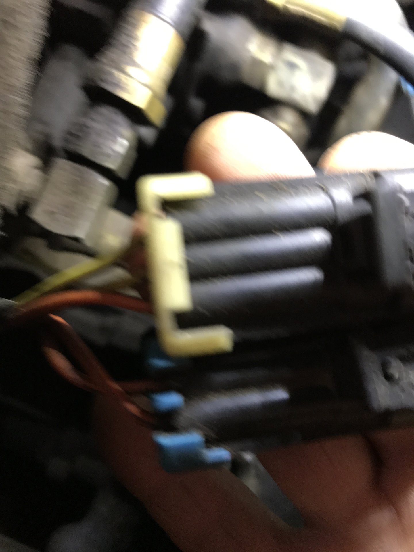

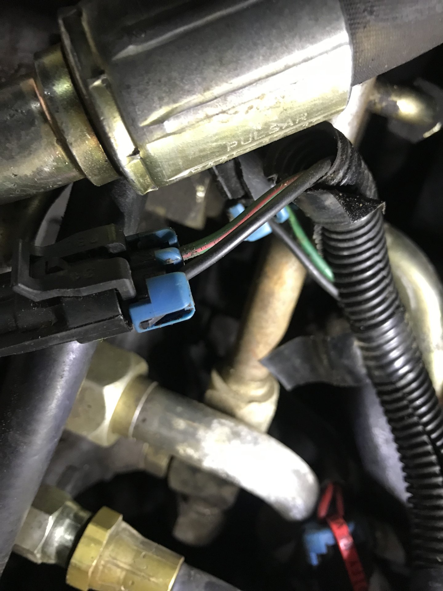

I have a 773C model that I could take pictures if you want. They probably have the same wiring schematics.
That would be cool. Do you have the right side joy stick that has a trigger and 1 switch you can move left and right?
I left the cab up so if you need more pictures, let me know.

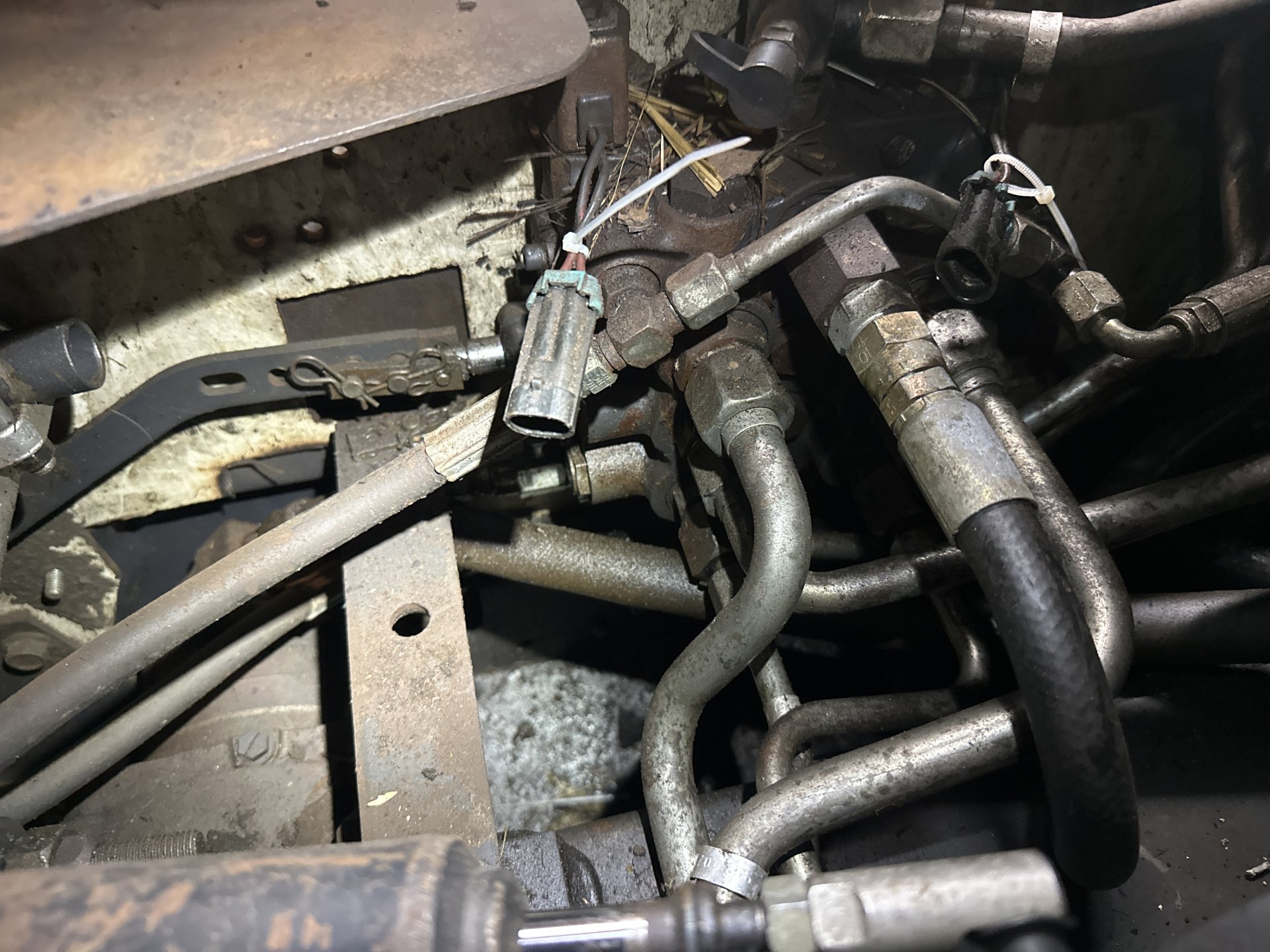

Thank you kindly for taking the time to help me out. Where do the wires on the machine side land? I only have 2x 2-wire solenoids that I can see and are right on top
    431.2 KB
those are the wires for your solenoids . I think that's What they are called. I took a couple of pictures . Just give me a minute so I can download them. Those wires hook up to a black and a green wire. One of the green wire has a red stripe on it and the other solenoid has a black and green also but I couldn't say what color the stripe.

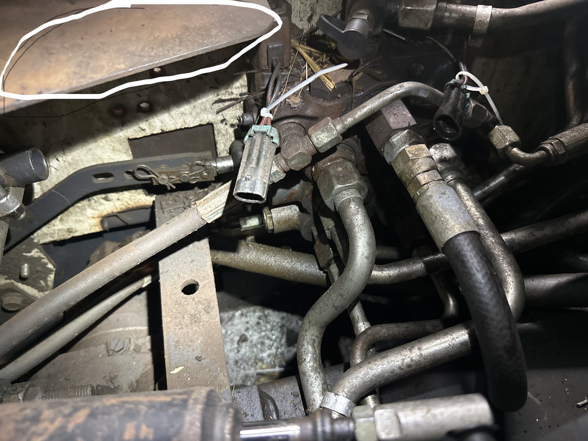

I'm trying to send you the wiring section of my maintenance manual. Not sure if you have this. You'll see on the upper right corner of the wiring diagram where the 2 solenoids are the wires go from them and splice into the joysticks and onto the control module
Do you know where the Control module is? I circled a plate on your picture. The control module is on the opposite side of the machine. Identical plate. The control module is mounted underneath it.
