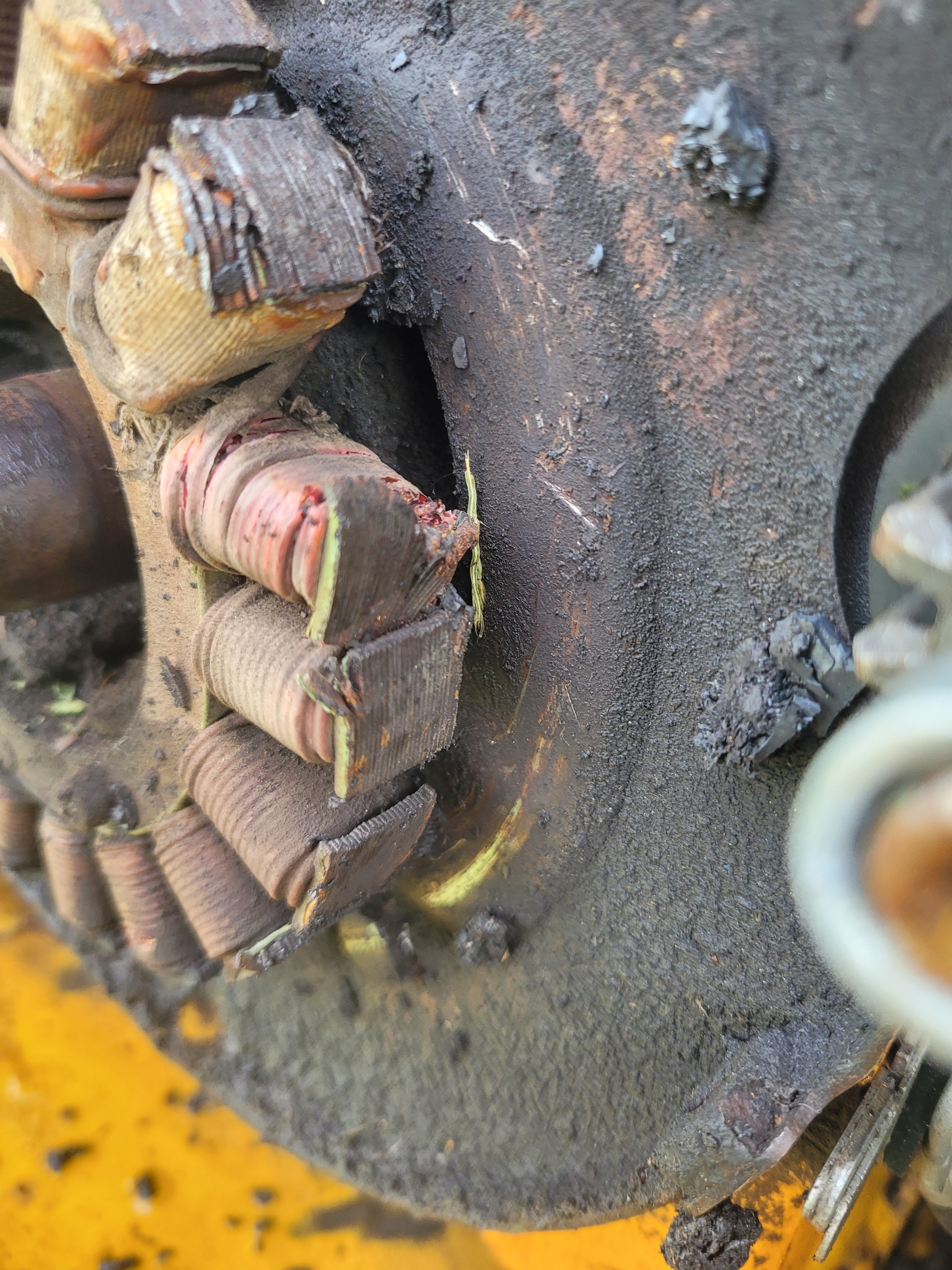

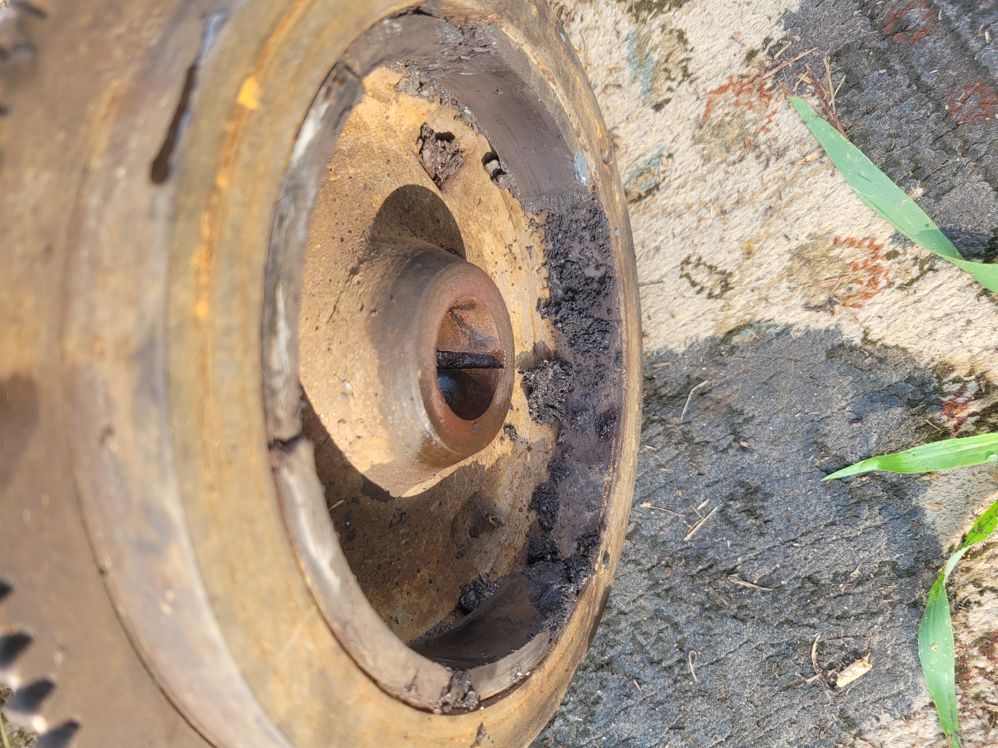

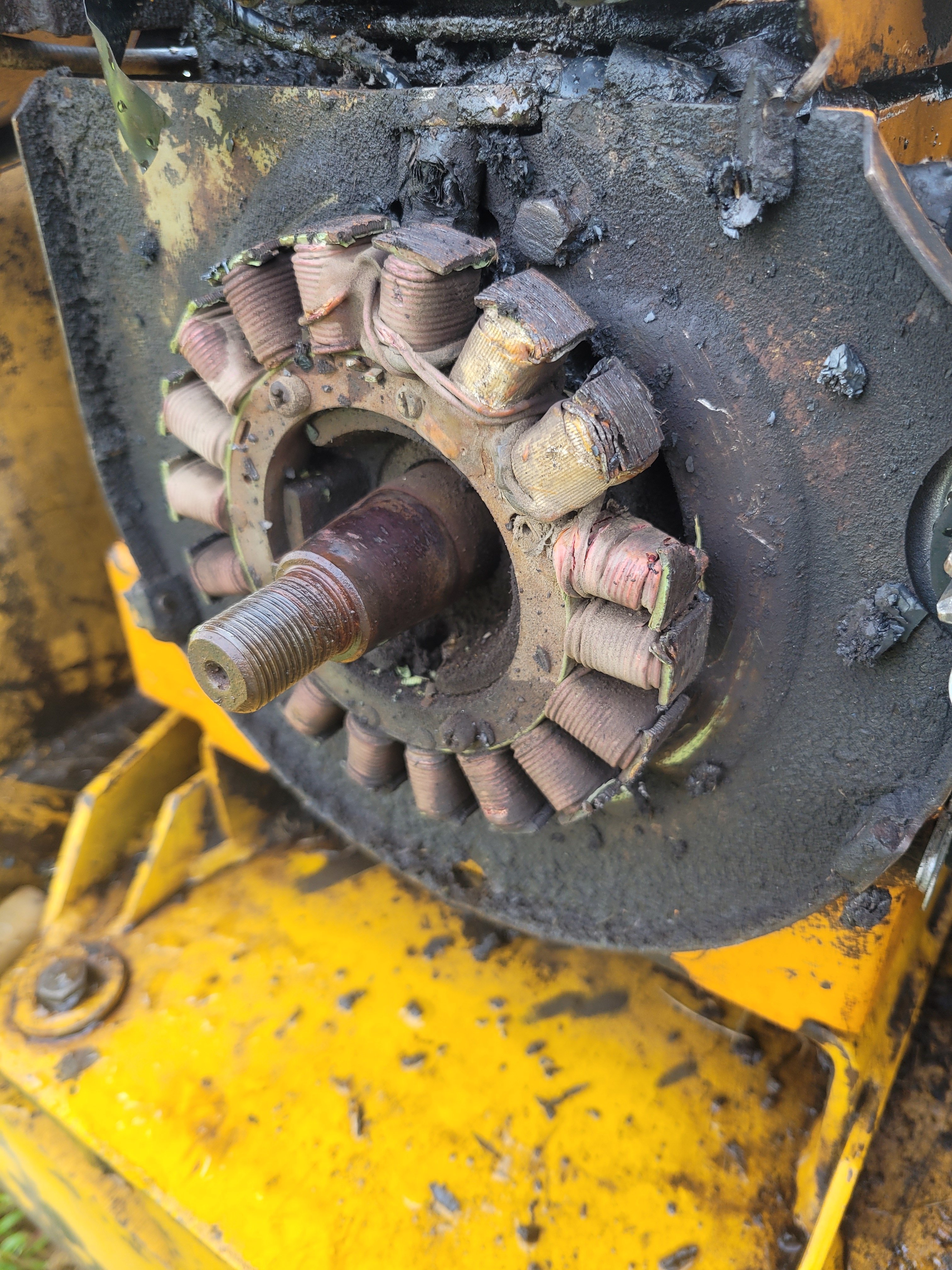

foton
Mar 1, 2018
675
if I am not mistaken that is your alternator coils on the side of the block , there should be magnets I think that were glued to the inside of the flywheel. I think there are triggers on the outside of the flywheel that trip the ingition coil. well that was how it was on my 12 hp.
