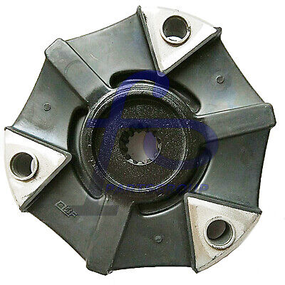

The coupler on the 1835B is all generic components. I would look to see if there is any identification on the old parts and see if you can find them that way. I know some of the 'B parts were made by Neapco.
or
says it fits yours but not sure if its the correct part
maybe?

that appears to be the one for the pump that drives the wheels, not the one for pump that runs the loader
Is it just a splined coupling? If so there are tons of them there. You should be able to measure the shafts and count the splines then find one that matches the spline type. What is the Case part number?

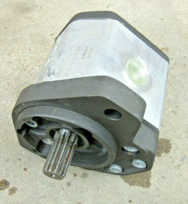

Vanderhaags has a used pump on ebay but the splines look well used.
However, If both are bad just you should be able to get pretty much any 16gpm pump and a coupler that matches that pump. there are tons of pumps and couplers on ebay,amazon and alliexpress. the newer couplers are mostly neoprene with metal inserts. There are the kind like yours (metal) but that have 6 mounting holes of which you would only need to use 3.
examples
not saying either of these will fit up in your system but just saying there are options other than the originals if you cant find them anywhere.

what are the odds that the holes will line up?
I think there is a good chance but I would order from amazon that way if it dosent its a painless return. The pump I showed you is about 1gpm less than what was stock so see if you can find a bit larger one. Stock is 16.8gpm I think and that one is 15.5 or something. You could probably go up a bit if you want but I dont see the need to stress out an older skid steer if you dont need to.
