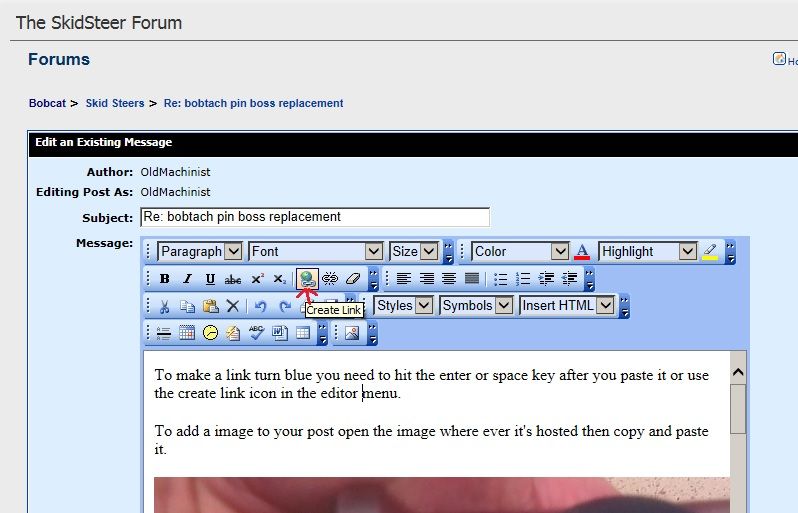

To make a link turn blue you need to hit the enter or space key after you paste it or use the create link icon in the editor menu.
To add a image to your post open the image where ever it's hosted then copy and paste it to your post.
If you don't have the menu go to your forum profile and scroll all the way to the bottom. Check the box for "Use HTML editor". Then click update user information.
